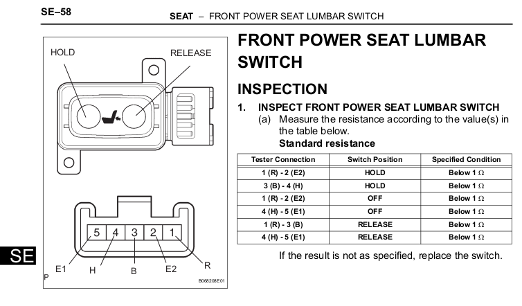

Lumbar support seems to be inoperative.

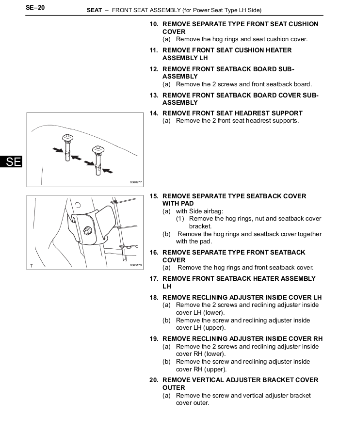

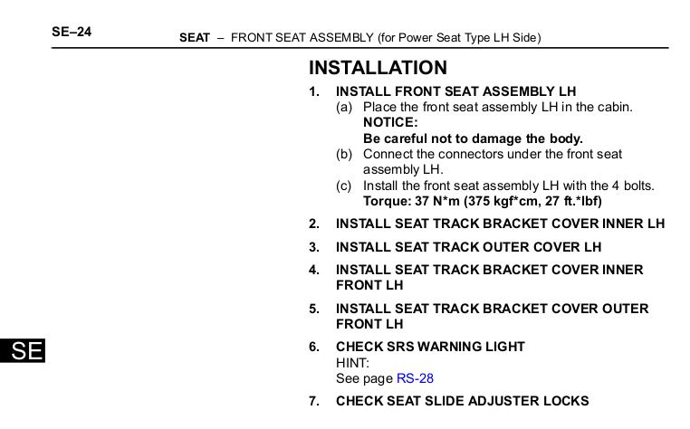

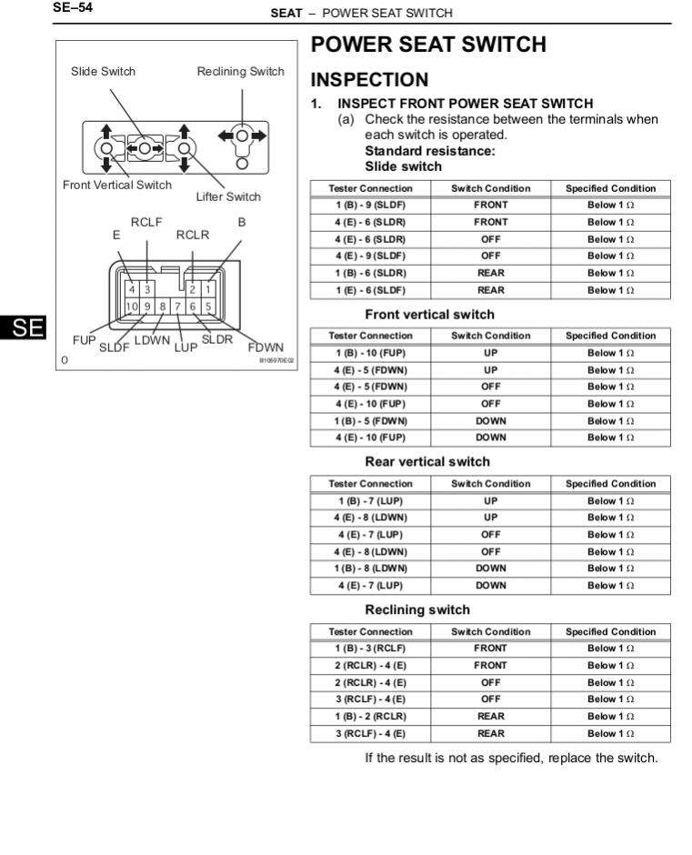

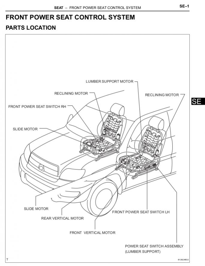

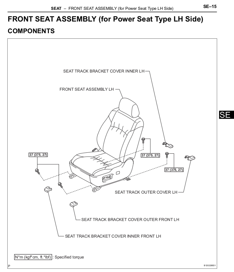

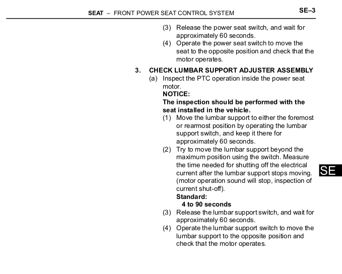

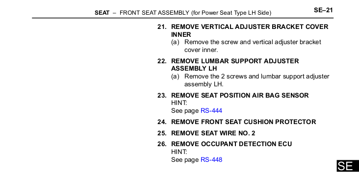

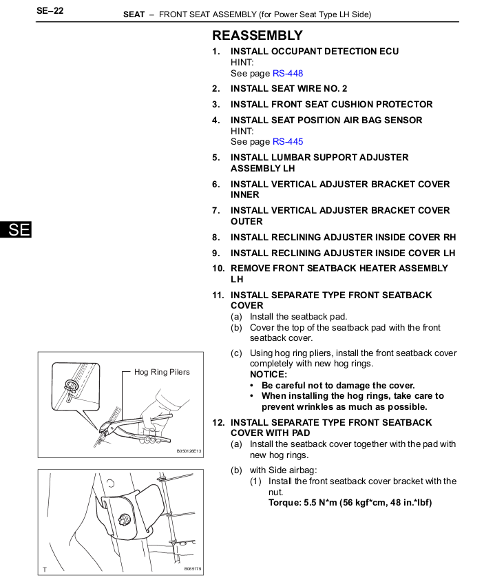

BTW, Anyone know where to get the assembly info on a drivers seat?
assembly drawing? parts list? part numbers? What ever you have?

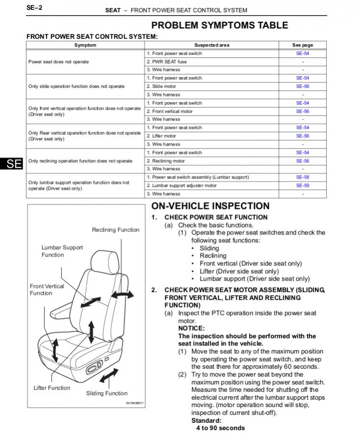

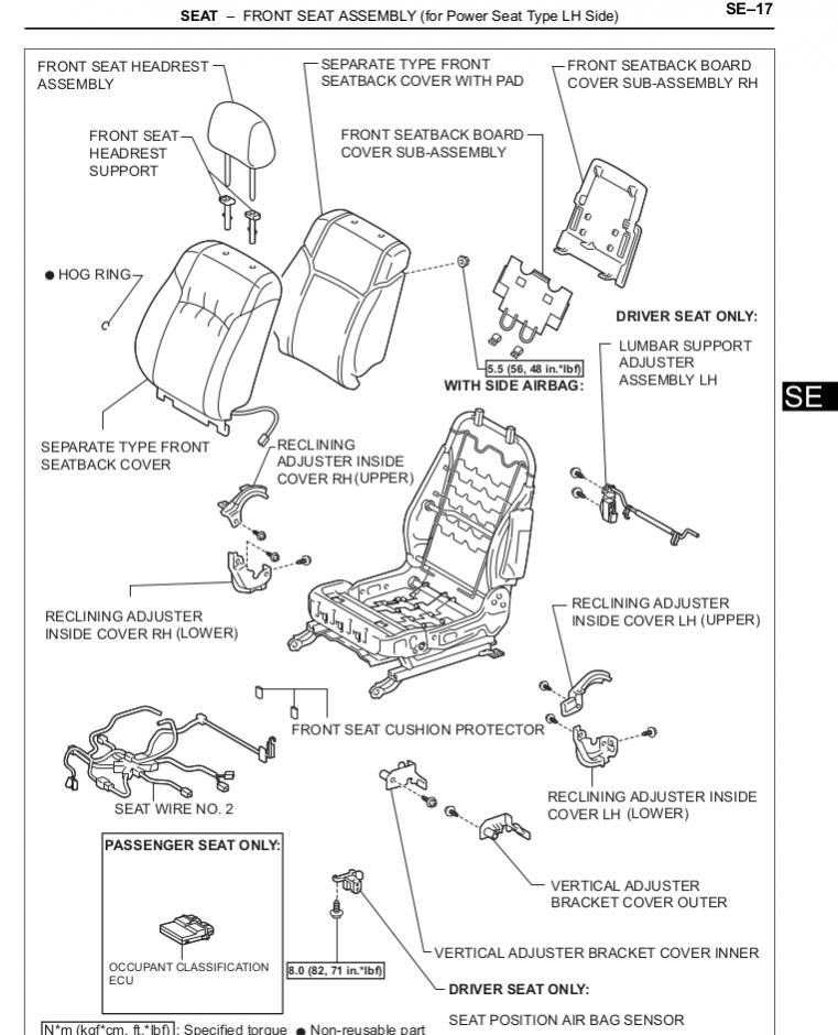

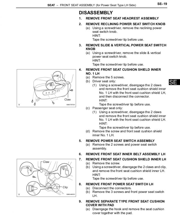

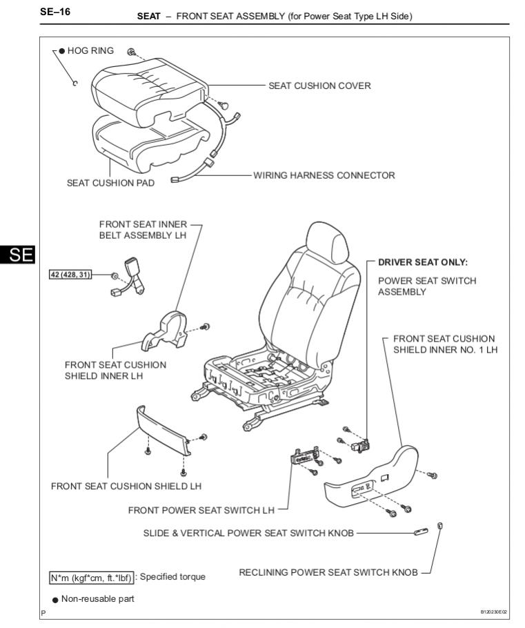

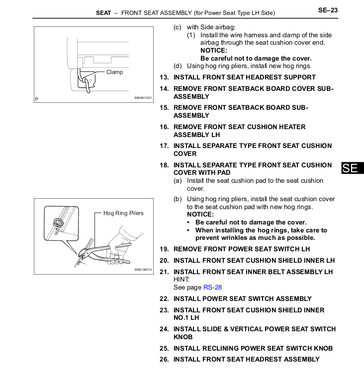

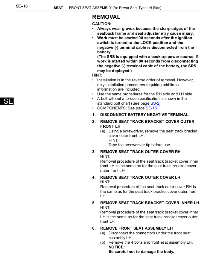

Here is what I have for my 2006 in case it helps:
(part1)

Hope this is of some help.
