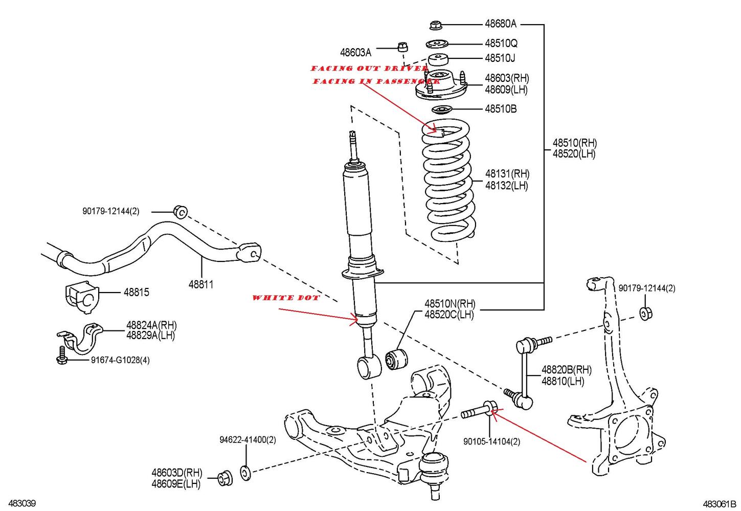

I just added some Fat Bob spacers to level my T4R
I'm a little OCD so this is a triple check and I was juggling two jobs yesterday.
Some may know and some may have a look.
Three questions.
1.
Top of spring pointing out on Drivers side and pointing in on Pass side ( My tundra is this way) Is your stock set up this way ?
2.
If so, then the white dots on the lower shock are facing front. Is your stock setup this way ?
3.
Lower Shock bolts, mine stock were pass side nut facing front and drivers facing rear unlike the pic. Is your stock setup this way ?

Mine is a TE and and bot lower shock bolts run from rear to front on both sides.
LCA bolts run front to rear.
White dot faces forward on only one spring.

Thanks, top of the spring were it is cut off points out only on one side? ( You should only be able to see it on one side, the other will be at 180° facing the engine.

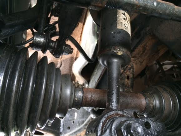

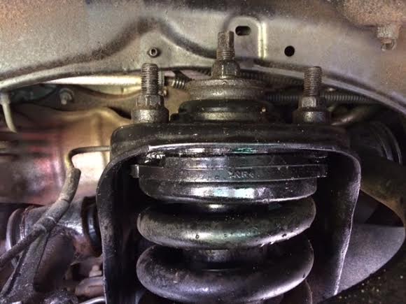

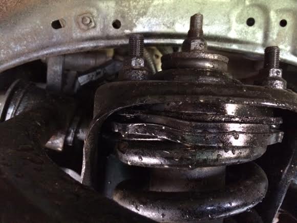

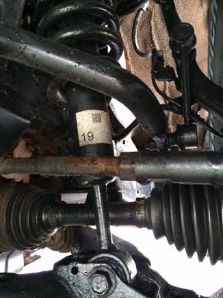

It has stopped raining long enough to take some pics, they may prevent any more hurt feelings. .
You'll see the decals on the shocks are facing the same direction, one would think the passenger side would face the tire as well. Truck feels fine and I'm sure it doesn't matter.
For what it's worth I went with two different thicknesses of spacers to take the lean out of the truck.
