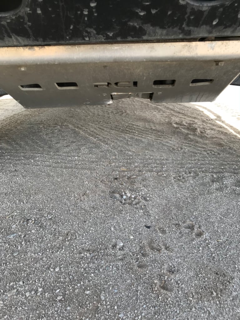

Thanks, will be trying the LCA bolts tonight. I also suspect the skid plates as well. Had to use spacers to get them to fit underneath part of the exhaust (RCI) and I'm sure there is some loss of rigidity from that. I also slammed my front skid badly coming off a ledge on this trip. I essentially don't have an oil filter access door anymore :hatsoff:

I put her up on the lift this weekend and went through my list of diagnostic tests. After watching numerous failing ball joint videos and hearing the sounds and symptoms I was sure it was them! So I did the vertical and horizontal wheel wiggle. Everything was tight but the driver side tie rod end was leaking grease (still tight though).
Next up was my front RCI skid plate. Apparently, when I came off a shelf in the Mojave and slammed into a large rock I bent 3 out of the 4 mounting bolts. It also obliterated my oil filter access door. Replaced the bent bolts and threw the plate back on. No noise at all now.
My nightmares of failing ball joints and wheels flying off were for nothing :P. Thanks for all the help guys!
