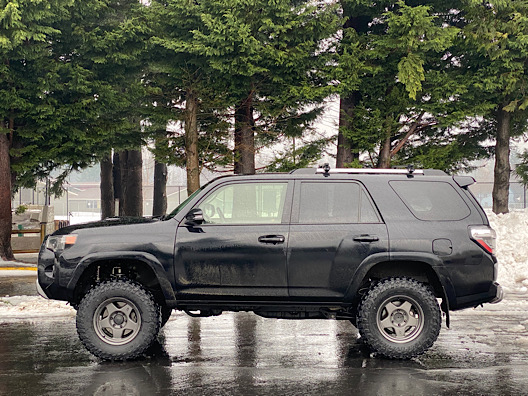

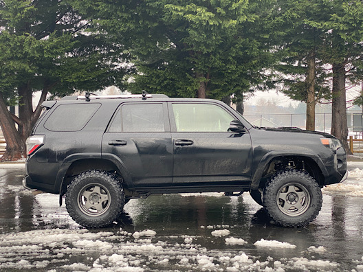

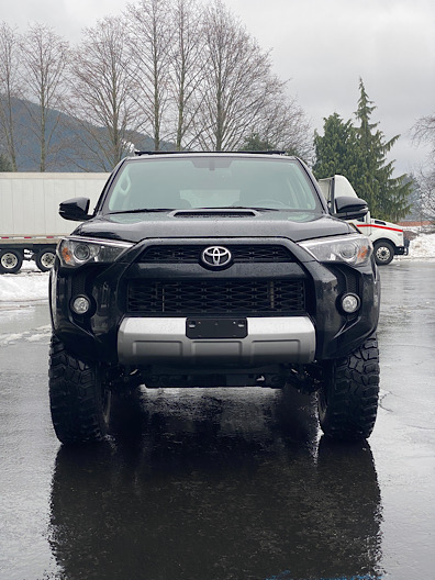

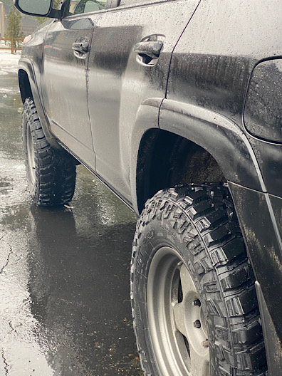

Here are the side profiles. It feels like it just has to settle a bit but I could be wrong

I have the same setup from Accutune, and yes it will settle after 500 miles or so. From your pictures it looks like it’ll settle evenly.
