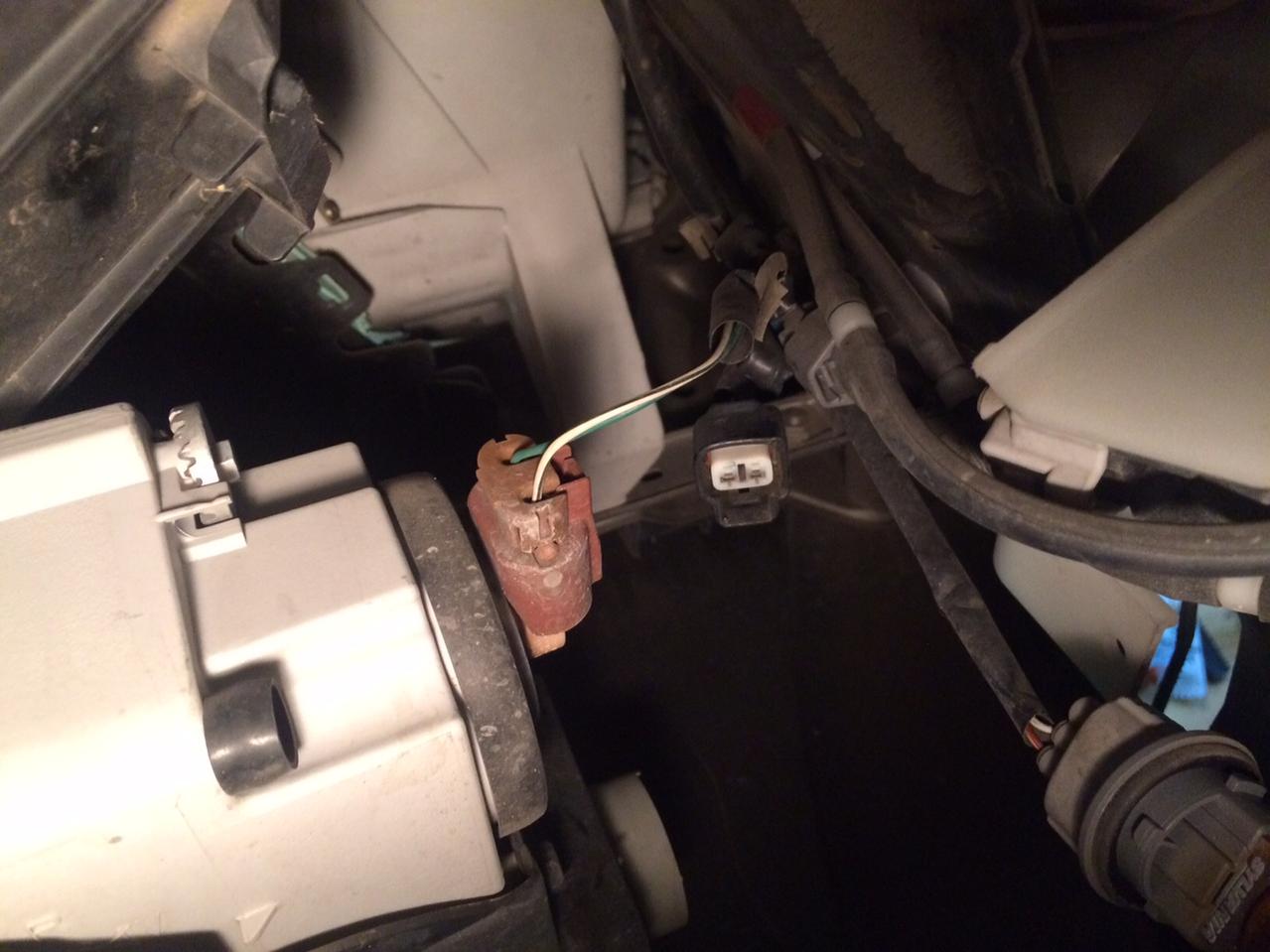

Unconnected connector found when replacing ts bulb
I am new to this forum, and am the second owner of my wonderful 2003 V6 4R, and doing my own maintenance for the first time.
While replacing my front passenger side turn signal bulb today, I noticed a connector hanging down nearby which looks to be unconnected from 'who knows what'.
Maybe someone here knows where this stray connector should be connected and to what system?
The attached pic is taken looking up from my garage floor. The red connector in the center of pic is my runninglight/ts area and the white connector just to the right is the connector in question. Did this disconnect from something I cannot see? I cannot imagine that it is just supposed to be open, and unconnected hanging in that manner.
Any help is appreciated!
