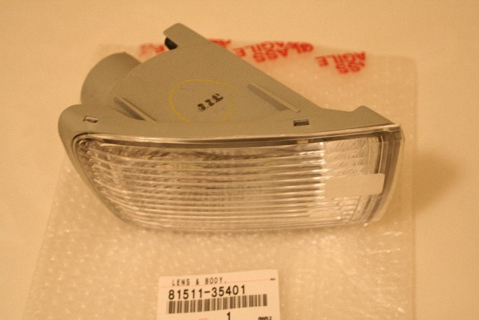

Here is the new lens & body assembly (part # 81511-35401.)

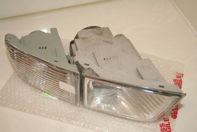

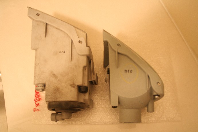

Top view with the 2 housings side by side. Notice the tab connector between them.

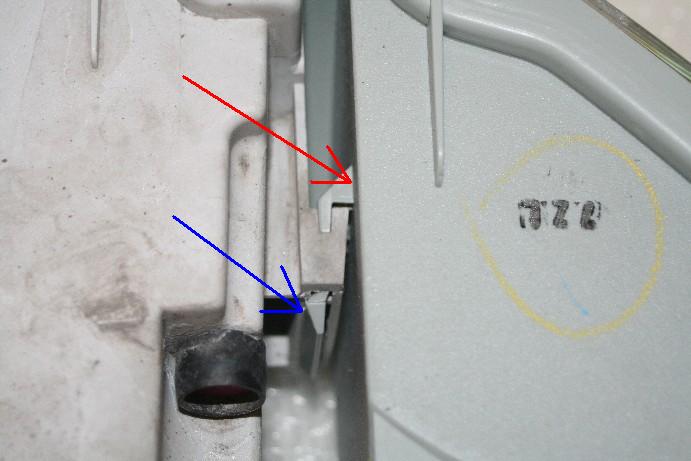

Close up pic of the tab after sliding them together.
To disassemble these you have to pry the tab open with a screwdriver at the blue arrow to slide them apart. Be careful because you can easily crack the tab off the turn signal housing at the red arrow (I cracked it on the old one but I didn't care because the housing was junk anyway.)

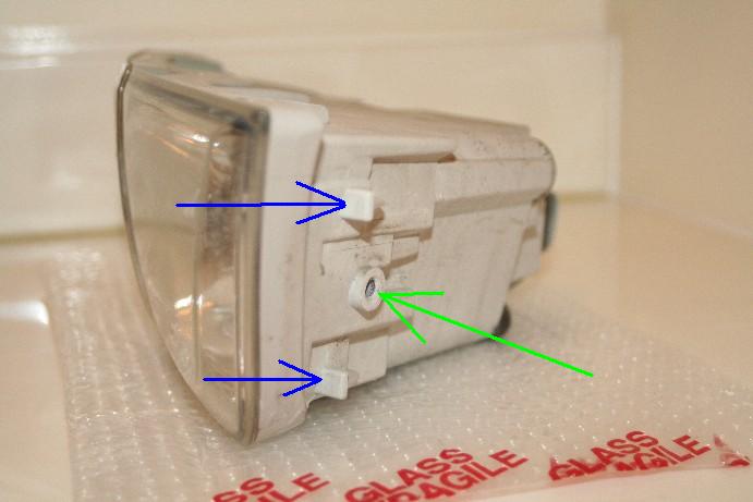

Side shot of the fog light housing. The blue arrows point to the tabs that interlock in the bumper holes and green arrow is the screw hole (see later pic.)

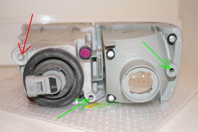

Rear shot. Again, green arrows point to the screw holes.
(Not related to this replacement, but I thought I would point out the fog light aim adjustment screw at the red arrow.)

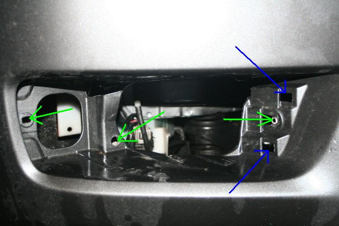

The bumper cavity showing the interlocking tab hole locations (blue arrows) and the screw hole locations (green arrows.) Just slide the combined unit back into the hole and push in on the fog light edge to click the tabs back into place. Then install the 3 screws. Be careful not to overtighten these because they are just cutting threads into the plastic housing and strip very easy (I found out the hard way the last time I did this.)

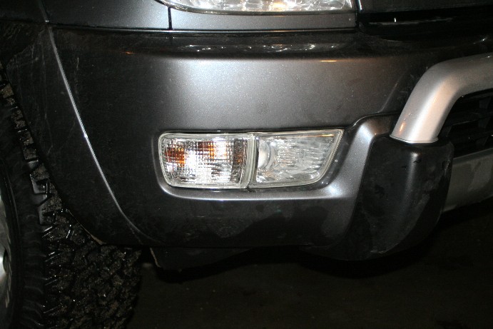

Finally, here is my blatant post-whore shot of the finished replacement.
