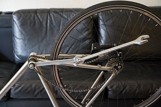

Not much room in there but you should beable to slide a wrench over the 14mm with the box end to get more leverage. Ive done this many times and never had an issue getting that bolt out. Unless you have rust issues.
