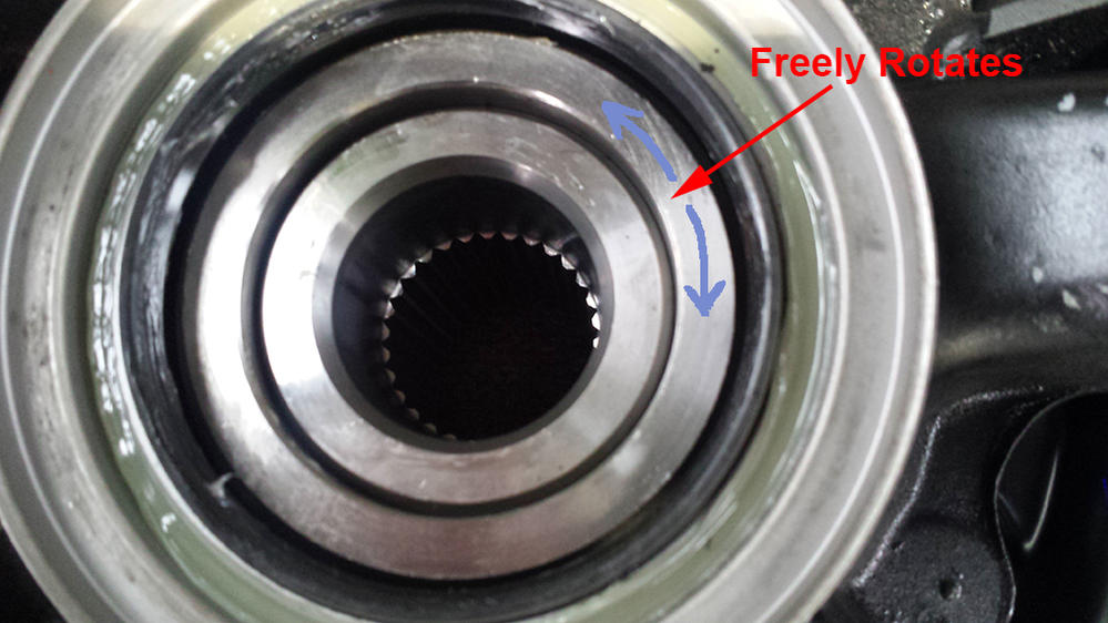

Quick question for [MENTION=101060]Spunk[/MENTION]. Did you have any "Play" between the spacer and the main bearing after it was pressed in or did it fit snugly against the bearing?
EDIT: Just to clarify the question with a picture. It just seemed unusual to have the spacer freely rotate around the hub once it was "pressed" on. When it came off it didn't freely rotate. I think once the axle is torqued down the movement will go away.
BTW - nice write up. I didn't need to use a sawzawl to press it apart but you did a nice job documenting your work.

Yup! That free spins with play.
Wow! Thanks for the expedient response! I'm glad this wasn't a life or death situation! Almost forgot I asked you this question. :biggrin2:
Everything is all back together and in fact, I started installing everything on my rig yesterday. Thanks again!!
