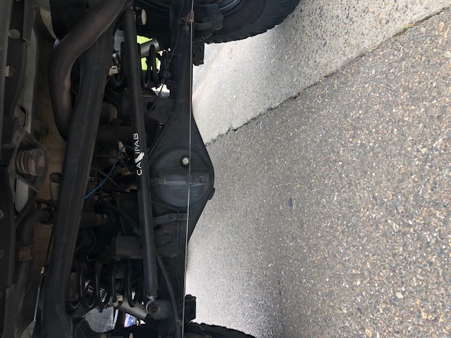

Is this something I need? My previous builds were leaf sprung. Just bought this built 3rd gen.
Sorry about the side ways photo.

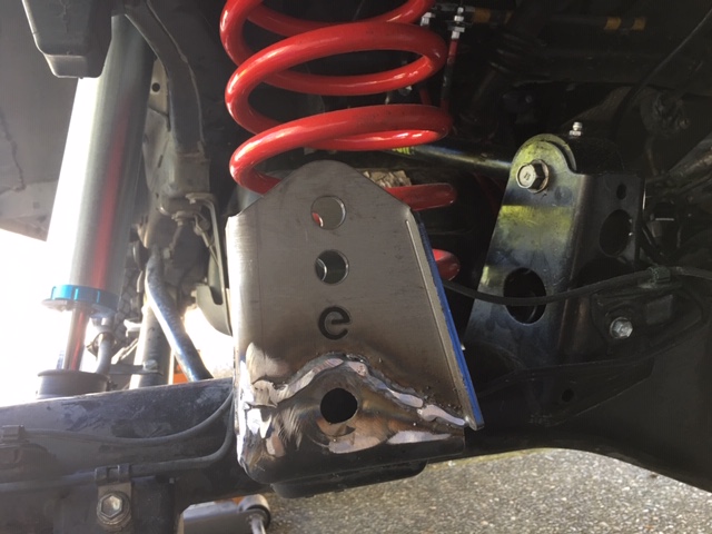

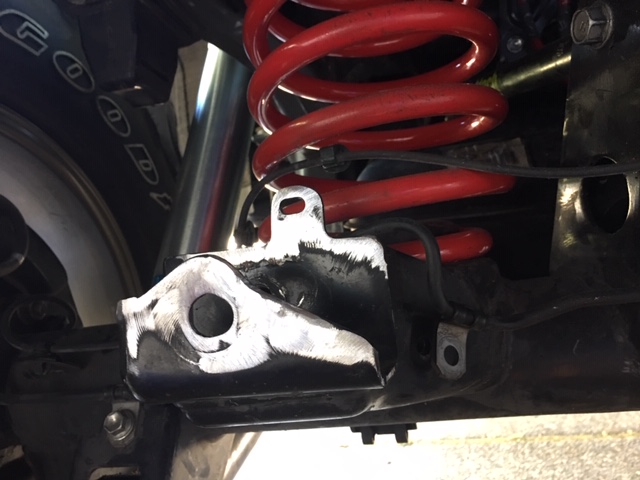

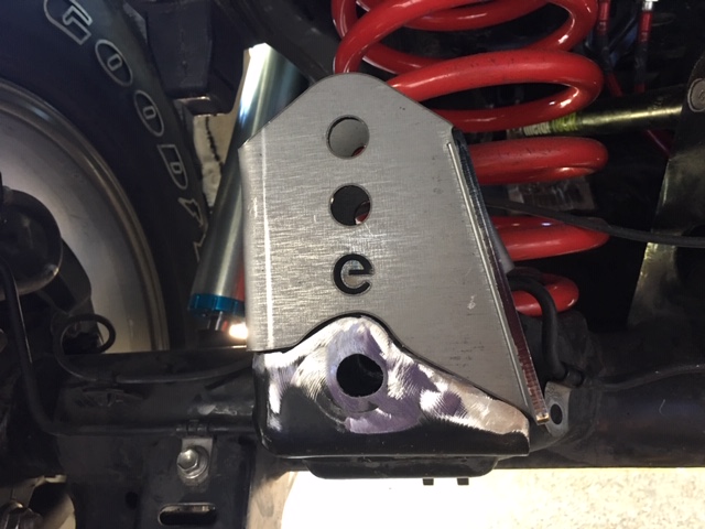

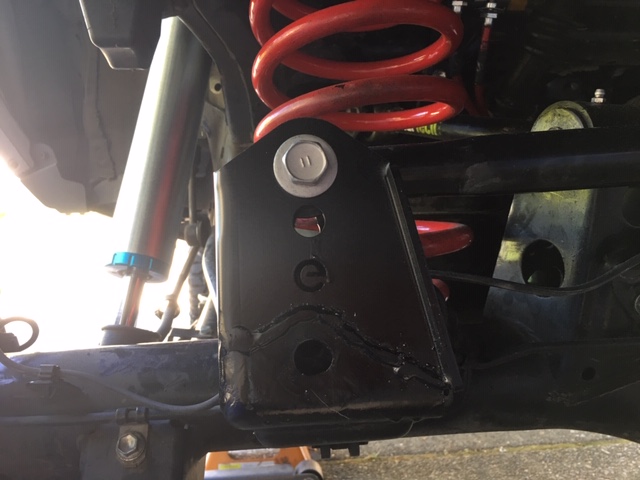

I received my bracket today and immediately welded it in on my 2018 ORP today. Wow amazing the difference a simple part can make. It feels more stable over bumps at high speed and just drives generally better. Thanks for a great product that fit nicely
Not my best welding job but I didnt want to remove the springs and stuff. I did weld the back side but it was just not the prettiest since I had to weld in tight space with the coil still in place. Ground the welds flat a little bit and sprayed some black paint over it
