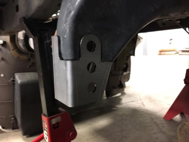

Here's what I have of how the frame side bracket is positioned prior to welding (I'd put the factory bolt in when welding so nothing moves on you)
That helps, so just use the bolt to hold it until you get a tap weld or two?

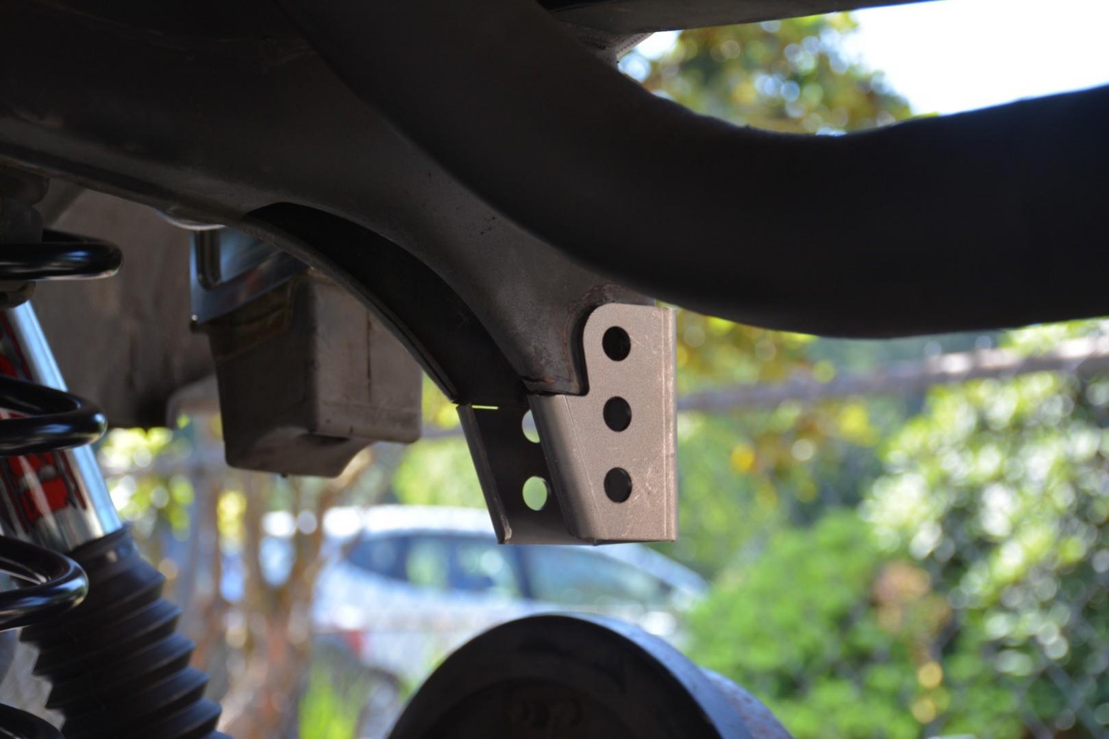

i went through the first half of this thread trying to look for other users setups and what hole they put the panhard bar on the frame side and surprisingly i didnt see anyone list their setup/lift. Mine is a 3" lift all around. almost flat, much better than what it was!
edit:hopefully you can tell but on the frame side i used the hole closest to the ground. it seems as if this setup is pretty much perfect for a 3" lift.
I can't tell from here, but is the frame end of the panhard lower than the axle end? (if so, I'd go up a hole for times when you're carrying weight)
its the angle of the picture. i went out three different times in one day and tried to get a good picture before just settling on this one. it is almost flat, just slightly higher on the frame side.
luckily i dont usually carry weight other than my spare tire in the 'trunk' and the occasional shooting/camping gear.
btw i see what you mean about having to mod the spacers for the middle hole. if i ever do that i will just end up buying a spare set of spacers to mod.
