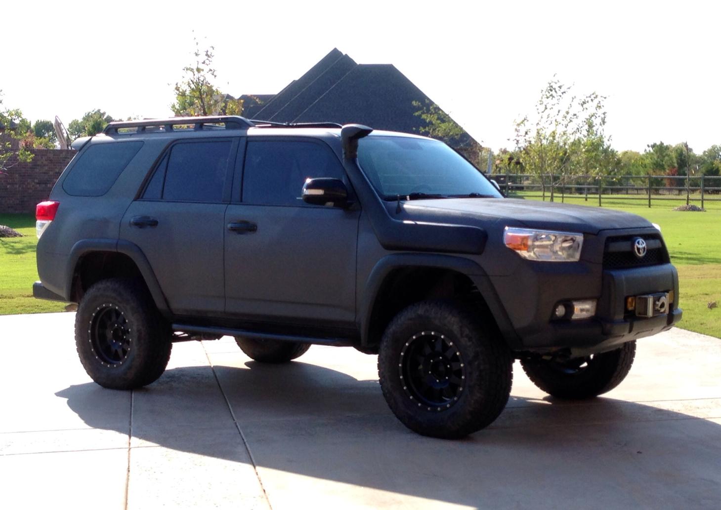

Got mine installed. It was easy and the snorkel looks great with a couple coats of Rustoleum satin black. Thanks for making this happen, Nathan!
***Edit: sealing was a little tricky with the "tunnel" inside the OEM airbox. I actually thought the TRD airbox and sleeve was easier when [MENTION=84479]Petromaniac[/MENTION] and I installed his.
