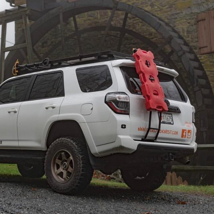

One is rotopax on the the Gobi ladder/ still deciding between 4 gallon or 2 3.5 gallon fuelpax.

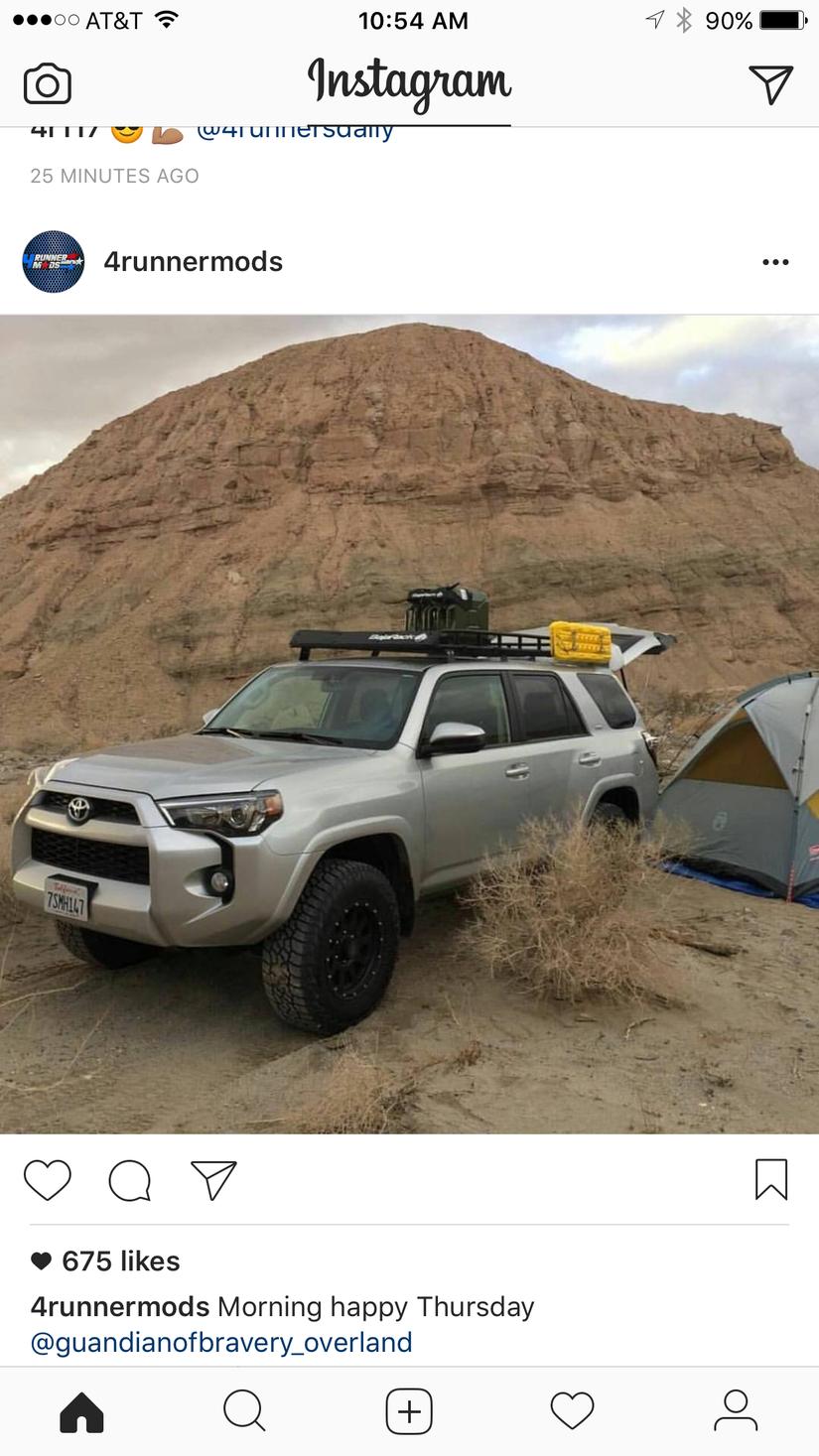

Two is 2 5 gal NATO jerry cans ratcheted on the roof similar to the picture below.
Concern with the first is opening the lift gate
The second is clearance/bulging from pressure.

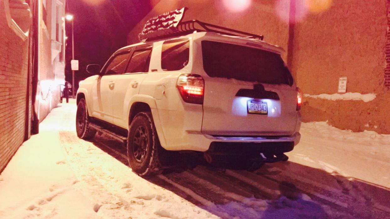

My basket/Gobi ladder not installed yet

I say Rotopax on the gobi ladder. Easy access and more aerodynamic than having the jerry cans on the basket for the road trip.
I despise the rotopax for anything other than water storage. They tend to balloon really bad as the gas heats up, and then they can seize on the mounts because they're so puffed up. Mine also weeped really bad, but thankfully we caught it in time before it could hurt the paint.

I use exclusively the older style NATO gas cans with the metal latch top...they're not CARB approved...but they don't leak either. They are a bit harder to find, but not impossible.
