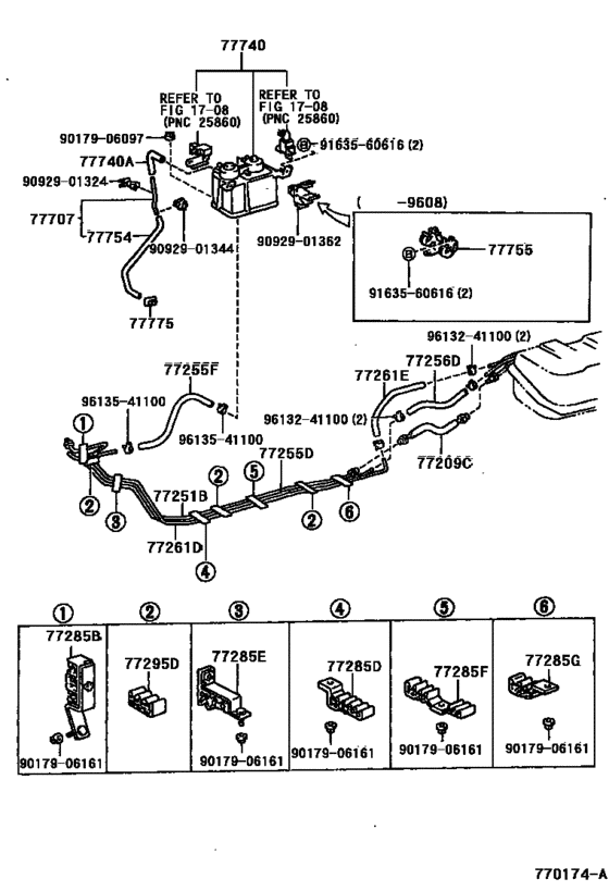

ok lets see who know their stuff.
Is it possible to buy a fuel grade hose for the three lines in the bottom left hand of this diagram. If so what is it called and where can I buy it
I know the part number for the pieces they are at the top of the post. Instead of just replacing it with a fix that will rust out in a few years im looking to see if there is a rubber tubing option.

I would not use rubber in place of steel lines for underneath the frame. Having seen it done, let's just say the end result was all wet down the road later in time. It won't pass inspection here in NC, don't know about Canada.
