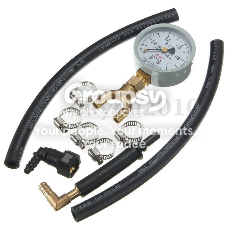

Solution 2 : I found someone on ebay selling a custom tester kit for $12.00. its super basic but it will do the trick.
This is the link to the ebay item:
Fuel Injection Pump Injector Tester Test Pressure Gauge Gasoline Cars Truck Tool | eBay
s-l1600444_zpsbappnoqc.jpg~original
basically what your looking for is a fuel pressure gauge for 7.89mm male to 7.89mm female quick connect. you can tell what size quick connects you need by looking at the female side of your fuel line quick connect. it has a number written on it....that's the size in millimeters. if you can]t find it then measure the outer diameter of the male metal fuel line. 5/16" = 7.89mm. do not confuse this with the rubber fuel hose, this is also 5/16" but that is the inner diameter.
Solution #3: If you cant find the part I'm talking about on ebay then you can also make your own (simple diagram below). To do this buy a cheap fuel pressure test kit with the hose & pressure release button...trust me, you want the pressure release button and clear plastic hose. If you don't buy one with the pressure release button, just be prepared to have some fuel spray out when you release the quick connect. With this you can snip off the schrader valve part & put on a "female 7.89mm K (or T) quick connect" this part has three sides. 2 for 5/16" rubber hose & one side is the female 7.89mm quick connect for your fuel line. You will also need to buy 1 "male 7.89mm straight quick connect" you might be lucky and have an awesome auto parts store that has these but more than likely you will find these on ebay or amazon. Now put them all together with some small hose clamps and you have your own custom Toyota 4runner fuel pressure tester kit!
