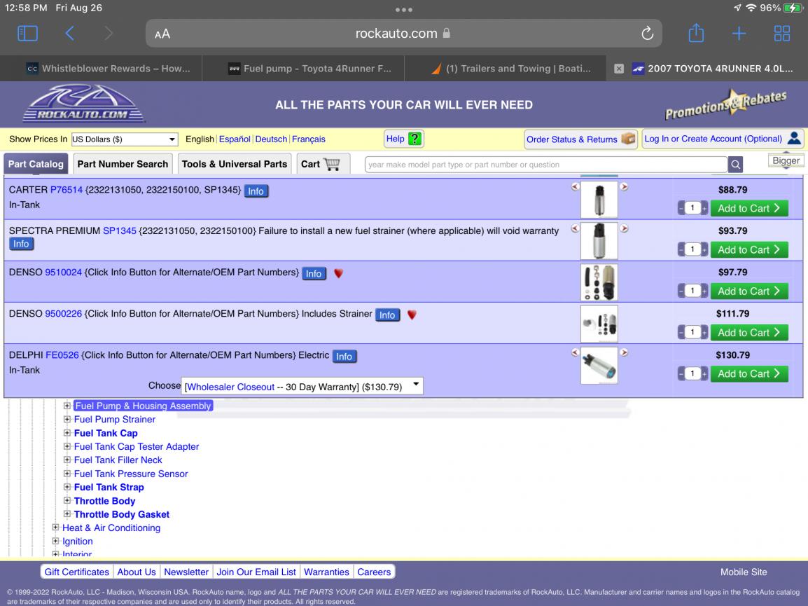

if made by Denso, can it be purchased without the Toyota mark up? and, is this a DIY job? i saw a tube video the showed an access port under the rear driver side carpet that allows you to unplug the pump electronically. in this video, they also cut the thin floor sheet metal to lift the pump out without dropping the tank (i am not recommending that method!).
Definitely a DIY job. Difficulty totally depends on the level of rust you've got. If your rust is minimal, and you can get all the gas out of the tank before swapping it, its really not that bad. You undo the straps, lower the tank, disconnect the hoses, and then pull it out and service the pump.
To clarify, I couldn't find an OEM fuel filter. Had to buy the entire assembly for that ($$$$$). However, you can get a Denso fuel pump for 125$ from Rockauto.

Yes, rockauto has the denso pump.

Yes, I linked to it on Amazon (~$109) in my post above as did Dr. Coffee (since RockAuto charges shipping, it's essentially a wash). But be aware that you'll need to remove the old pump from the housing and install the new one as shown in the illustration.
Also note the two-stage fuel filter system; the one called "fuel filter" is in the housing (pic in my previous post) and then there's the one which comes with the fuel filter and kind of resembles a coffee filter. So if you want a new fuel filter too, you'll need the housing, which is Toyota p/n# 2330050120. I paid ~$ 38 at a dealer's online parts store.
