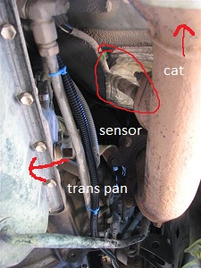

Tip: Your '01 should be the same as my Cali. '99. No bolt on plug. You need to undo the SENSOR first. Then pass it up and over the pipe and let it fall down the other side. You can then undo the plug easily. Do NOT try to undo the plug first as all the DIY's say to if you have a '99-'00 Cali. or any '01-'02, because it is virtually impossible. The DIY's I have seen are all written for the old single-cat exhaust, not the newer air/fuel dual cat exhausts.
