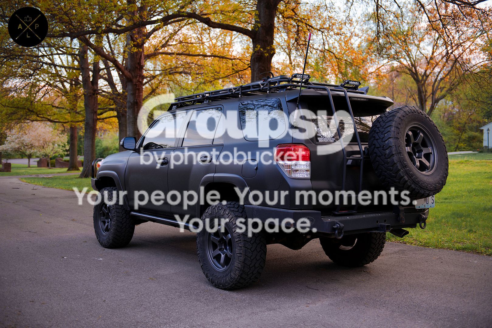

For those who are wondering how well the dip holds up to trail abuse, I just got back from the Lone Star Toyota Jamboree in Texas this past weekend and lets just say, I'm amazed.
While dipping mine a few weeks ago, I had a strong feeling that it wouldn't last once I took it off road. I thought branches and brush would tear into the dip like a fat boy on cake. Now I dipped mine in the first place to cover up my existing trail damage, it was becoming an eyesore and I even contemplated about getting the whole thing line x'ed. Decided to go with dip cause it was a cheaper non permanent solution.

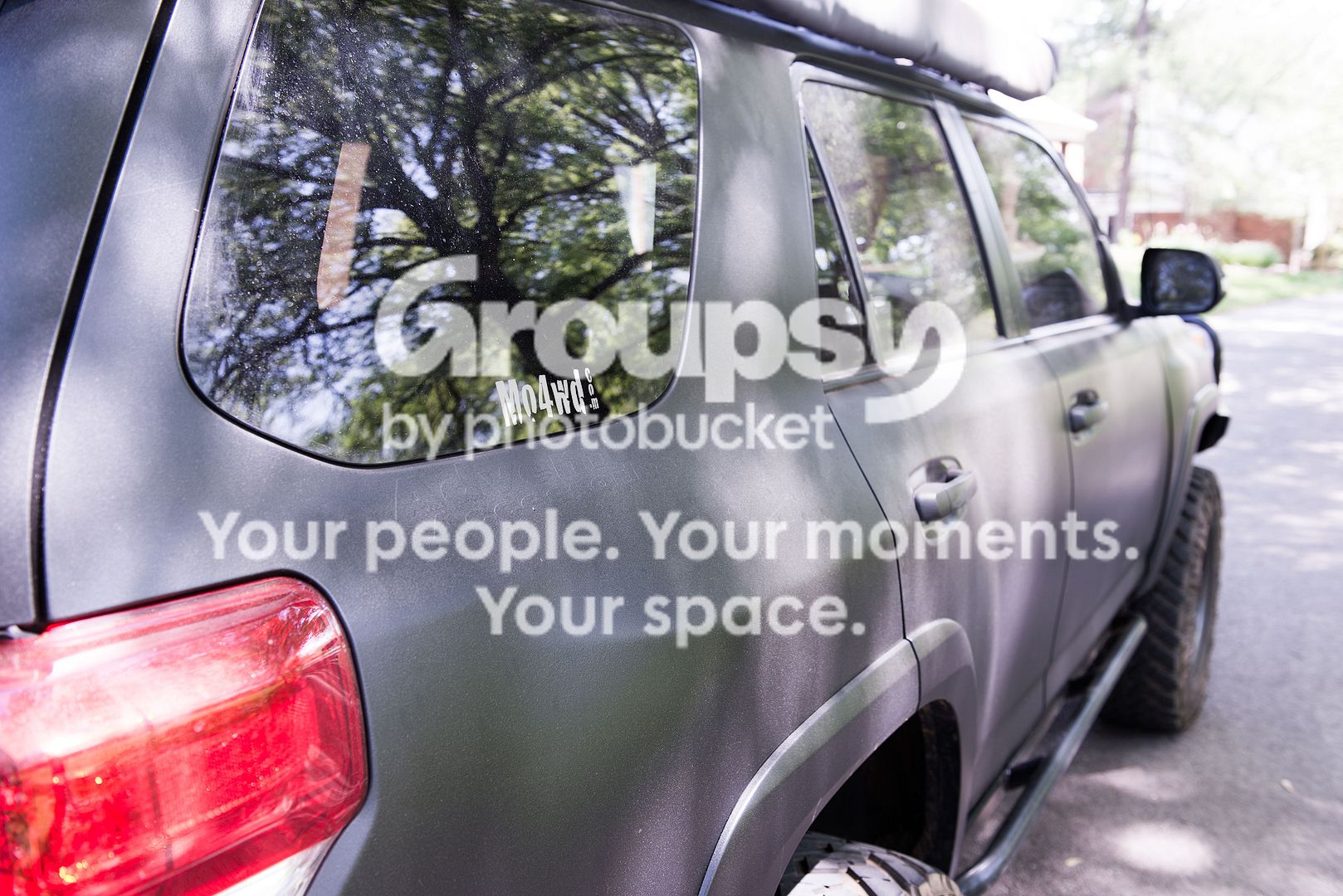

Here it is after I dipped it (50/50 black + gloss = Satin Black)

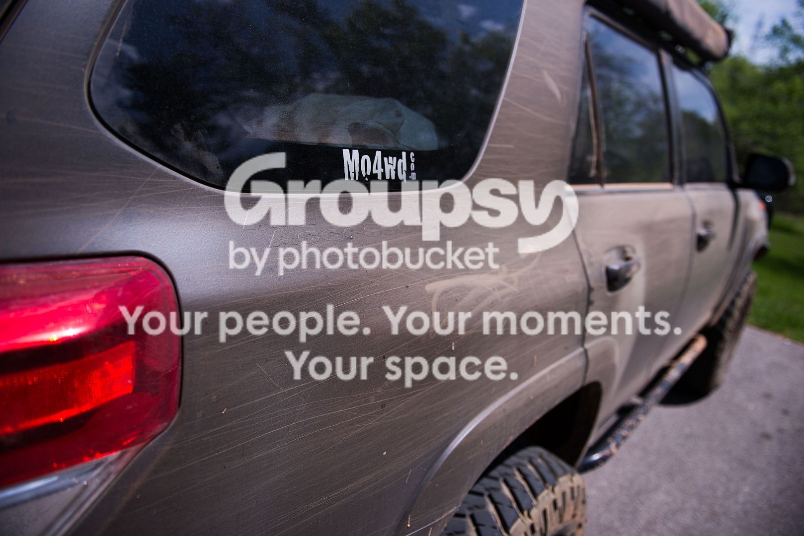

Now after running a few 3's & 4s at the jambo, a lot of tight wooded areas, tons of pinstriping. The light shaded scratch was actually where I had been pinned up against a tree.
After a run through the power wash & the only real way of cleaning dip, use a ton of simple green & a microfiber. Disregard all the green, damn pollen!
There are a few scratches deep in the dip, but nothing like my stock paint. The pinstriping that you saw in the picture above, was literally just marks on the dip, no actual striping.
