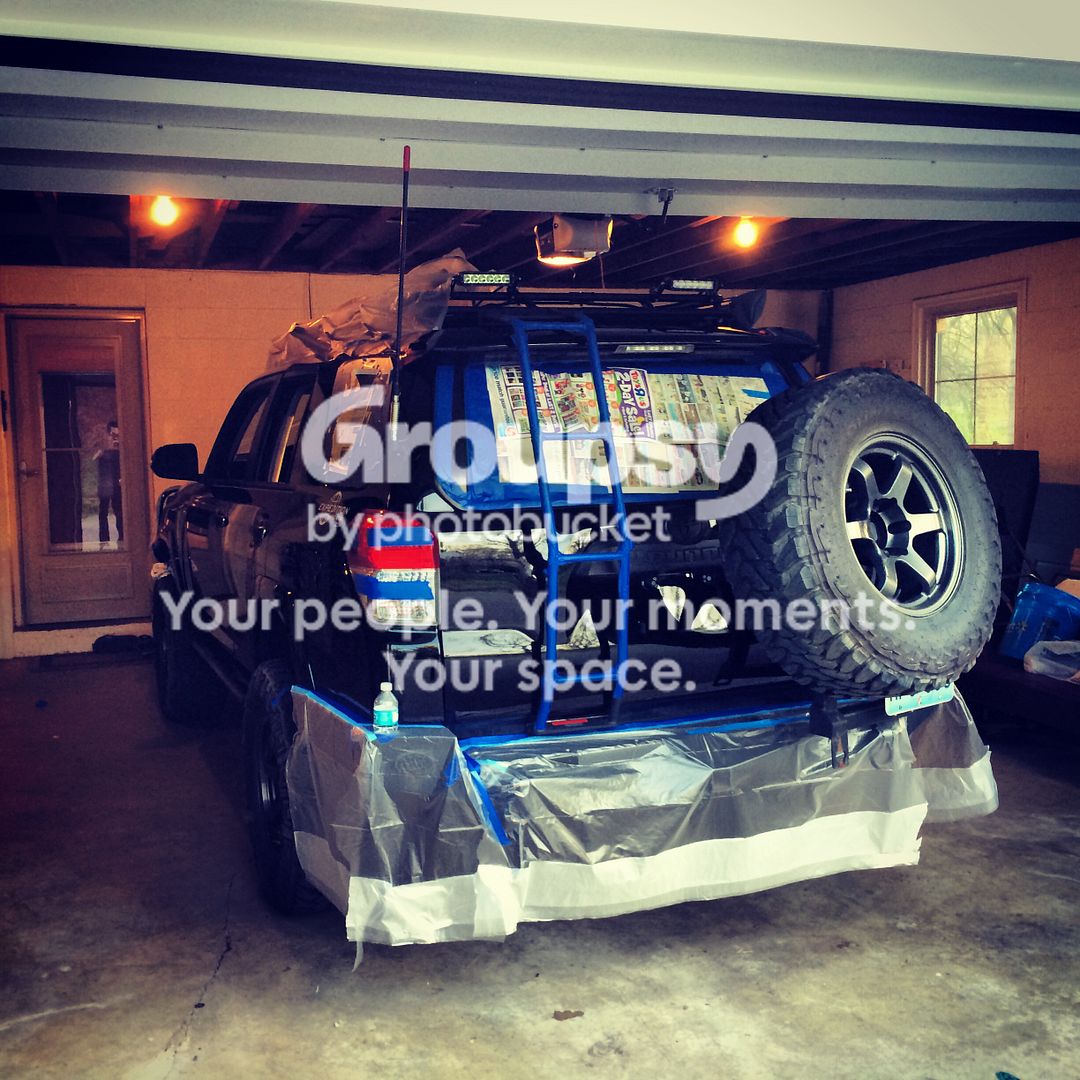

I left everything on, I don't care that much about how it looks to take everything off haha. Just did a good job masking and the DYC gun is pretty cool, it has this misting setting, so if theres any tight areas that are hard to get too, you can change the pattern & angle.

I just taped my entire roof off because I didn't want to mess with it. The black roof looks pretty good with the anthracite. Here's a good shot of my rig from above:
