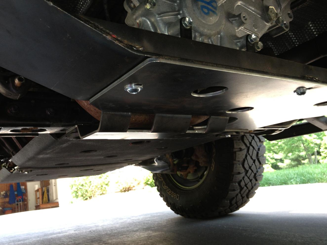

No, the photos on the forum didn't show the use of the OEM cross member support tubes so I took them out. Then had an issue with the skids sitting pretty firmly against the crossover exhaust pipe. Josh said the new ones require the crossmember support tubes to add the extra space for the exhaust.
Here's a photo without the tubes and the lack of gap.
Oh. I don't have support tubes. My transfer case skid swoops underneath the exhaust. Obviously mine are an earlier model not on a '14.

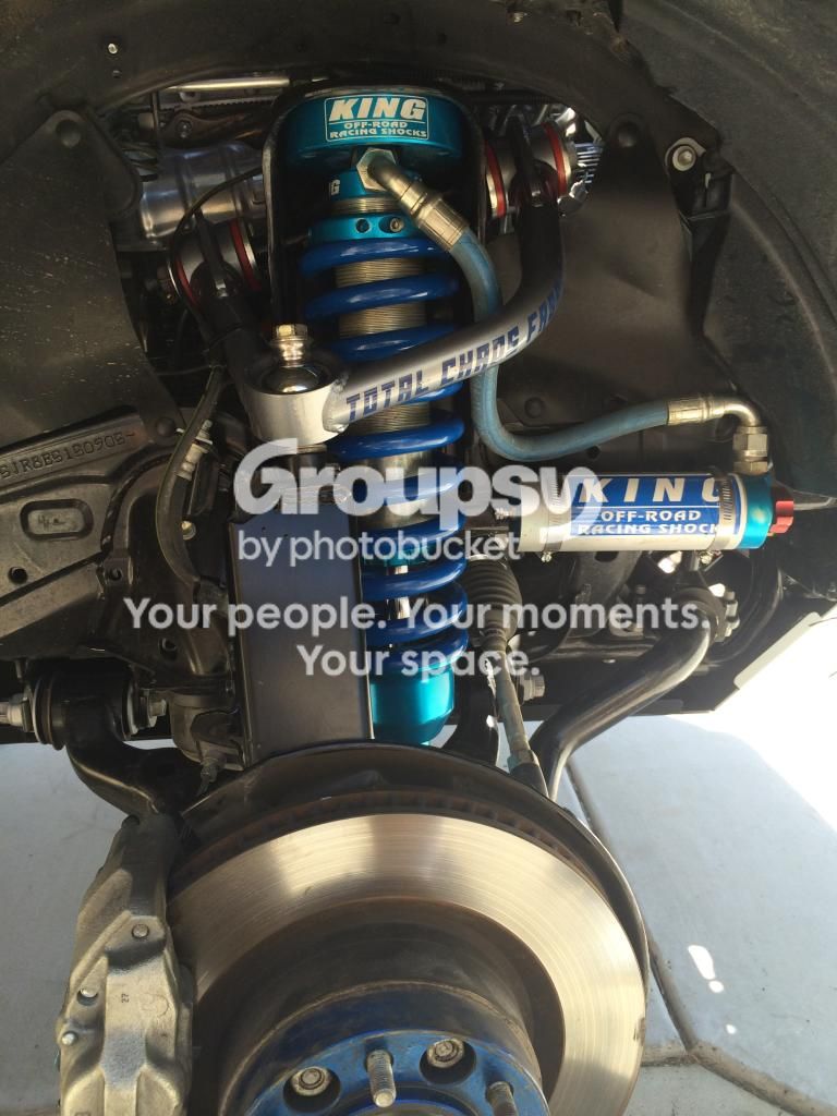

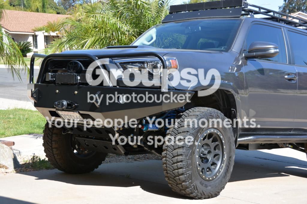

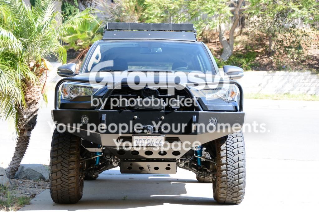

Got my 650# coils on and rebuilt my UCA's (just the poly bushings). Sitting at about 39.5" from ground to bottom lip of fender. I am pleasantly surprised that it's not too stiff, and that's without the Shrockworks and winch on yet. I'll get it dialed in the next few weeks.
So this is the finished product for a while....

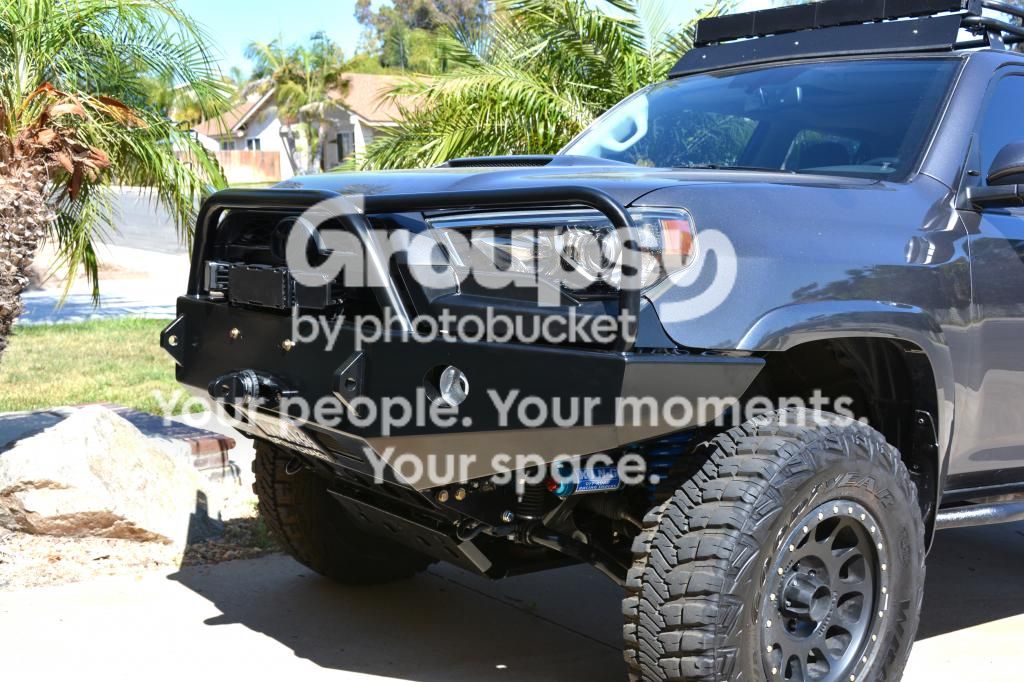

Added a Shrockworks front bumper, VR10,000S, Rigid Dually Floods, Rigid 10 E2
The rig is ready for the FJ Summit and Moab next week. I'll be sure to post photos as i go.

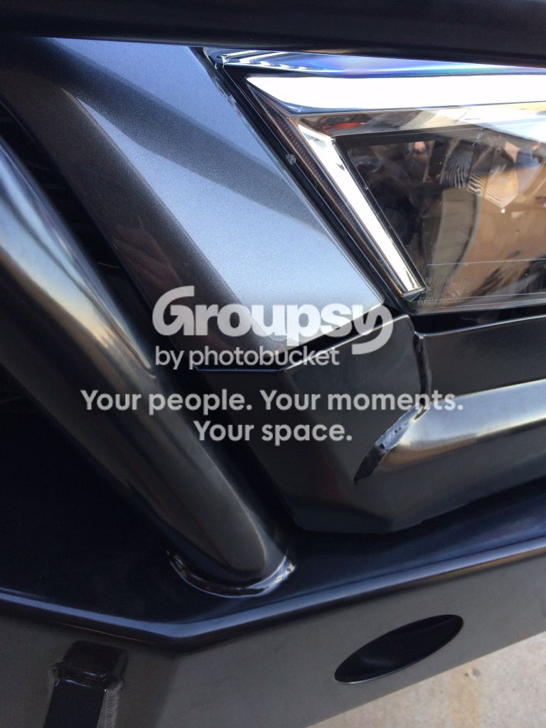

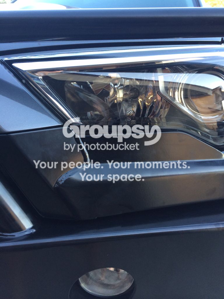

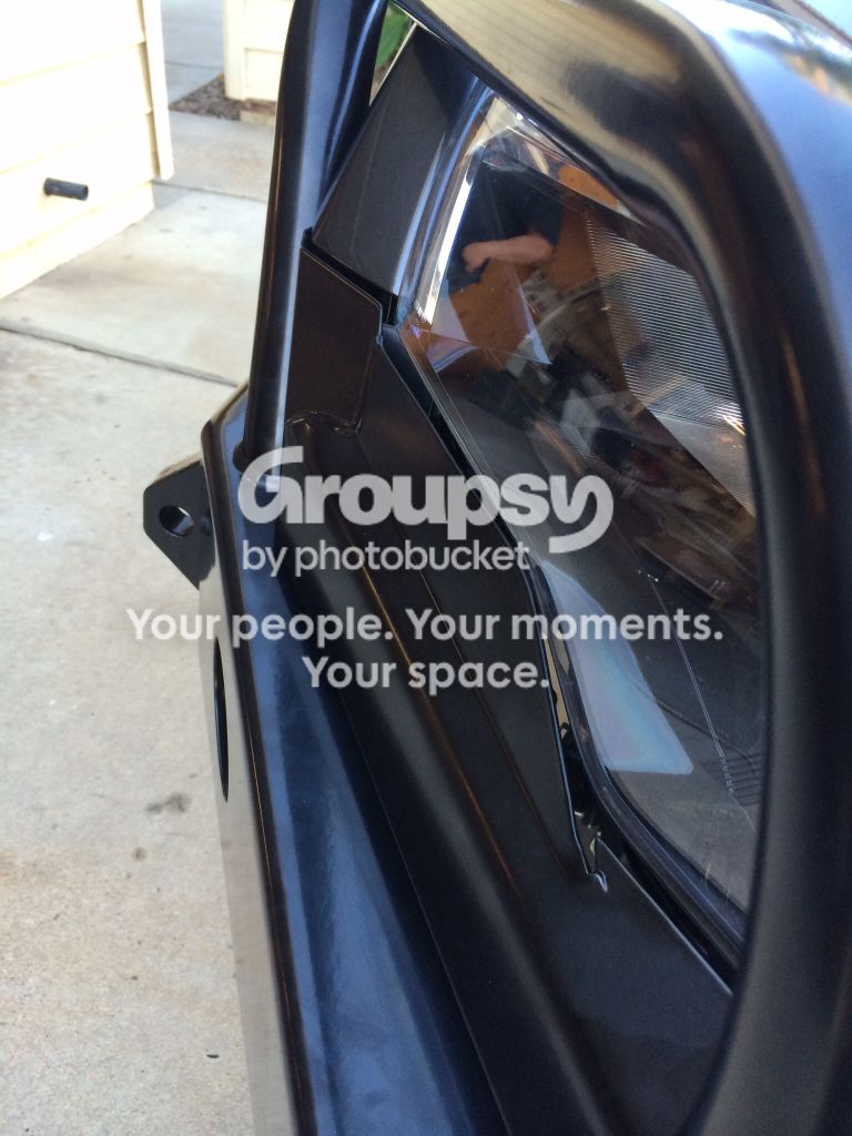

The headlight filler peices look like a nice fit.
Bumper looks amazing! Thanks for the pics.
Have a great time at the Summit and moab.
The filler pieces really fit bad to be honest, I'm not happy with them. I haven't had a chance to send them photos yet but I can see them damaging the headlight over time.
