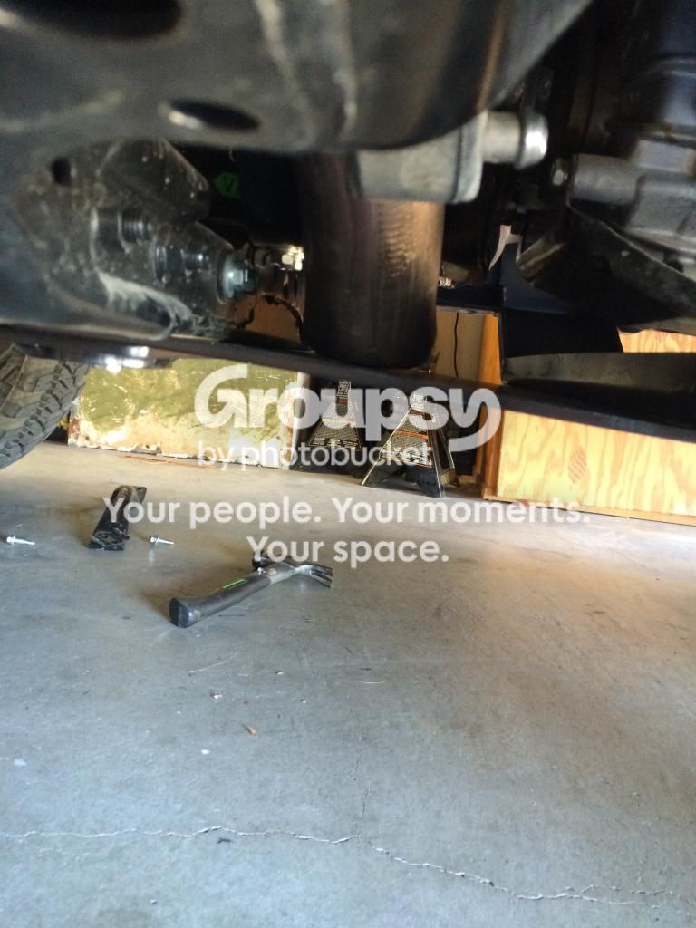

No, the photos on the forum didn't show the use of the OEM cross member support tubes so I took them out. Then had an issue with the skids sitting pretty firmly against the crossover exhaust pipe. Josh said the new ones require the crossmember support tubes to add the extra space for the exhaust.
Here's a photo without the tubes and the lack of gap.
Oh. I don't have support tubes. My transfer case skid swoops underneath the exhaust. Obviously mine are an earlier model not on a '14.
