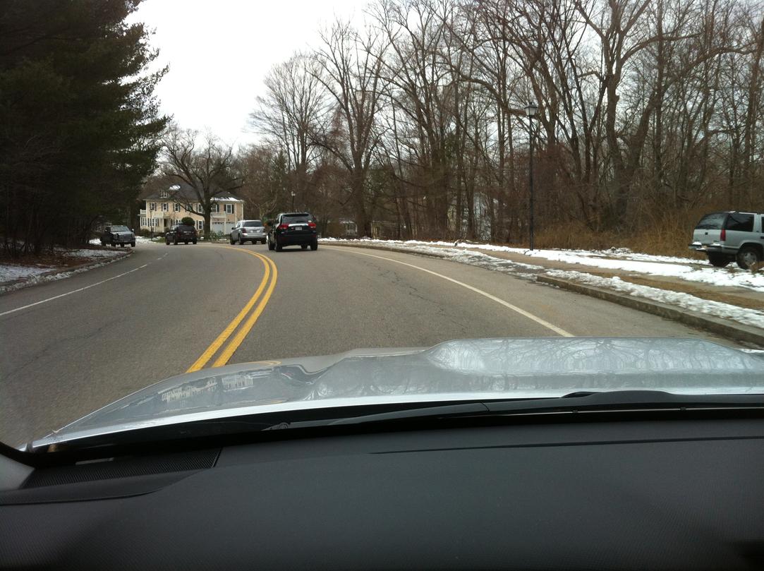

1. The type of road I drive on primarily - side roads, 30 to 40 MPH

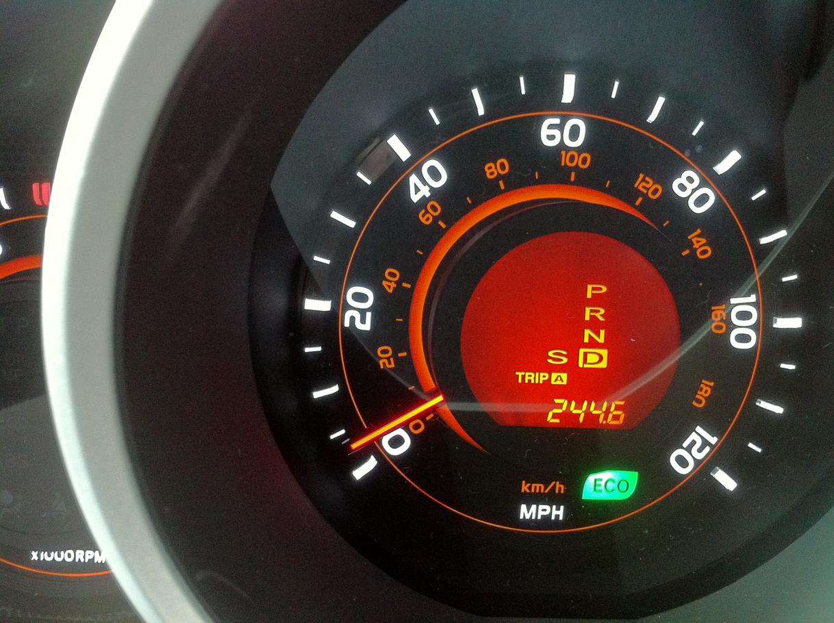

2. The miles I drove on a full tank

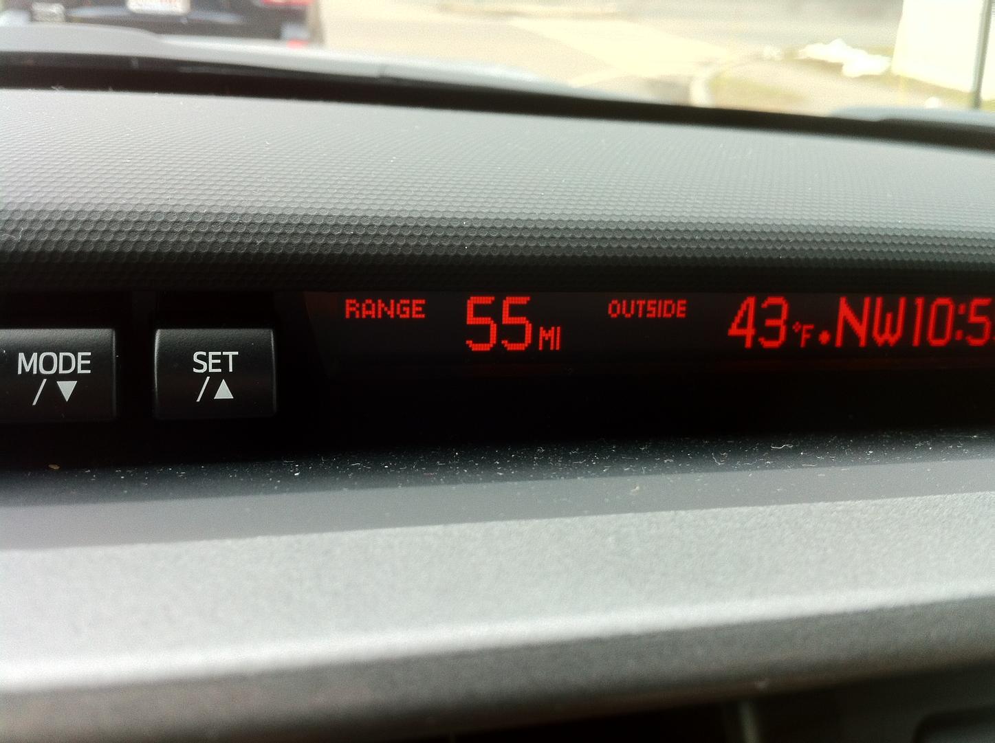

3. The range shown left

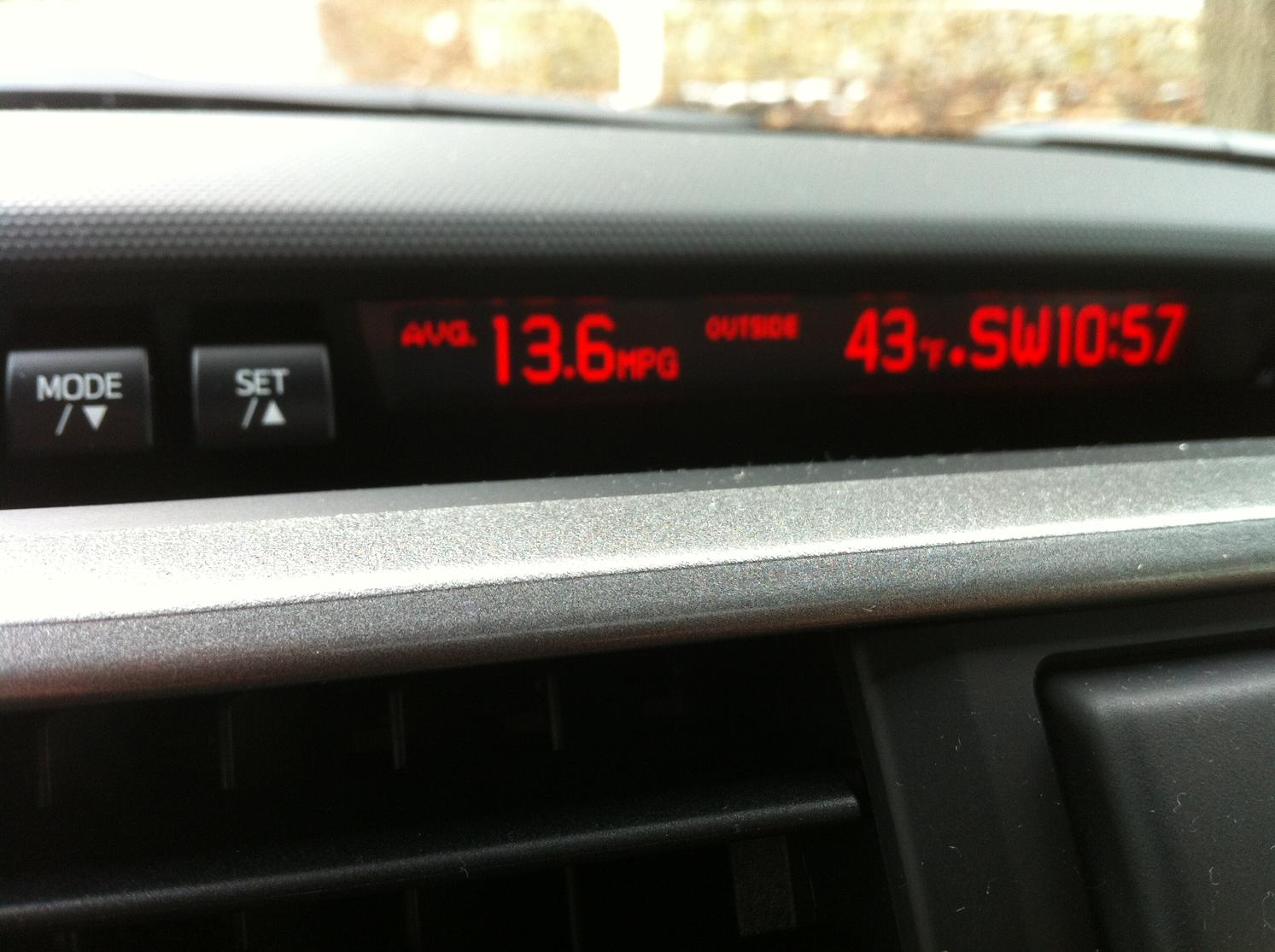

4. The MPG from the gauge

I set the trip odometer when I filled up the last time. Filled up this time with ~18 gallons. At that point I had driven ~250 miles.
