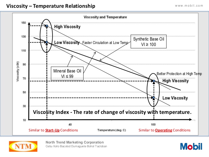

A synthetic, if superimposed on your graph, would be much flatter and change less over temperature. Viscosity INDEX is the keyword when looking at conventional versus synthetic fluids. Here is a link explaining them here http://www.machinerylubrication.com/Read/28956/lubricant-viscosity-index
Here is a simple graph showing a difference between conventional versus synthetic.

I Think it should look a lot more like this using a logarithmic y axis - your graph simply looks linear because the range is sufficiently narrow:
The difference in viscosity for each unit of temperature change at lower temperatures can be significant. If it wasn't, you car wouldn't be noticeably harder to start when it was cold. You wouldn't get gear box whine or any of the other common observable symptoms at -20*Fthat you don't experience at 20*F.
Edit: After looking it up, I'm now confident that the theoretical and empirical models are logarithmic/exponential. The Mobil Oil chart is a simplification.

What are you trying to say?
I never said linear in my original post.
If you have a high VI synthetic engine oil (don't know where you got gearbox lubrication whine) then the curve for that fluid would be much flatter than what your chart shows. I just posted a quick graph and link for simplification.
My point is an engine running synthetic oil won't take substantially more or less time (from say 20-50 degrees F) to warm up to operating temps and the ambient temperature will not effect the consumption of fuel appreciably until the temperatures approach extremes. Is this wrong? Please feel free to correct me.
What I'm saying is that cold starts and driving cold vehicles with thicker oil and lubricants throughout does significantly effect your gas consumption. It burns more gas to warm to operating temperature, requires more gas to overcome the additional friction throughout the drive train, and results in lower MPG. The difference between 20* and 50* starting vehicle temperature can be significant.
As for gear box whine. Find an manual transmission Toyota and give it a start at -30*F. Let off the clutch and listen. Spinning the input shaft alone in really cold thick oil will result in noise from the bearings. Even the new 4runners will make unpleasant noises from sources like the power steering pump at that temp.
