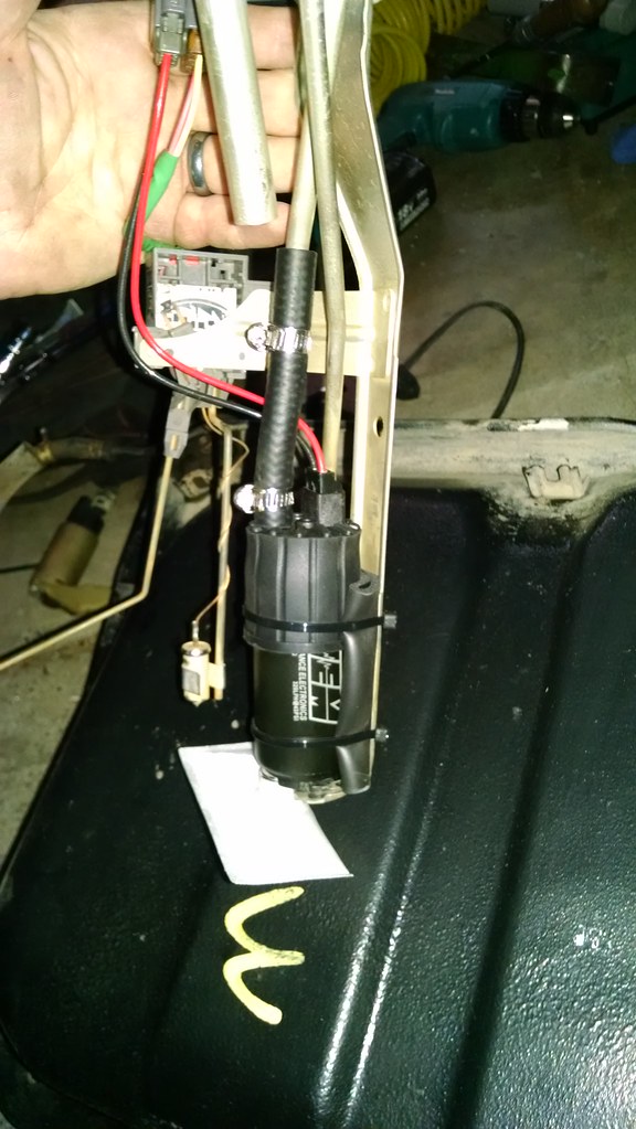

Here is the sender and the vent pipe I am talking about (the tube that ends by the ring on this guy's finger. That's what I plan to shorten. I just need to find a good pic of the newer sender for '99s.
I also have a 99 and cut back the vent tube about an inch and a half a few years ago. Now I fill up 16/17 gallons when the gas light comes on instead of 13/14.
