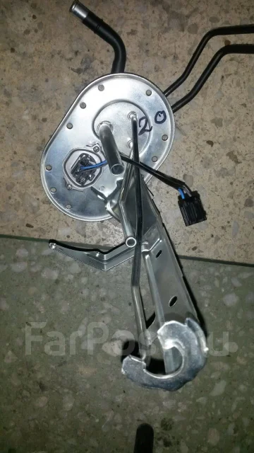

Here is the sender and the vent pipe I am talking about (the tube that ends by the ring on this guy's finger. That's what I plan to shorten. I just need to find a good pic of the newer sender for '99s.
FWIW, my vehicle calls for procedure 2, according to the linked PDF, but its a tad out of warranty.
Thanks for the pic. That actually looks like the fill tube. Isn't the fill just a smaller tube inside of the vent tube; like a tube within a tube? That's how it is on the Ford Ranger - I know because I used on on my Chevy when I moved the tank to the rear and made it fender fill (vs bed fill)
EDIT: pipe in pic by ring finger is indeed the vent tube, thanks!

Just for clarification: The extended tube (shown by the guy's ring finger in the picture) is for venting? Which in turn, with the new vapor sensing nozzles, only allows about 12-14 gallons to be put into the fuel tank (which has a 18.5 gallon capacity?)?
So by shortening the tube, you gain the ability to put more fuel into the tank?

All I know for sure is that they revised the tube to make it shorter. That is the tube that allows air to escape as gasoline fills the tank. When liquid in the tank rises to block the tube, air can't escape so gasoline backs up in the fill tube and triggers the nozzle shut-off.
BUT, I do not know of anyone who has actually modified the tube. There was a poster with a '99, a few years back, who subbed out his sender unit per the FSB attempting to resolve his flaky fuel gauge. He photographed the two side-by-side. That tube was clearly shorter, and afterwards he got more fuel into his tank. He also had a more accurate fuel gauge, so the causality is not perfect. But it certainly makes sense to me. That's when I got the idea. It's just that now I have the opportunity to do it with the sender on my kitchen table.

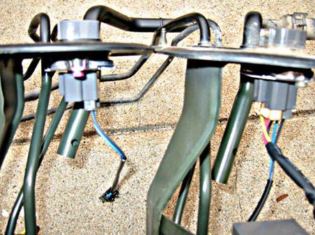

You can see the vent-tube is far shorter than the one pictured up thread. I'll post a pic of mine later.

So I spent waaay too much time pulling the gas tank to install the redesigned vent tube. Below is a picture stolen from one of the forums of the old and new units, mine looked just like this. The result was a fill of 17.0 gallons when the tank is run until the engine dies. The light now typically comes on when i've used 14.0 gallons.
Removing the tank was such a PITA, that I wouldn't recommend doing this, and I totally regret doing it, it wasn't worth the effort for 0.5 gallons. If you have a body lift though, it will be easier. I replaced the level sensor at the same time(recommended by the TSB), and that was a more significant improvement as my fuel gauge now reads more consistently.
