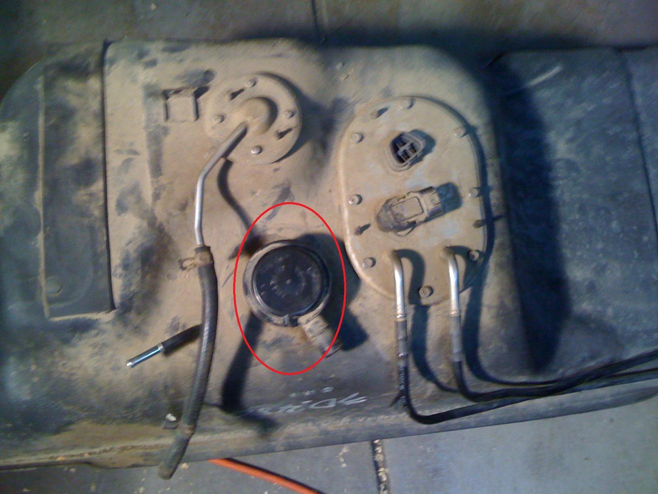

Gas tank removed! But what the hell is this?
disconnected111
So the Haynes manual of course does not refer to this part. While removing the gas tank to replace the fuel pump, I broke a plastic hose connector and now I need to replace the entire part......can someone help? what is this part called?
Thanks,
David
P.S.
this is a 2001 Toyota 4runner Limited ( the broken piece is the smaller hose connection to the left of the large one)
How did you remove the hose from that piece that you have circled? I am having so much trouble removing it.
I just did a new pump, I had to lower the tank partially to get the hose off next to it (I don't have a check valve). I'd assume the same for that hose.
Roll-over check valve. They SHOULD be replaced when you replace a fuel pump. Very common for them to fail which will cause a stinky gas smell at the back of the truck. I had to replace them on both my 01 and 02. They go out so often, dealers usually stock 3-4 of them.
Info on replacement and part numbers starting at post 84 on this link (keep scrolling down for replacement info)
