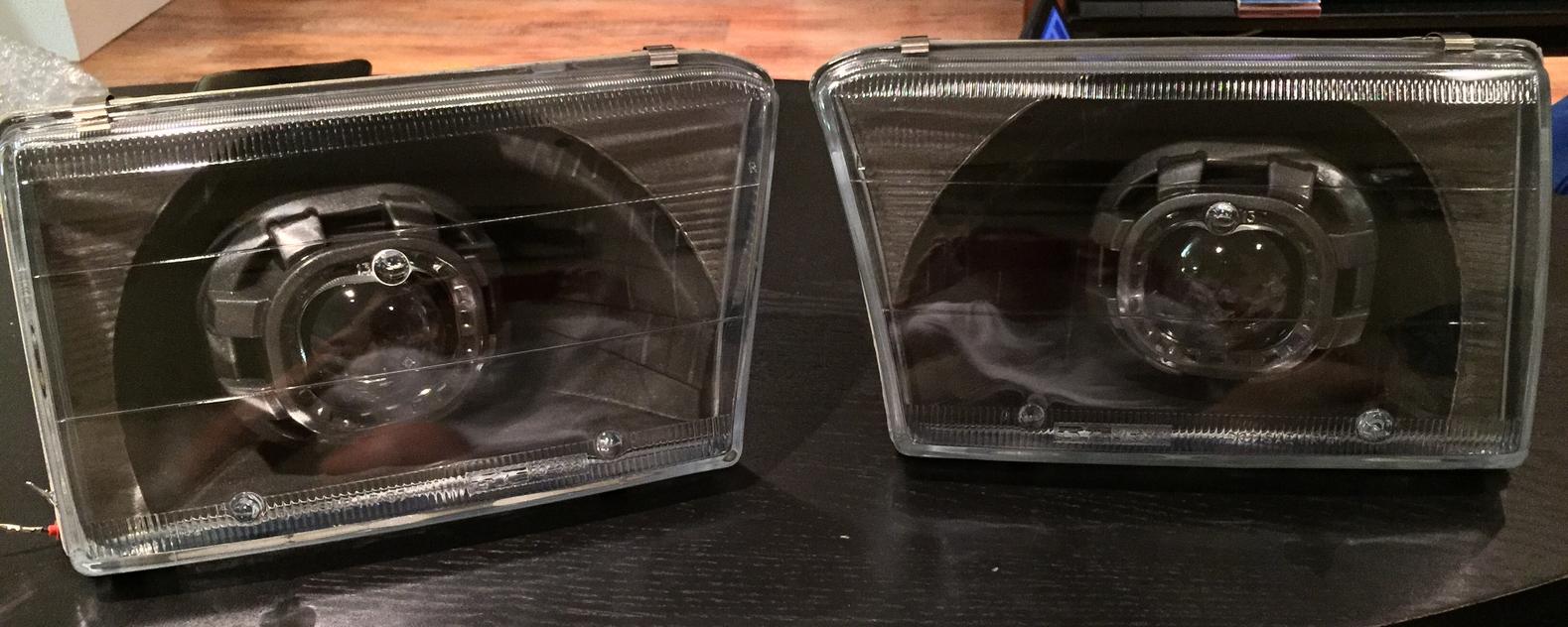

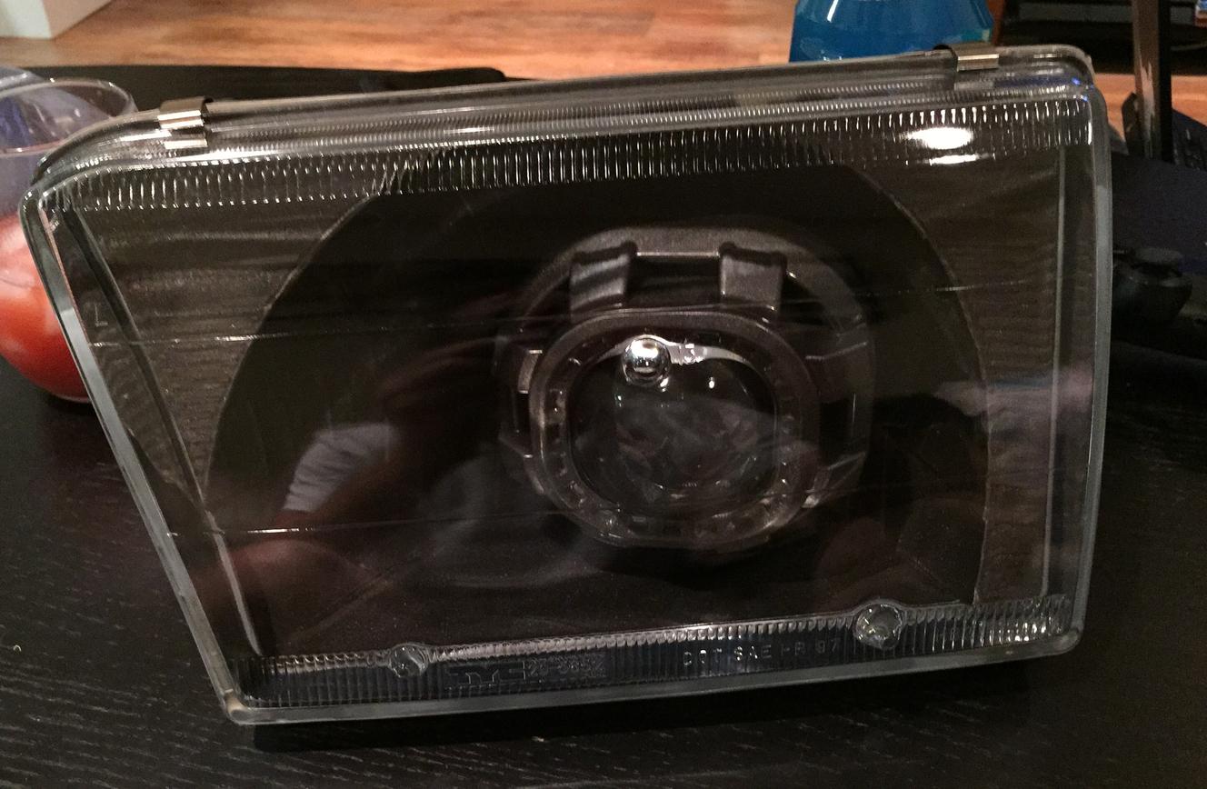

Pics
The 1st pic is from my personal retrofit but it gives you an idea of the quality. The next pics of from the 1st set that will be for sale. I should have it finished in the next 24 hours.

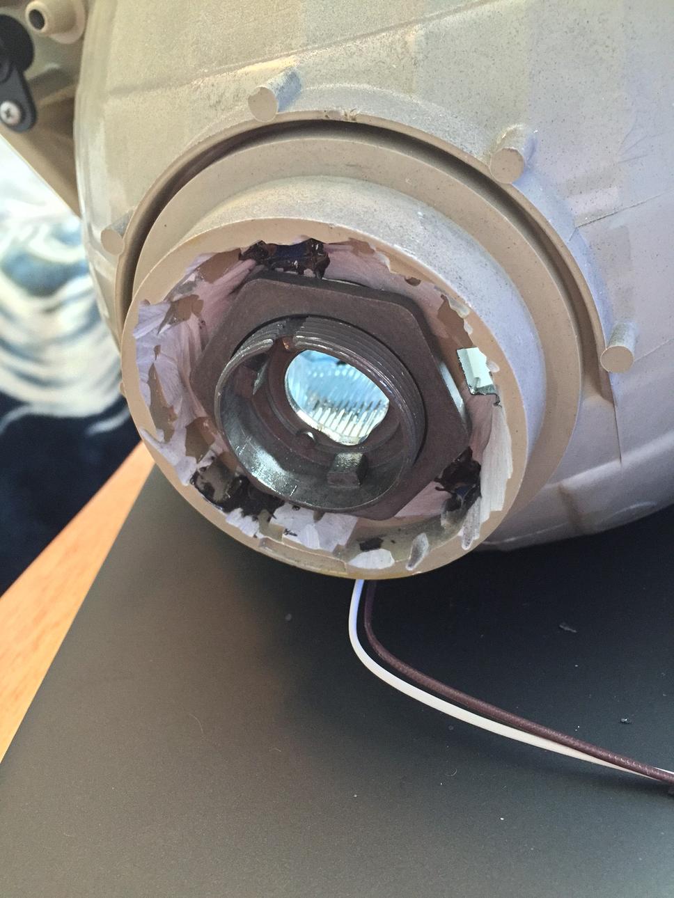

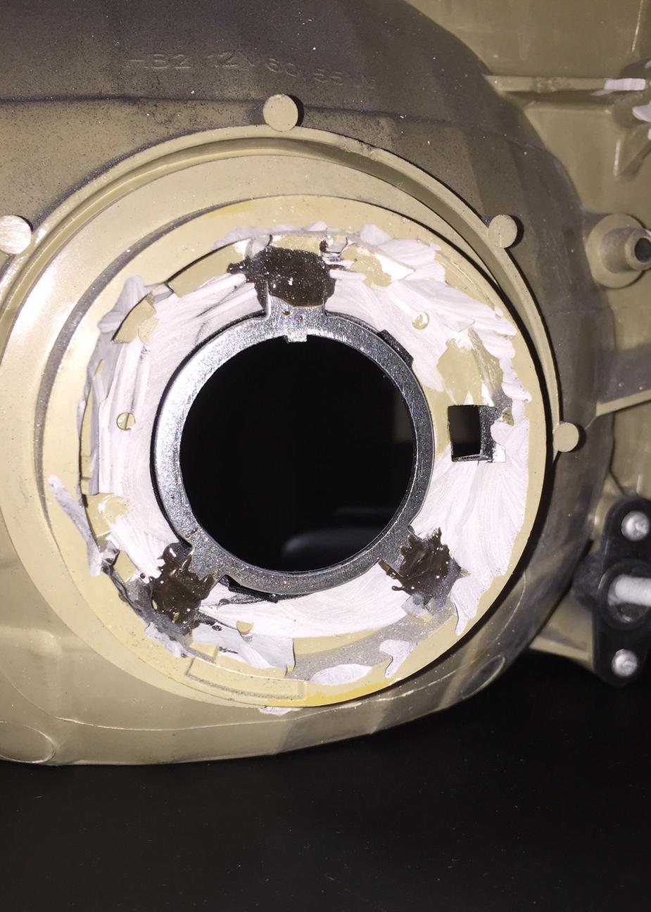

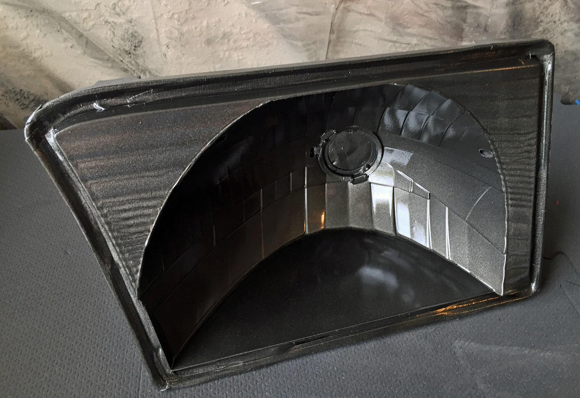

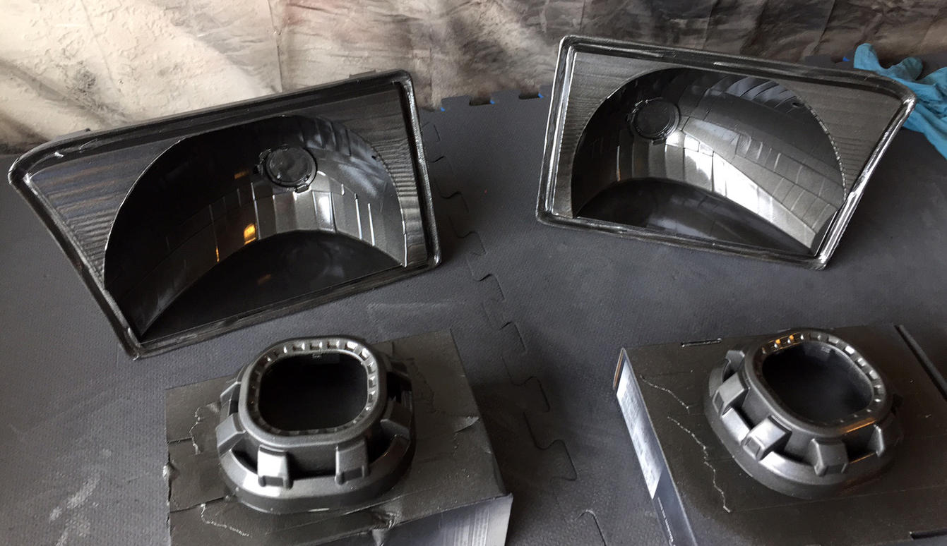

Here are 3 more pics from just this afternoon. These show the dremmeling and how I lined it up for the install.
1st picture below
I dremmeled the light so that there was enough room to install light. This is very apparent if you have it sitting in front of you. I marked the 3 alignment points with a sharpie. It is very obvious which one is the top since it has that little inside notch. Then I JB-Welded it in place and let it sit over night.
2nd picture below
I installed the light by screwing it in place using the easy mounting nut that TRS provides for the light assembly. Because I JB-Welded the mounting ring in place the day before it did not move throughout the process.
See the 3rd picture below.

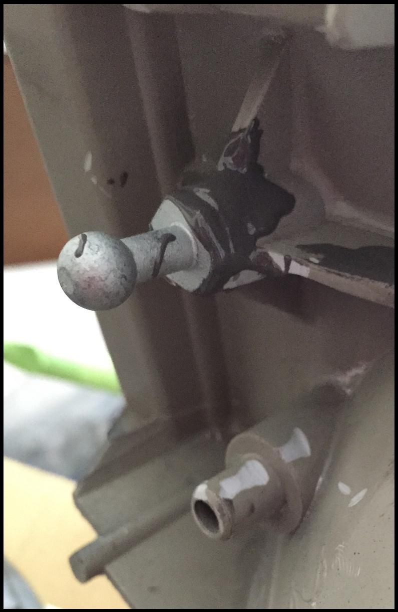

It is highly important to JB-Weld this screw in. I did this by first removing the screw, scuffing the area up a bit and then putting JB-Weld in the hole and around the screw.
Why? Because with both my TYC lights that screw came loose after a year.

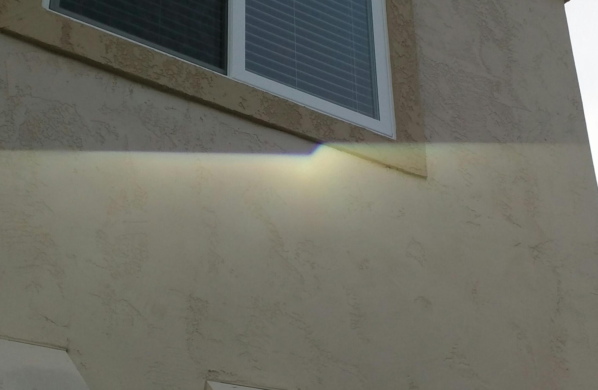

Picture of the cutoff. It looks better than my FX-Rs. Perhaps that is because of 2 years of 4 wheeling the FXRs.
See below. It is at an angle only because I was holding it in my hand and the ballast connector is pretty short.
