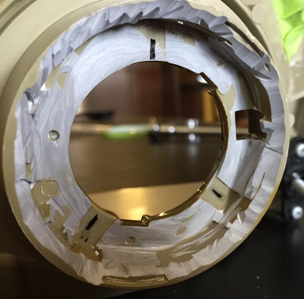

That is how much I had to trim off. I don't know about the taping off because like you said I just removed the screws and the plastic because I painted mine

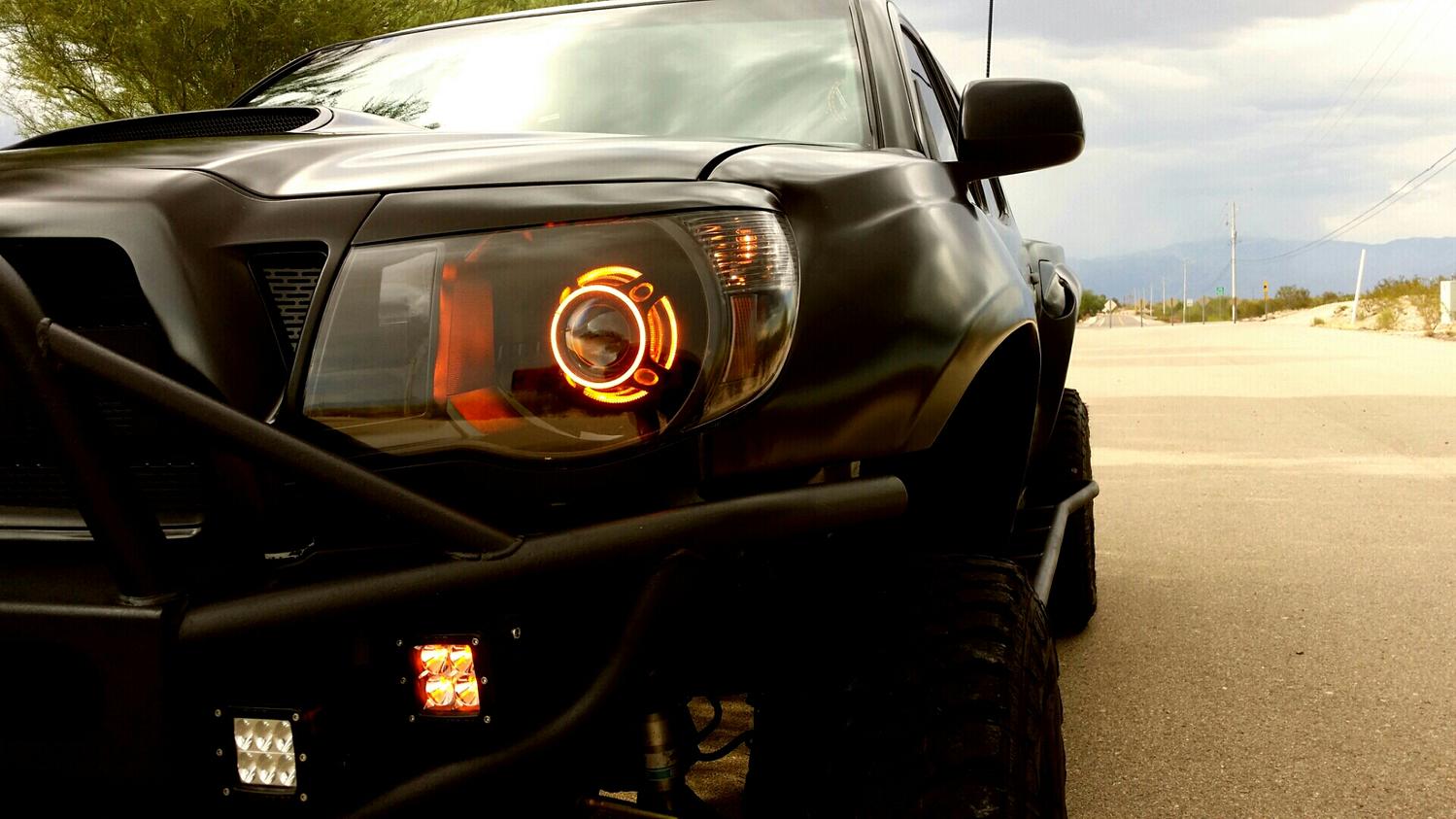

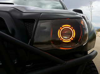

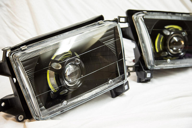

This is what I'll be going for with my own build on the next modification.
Except NO smallest ring.
:bat:

Well, looks like I now know what design I want to emulate once I finally get around to doing mine. I'd just rather use the square projector with the pana-square shrouds.

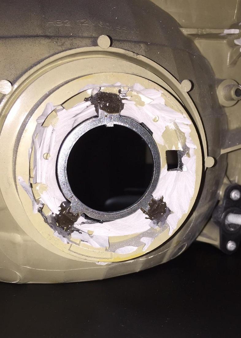

What washer? A-Wilson uses a washer. I used jb-weld to hold the Morimoto keyed metal piece in place during install. The pictures are on page 1.

Though now that I'm looking at them, I'm not liking the square style as much. The Apollo 1.0 seem to fit better.
Hah, now I feel like a jackass after going back through the tread again and seeing your first set is basically what I'm talking about. I do like the idea of having the switch back halos wired to the corner lights/turn signals.
I like the look of both the square and round. Also I don't think you can even tell a square vs round if you are more than 10 feet away.
The biggest drawback to the squares is the lack of affordable square Halos. They exist but the are pricy. The TRS square switchback halo would would but it is pricy $70 and I couldn't include it in my retrofit.

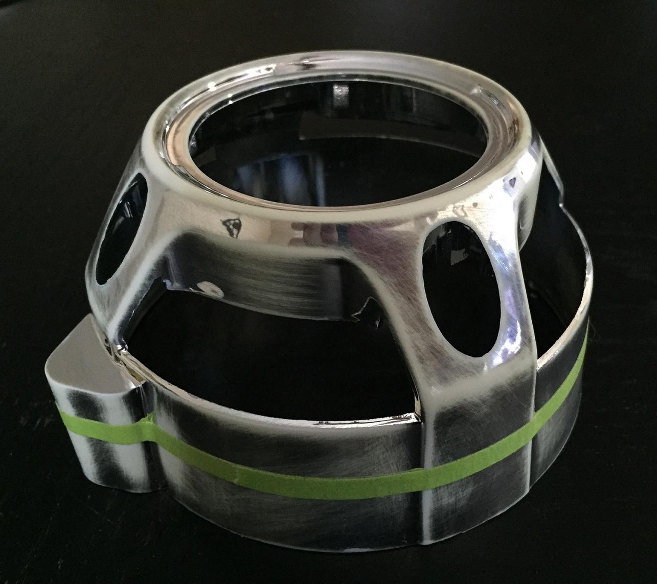

* Wet scratch pad scuffed up the housings then the Panorama Shrouds

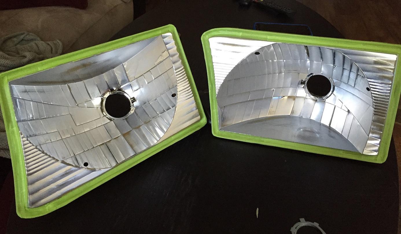

* Taped up the housings, covering up the glue so it isn't painted

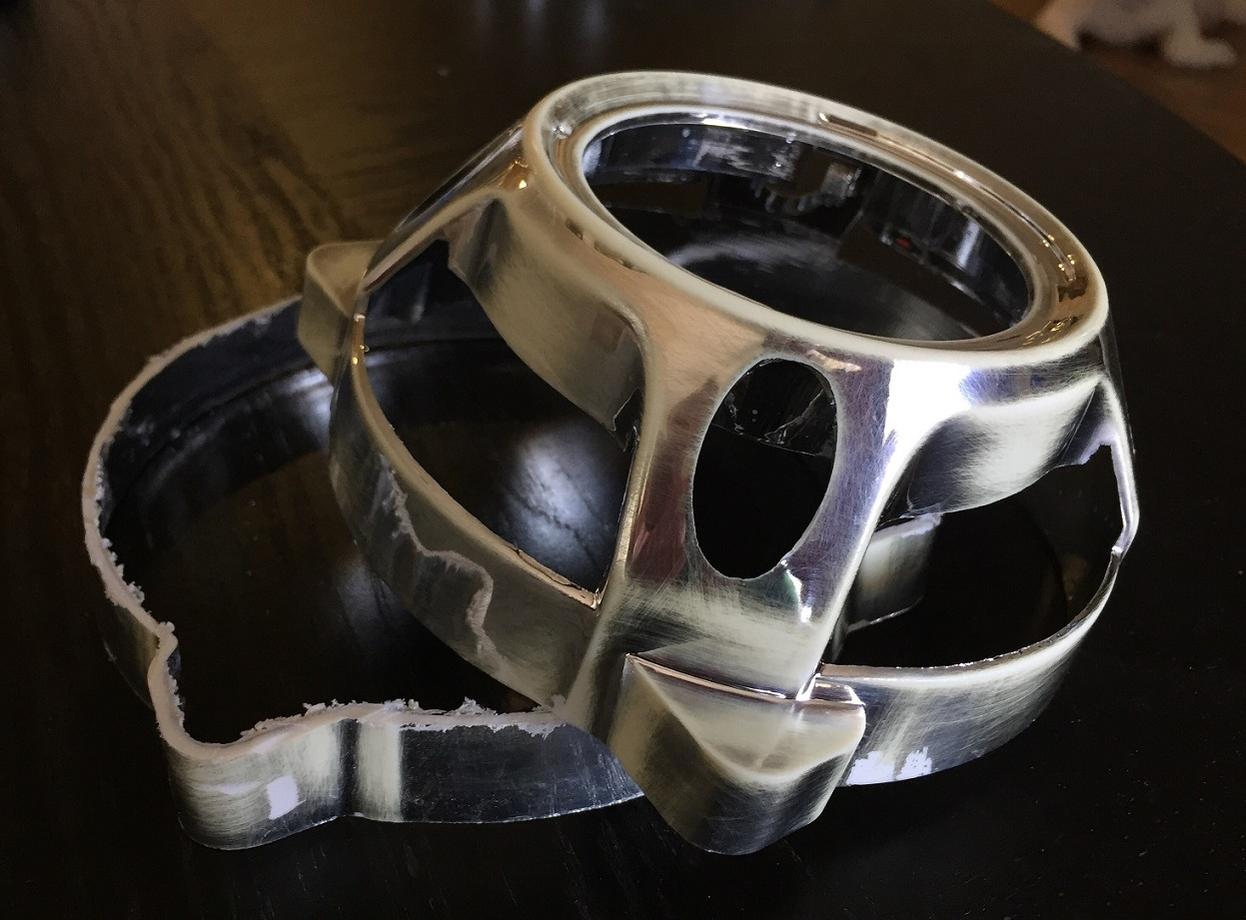

* Taped the shrouds, marking them to be cut

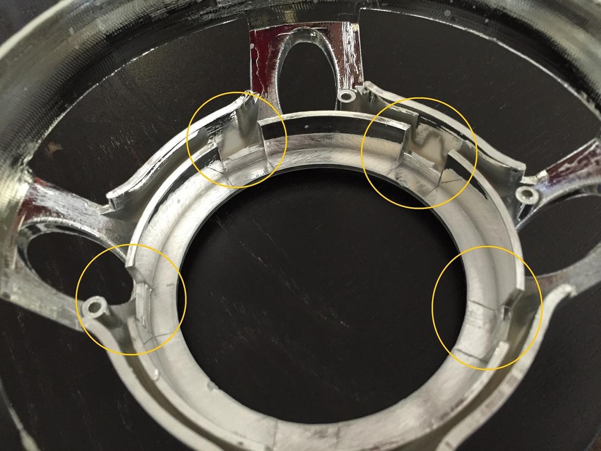

* Broke off the alignment tabs on the Panorama shrouds, they don't fully engage and they let light out. 3M tape will be more than good enough.
* Used my dremel to cut the Panorma shrouds along the tape line
* Used my dremel to cut the light housings as shown

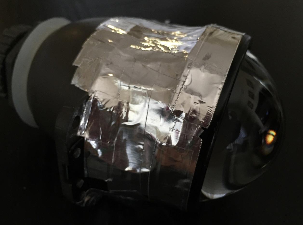

* Sealed up each Mini D2S 3.0 projector with metal tape to remove all light pollution (this took an hour for both BTW)

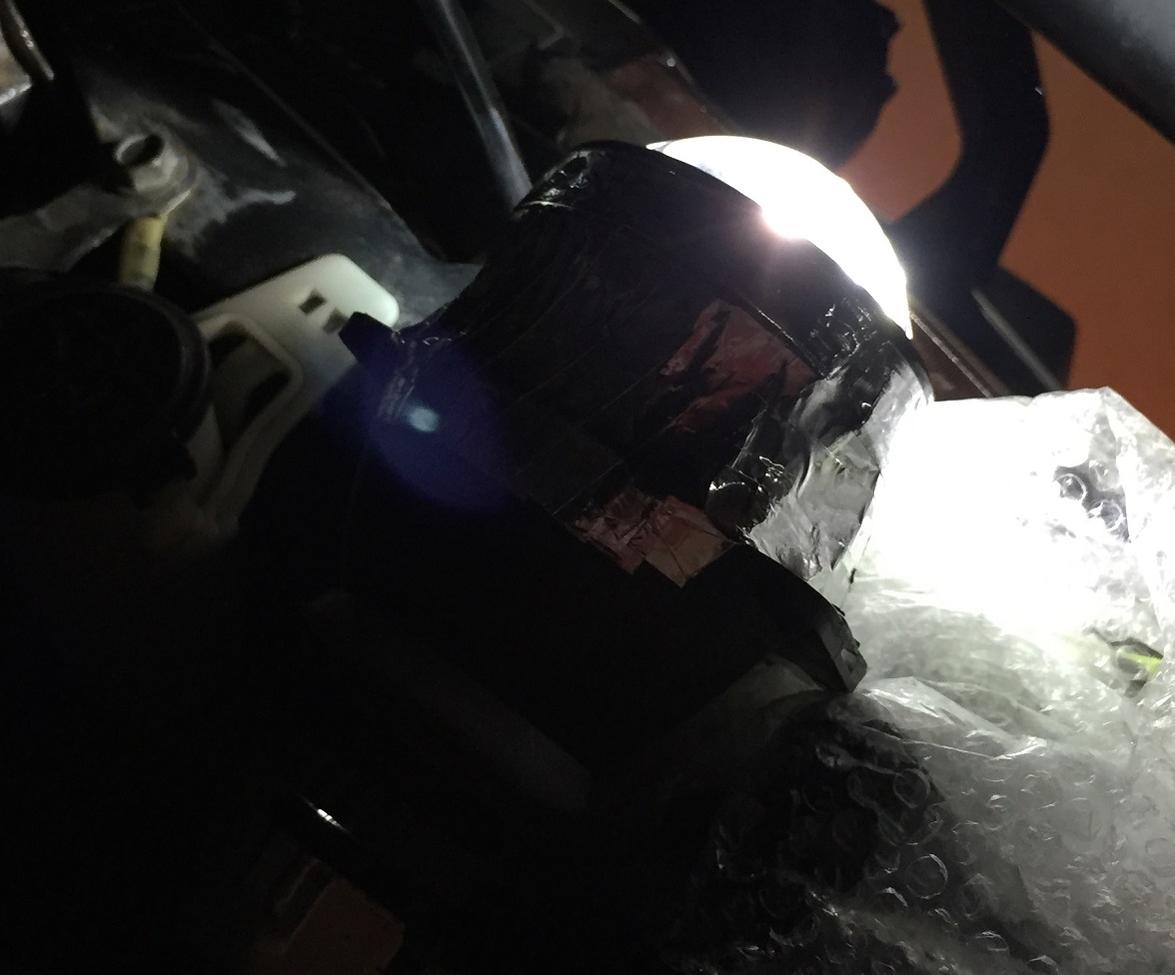

* Installed bulbs and op tested the projectors with the ballasts on my truck
* Painted the shrouds, 5 coats (primer 2x, paint 2x, clear 1x)
* Painted the housings, 5 coats (primer 2x, paint 2x, clear 1x)
* JB Welded the metal alignment key into the housing
I decided to seal up the projector lights on this one because with the panorama shrouds I want the only light in the housing to be from the LED Halos.

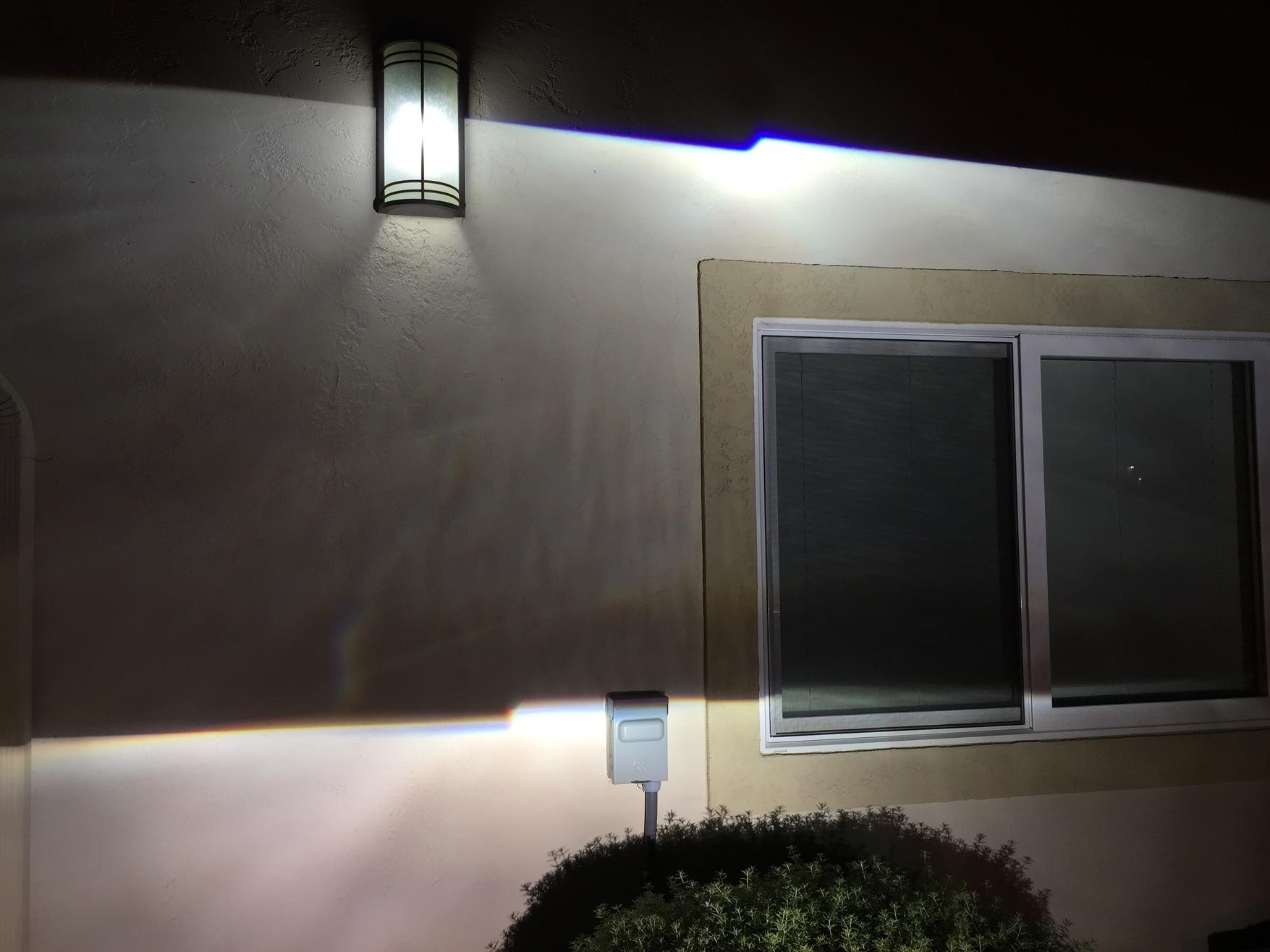

Check out the light cutoff with the D2S 3.0 and Morimoto 5500K bulb.
The one in the top of the picture is the D2S 3.0 projector in the raw (no light housing) and the bottom is from my FXR inside the TYC housing. The housing bends the light slightly making it a bit less sharp.
