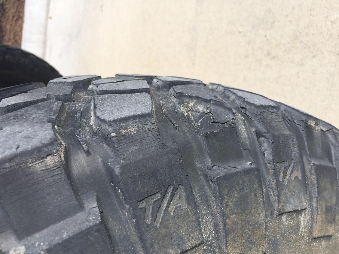

I agree on the 4.88, it's worked out very well for me. I have been daily driving 255/85/16 with a lockright in the rear end for 30k miles. It will change the way you drive and eat the tires when turning.. I have KM2's and it has knocked off quite a few of the lugs.. some on the trails but I feel most on the regular streets when I turn and give it gas.

I have been daily driving 255/85/16 with a lockright in the rear end for 30k miles. It will change the way you drive and eat the tires when turning.. I have KM2's and it has knocked off quite a few of the lugs.. .
Must be driving style. I dailied mine with a Spartan and skinny KM2s for two years, didn't get any more wear on the rears than I did the front. I definitely didn't tear any lugs off.
It might be driving style, I wheel it pretty hard and the truck looks pretty beat now-a-days.. Almost every single lug has a stretch/cut mark at the base on each side.. like it's been flexing too far and is tearing the rubber. I have had these tires for almost 4 years.. I'll take a picture later and try and post it up.
Did yours squeal or make the little "chirp" noise like it was slipping on the street when turning? Mine does almost every time I take a 90° turn with my foot on the gas. It could also be the type of locker, mine it about the cheapest locker out there..

duh, I reread your post "87 4r".. wasn't thinking straight. I am not very nice to my tires, so I guess this is a good example of 30k rough miles on KM2's looks like..
