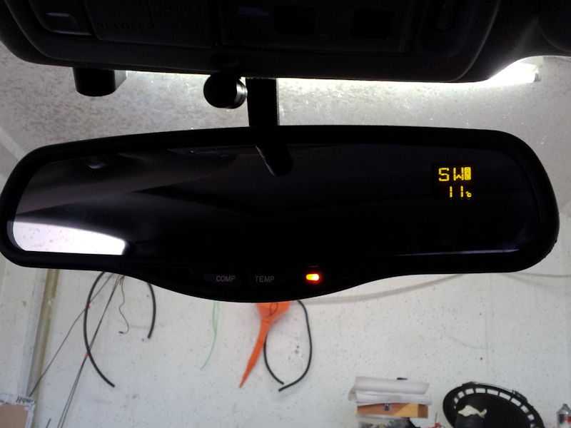

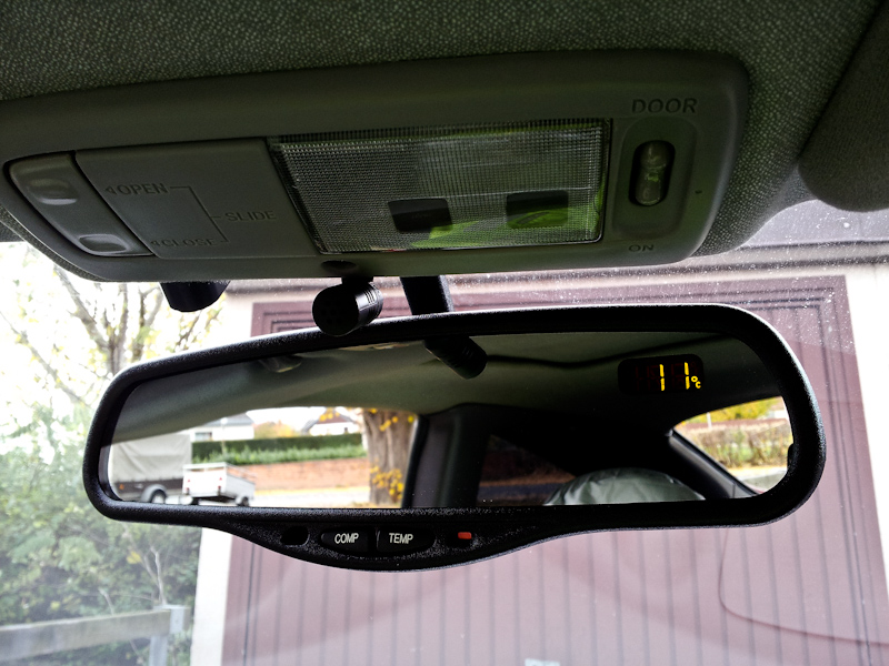

When you disassemble the mirror, you can see a thin blue plastic glas behind the display:
This plate, colors the LC Display in the green/blue.
I took a piece of an amber acrylic glas...
and cut it to the dimensions of the blue glas.
Then I put two little glue stripes on this amber plate and stick the plate on the Display.
On that occasion, I changed the green color of the indicator light, too.
There are different kinds of indicator lights in this mirros. In my first mirror was a rectangular LED. You can change this LED to a amber rectangular LED:
In my second mirror was an green SMD. Easily change the green SMD to an amber SMD!

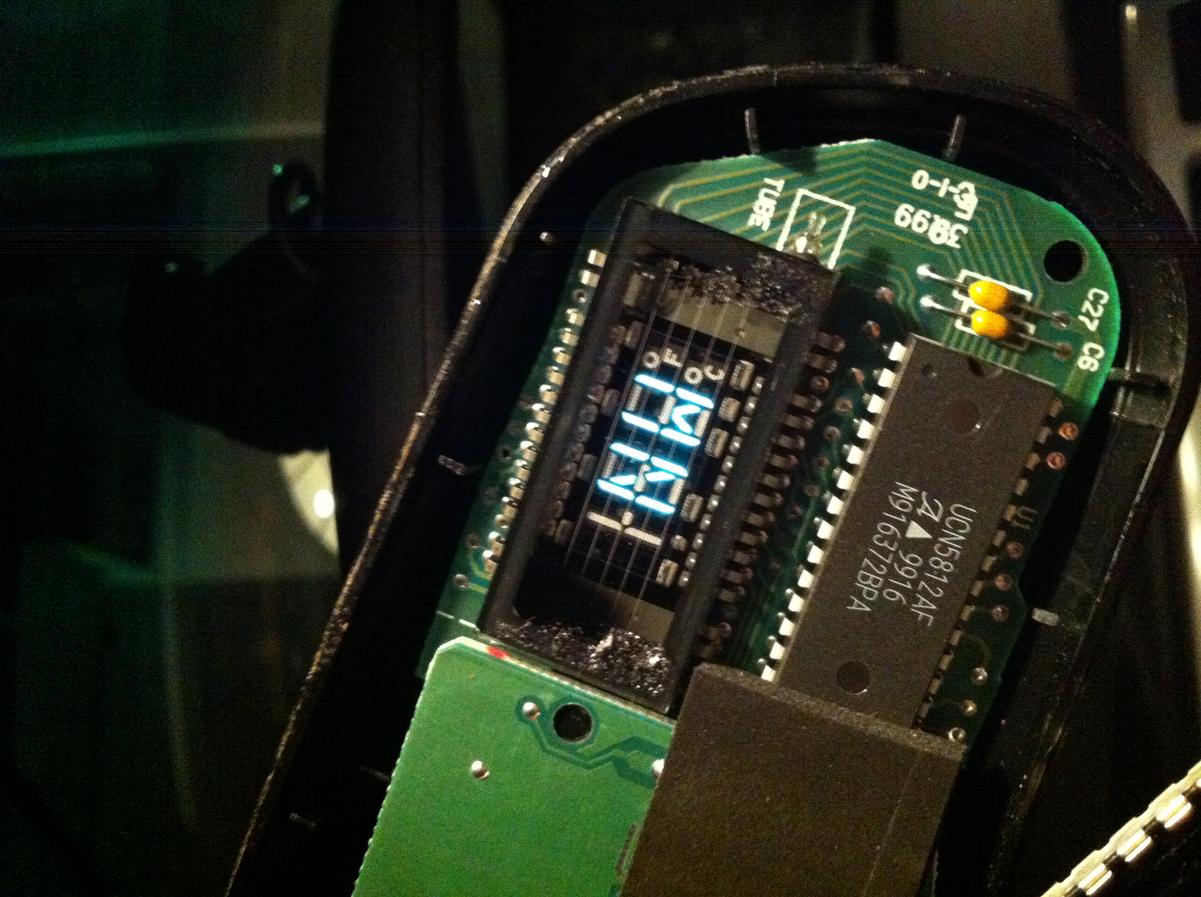

I have a few questions about how you changed the display color to amber. I removed the thin blue piece of glass that was over the display and put a piece of amber tint film over but it did not have much effect in changing the color. The color changed from a blue-green to a more bright-green. You think I need to find a thicker piece of amber plastic rather than the tint film. I will attach a pic of the display without any plastic/glass.
