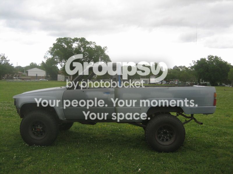

There is a pick from airdreams with the ome mediums with no front lift, and then the omes with frint bjs. Seems the springs give 4 to 5" of lift, which is a lot of lift.
I found another one on yotatech. Stock IFS and the OME medium in the back with the overload leaf removed.

Ohhhhh that's Alex's truck! Yeah he has a pretty cool youtube site with how tos and repairs on his 4runner. I forgot he pulled the front ball joint spacers due to constant lower ball joint failures.
Those are good pics.
I know the truck is gutted but that is crazy high compared to the rear IMO. Also, now you know that you should get a 4 degree shim plate for the rear axle to fix a drive line vibration. (He posted that in his build when he installed the OME medium duty springs).
