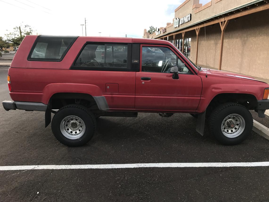

The Land Cruiser is down with a pesky misfire. The family has a planned snow vacation next week. The 4Runner has street tires. The PO included a set of 15" American Racing Wheels when I bought it. They aren't my first choice, but then again they are what I have. I found a set if inexpensive Goodyear Wranglers. They should do much better especially with all that 80's mojo.

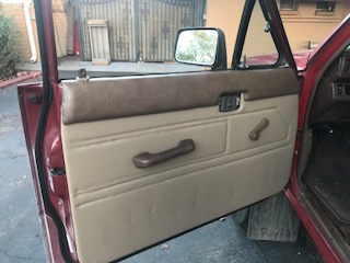

Sooooo, to keep some semblance of forward progress I moved to the interior. My 4Runner is a DLX model with the 3/4 door cards. They are in good shape, but the asshat PO put some sort of weird outdoor carpet additions that were tek screwed on. Plus the DS door is a replacement from a full door card SR5 that had a speaker cut out. Door cards on eBay are made of gold and bitcoin so I decided to make my own.
They turned out well I think. They are not perfect, but not bad for a first go.
Details for how I did it can be found here
