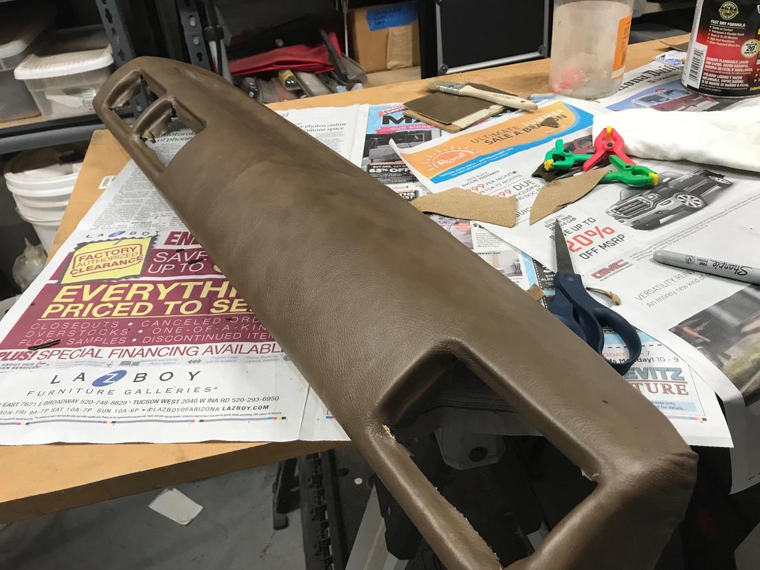

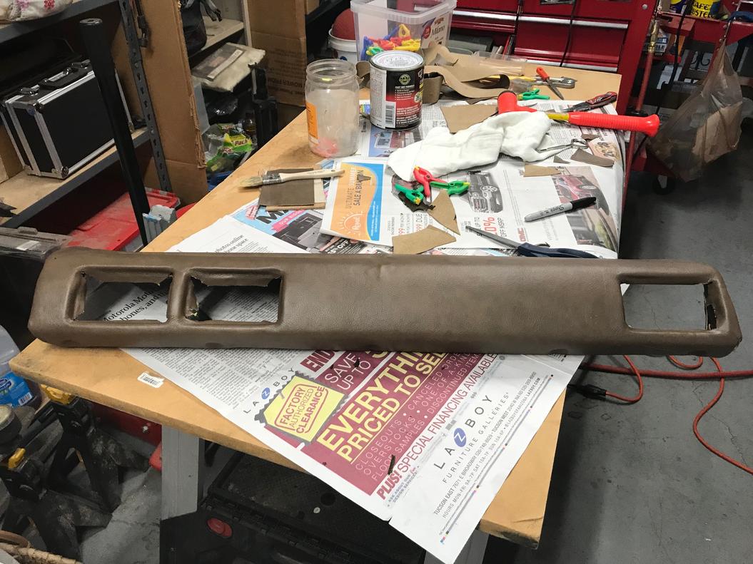

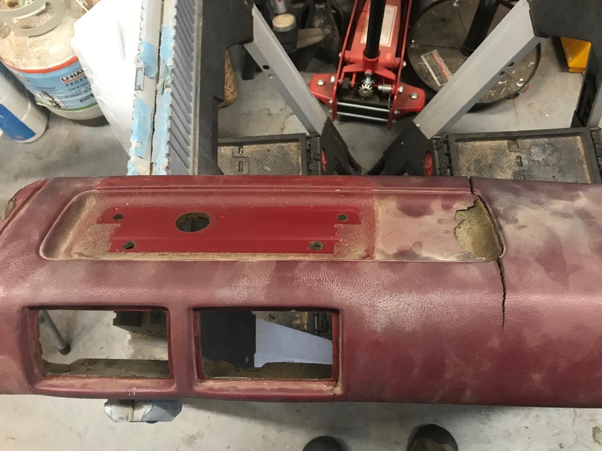

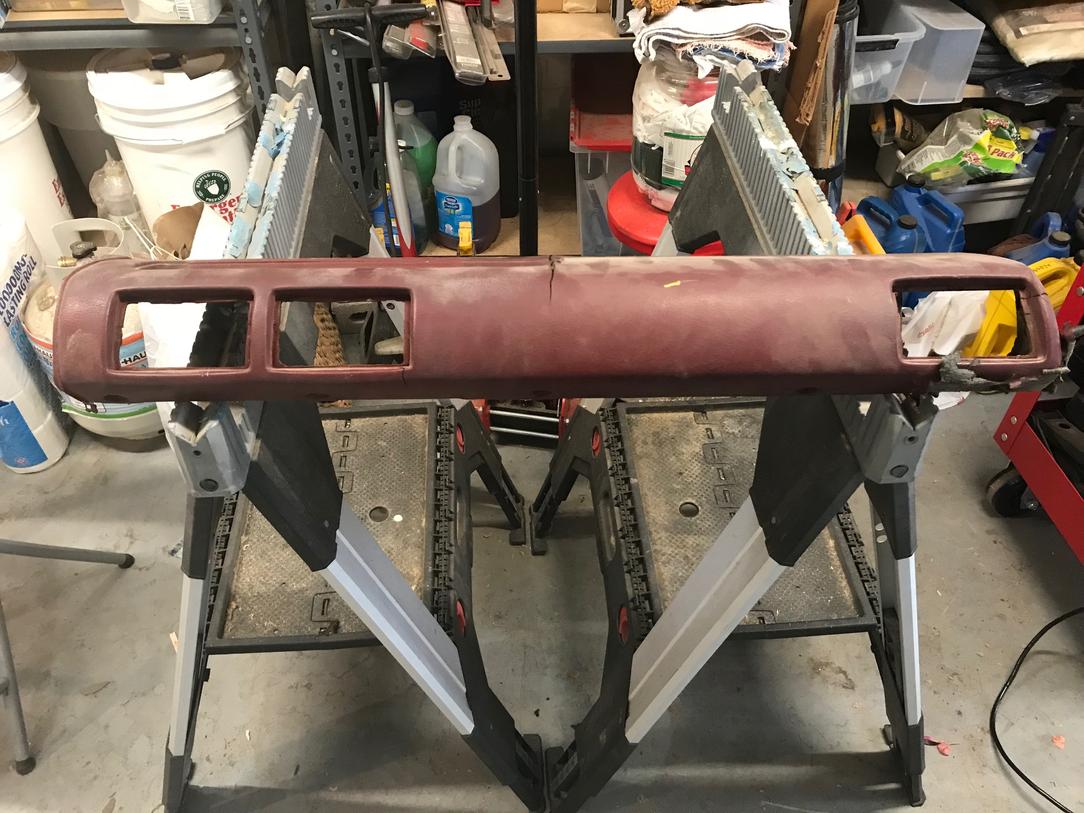

I took a stab at recovering a dash. I learned some things and haven't decided if this one is good enough or to try again. I have enough vinyl and I think I can do better or find someway to camouflage my crack repair. The details can be found here.
You can see what I started with and how it turned out. My crack repair shows through the vinyl. I really thought the vinyl would cover it up. I wish I'd spent more time evening the edges. Live and learn.
Not bad, GeoRoss!
That's how I plan to restore mine, too, but been too busy with more functional projects - LOL!
To further smooth out imperfection, I'm considering:
1) Doing dry-fit. Wrap with vinyl, stitch edges in back to opposite edges with thread or cord - something I can adjust tightness of. Don;t cut vent opening, yet. Stitched cord through center of vinyl in vent opening, and stretch back. Expose to sun so whatever stretches gets tightened and vinyl would be shaped closer to the foam).
2) When you're happy, pad the whole thing with 1/8-inch ensolite - same stuff used for sound insulation (different from vibration dampening). Found some at good fabric / upholstery stores.
This would give the dash a plush feel.
3) Repeat (1), then when you're happy finish it up.

Those are all good ideas. I didn't want to add any padding to avoid bulking things up for fitment. I think I can just put my cellphone mount on the offending repair and it won't be noticeable.
I watched this guy's videos to learn some techniques. https://www.youtube.com/user/Cechaflo
I am really surprised at how well they worked. It is pretty simple, but does take patience. I started by glueing a 4 cm patch along the entire long axis of the dash just above the transition to horizontal above the vents. From there I glued in sections, from transition to transition so I could form to each bend. This whole time you stretch and form. I had a heat gun ready, but found it not really necessary. The vents were surprisingly easy. The depression on the top was a PITA. This is because I tried to do it all at once. Had I divided it up it would have been easier. Most of the edges were simple. The most complex was the getting the vertical section on the PS done. The way I did it is fine and none of the seams will be visible once installed, but I could have done in cleaner looking back.
