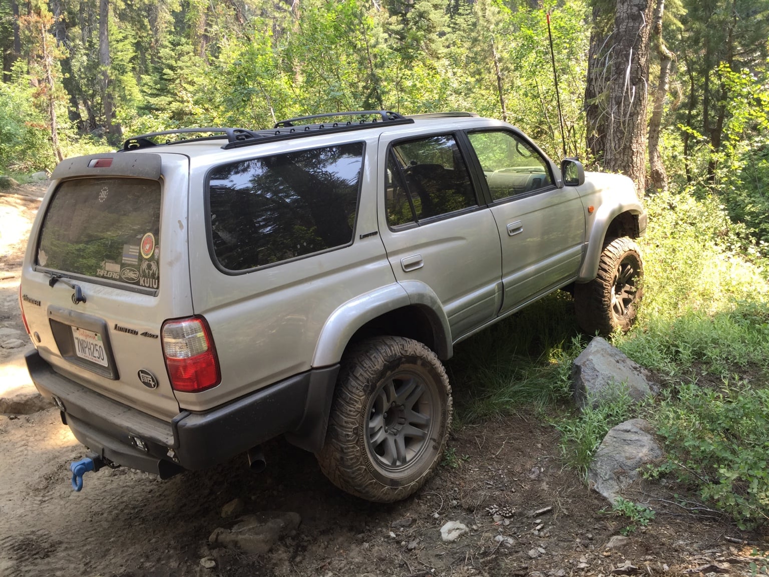

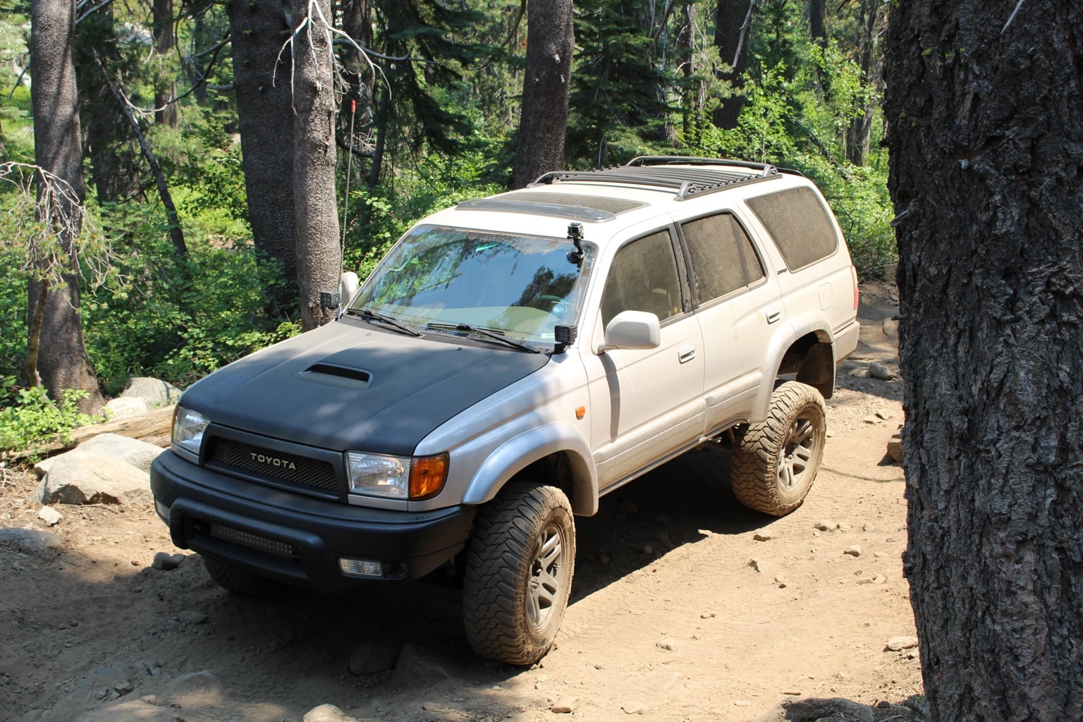

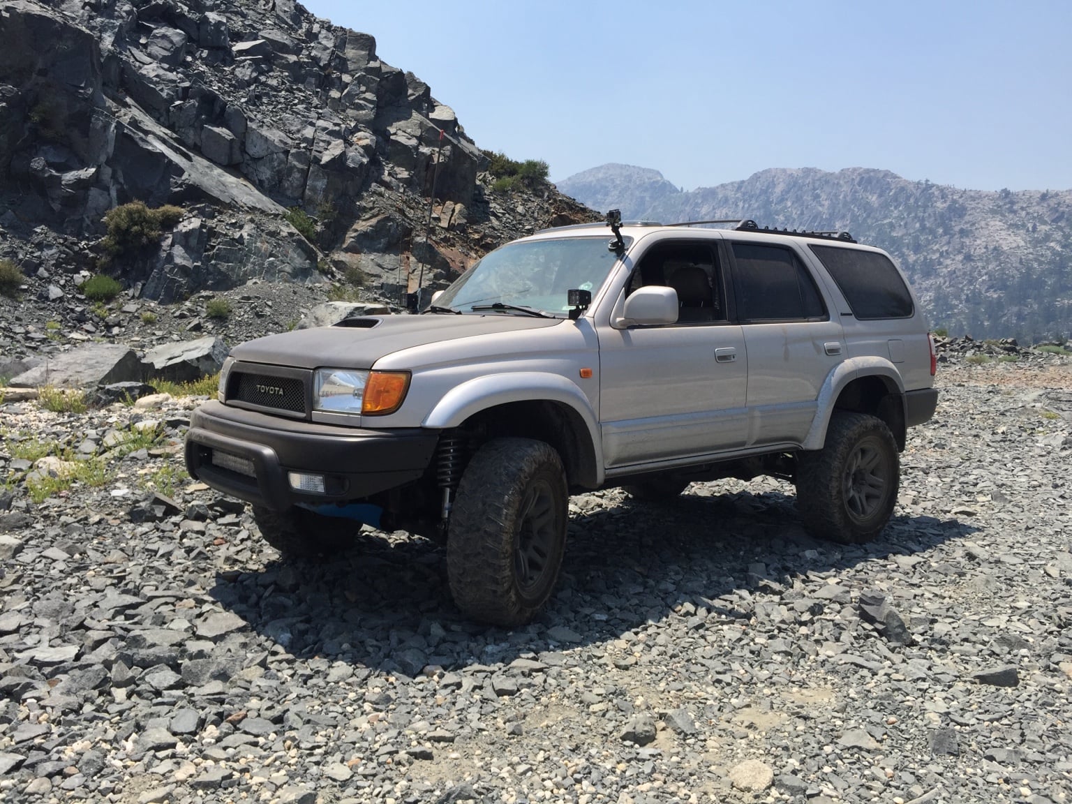

Went with a buddy and my Boyz to Fordyce Lake. Took Fordyce Road out of the Cisco Grove campsite. Great little half day trip to pop my runners cherry. I shall name thee, Rhodesoda!
Super smoky cause of the fires so not many pics.
Had to pose for a pic incase we didn't make it out.
Made it to the dam...
Went as far as I could down the big boy trail. Smashed my new bottle opener on a rock.
this rock!
then we just parked to watch the big boys go by..
made it out alive... And the opener still works! [emoji322][emoji322][emoji322]
Oh thank god, that was about the only opener anyone had at the meet!

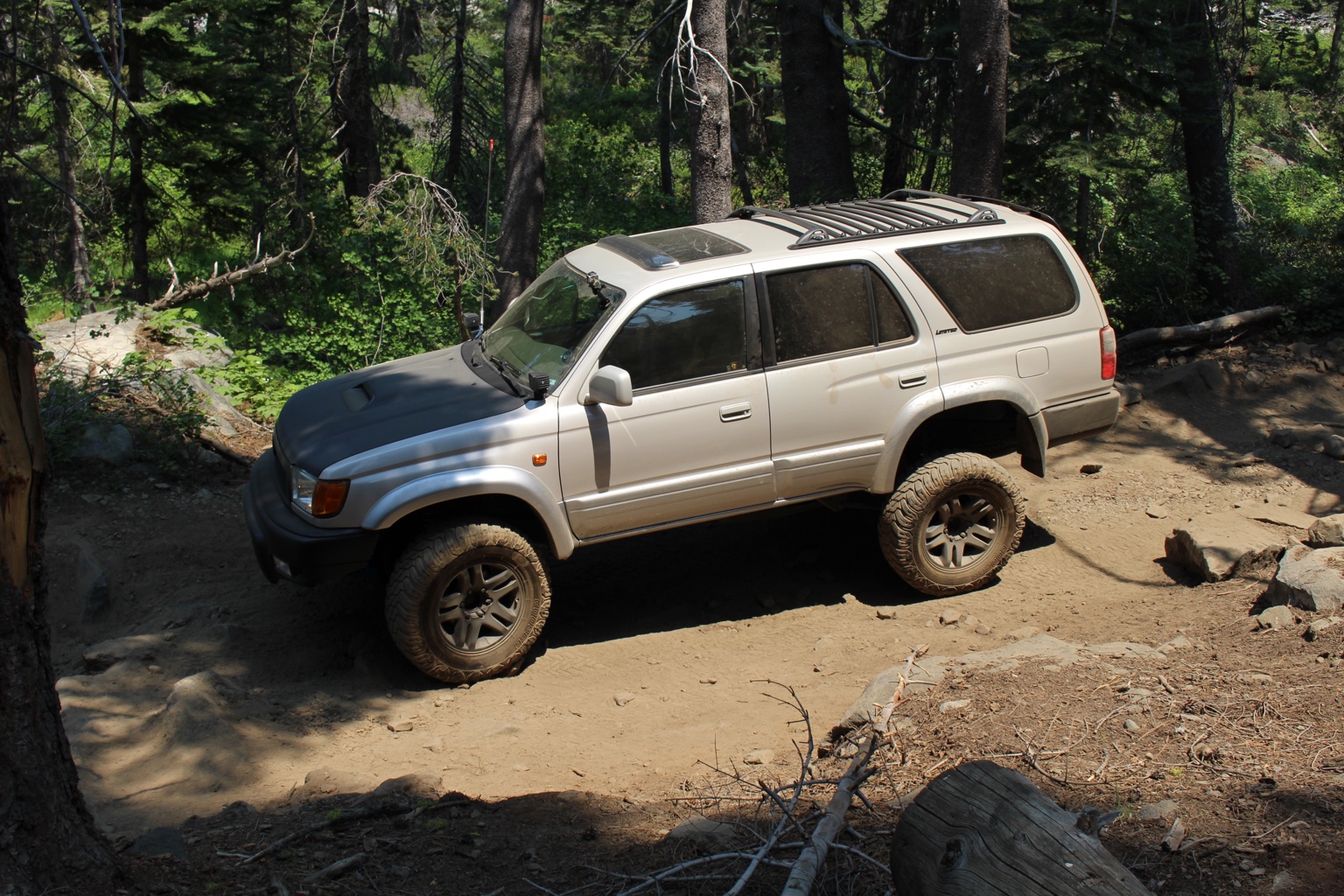

Did you get to see any of the winch hills?

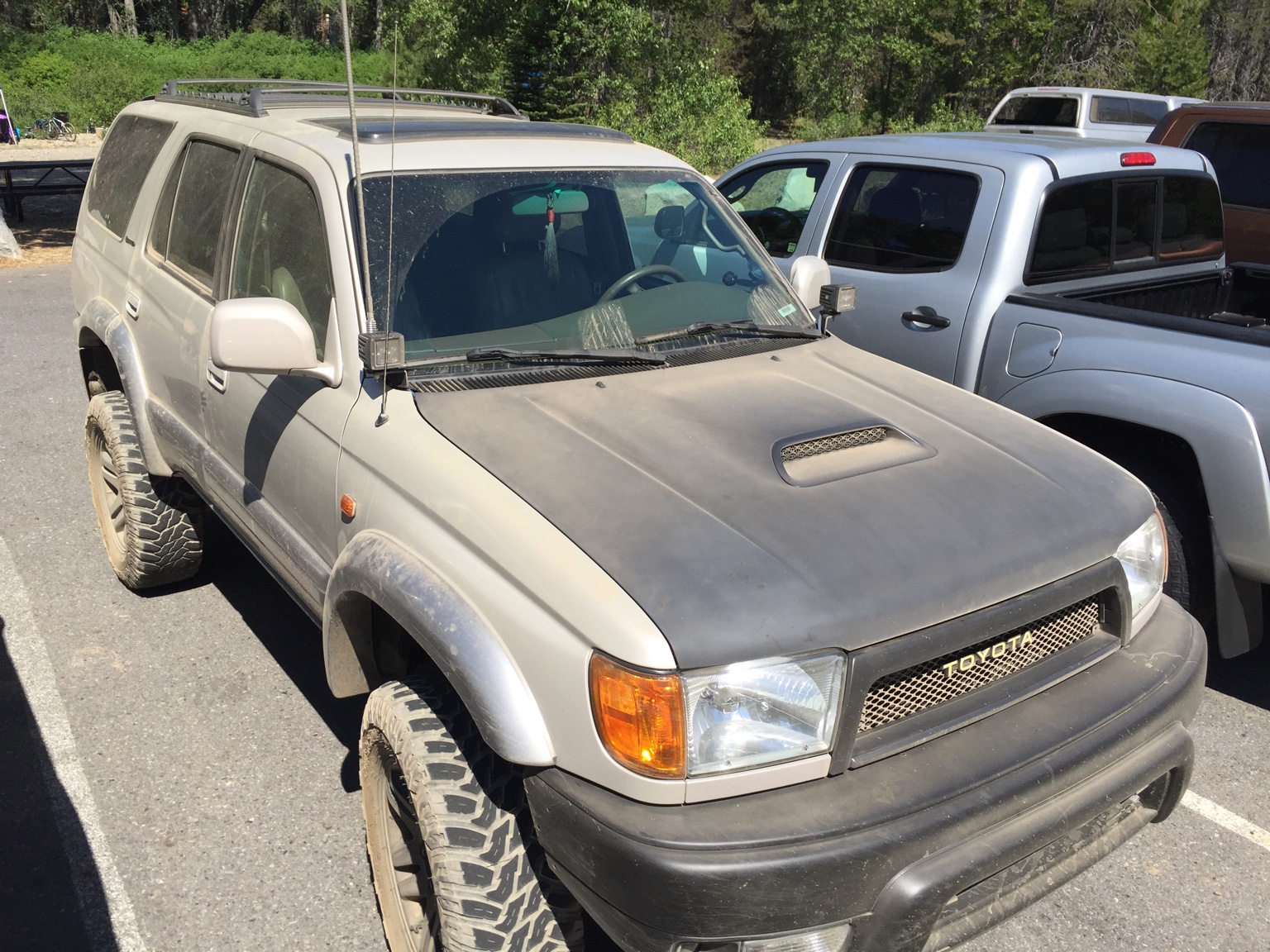

Made it about a mile done the trail off of Fordyce road. No sliders or skids so I didn't want to risk going any further. The shot with the buggy is about the area I turned around.

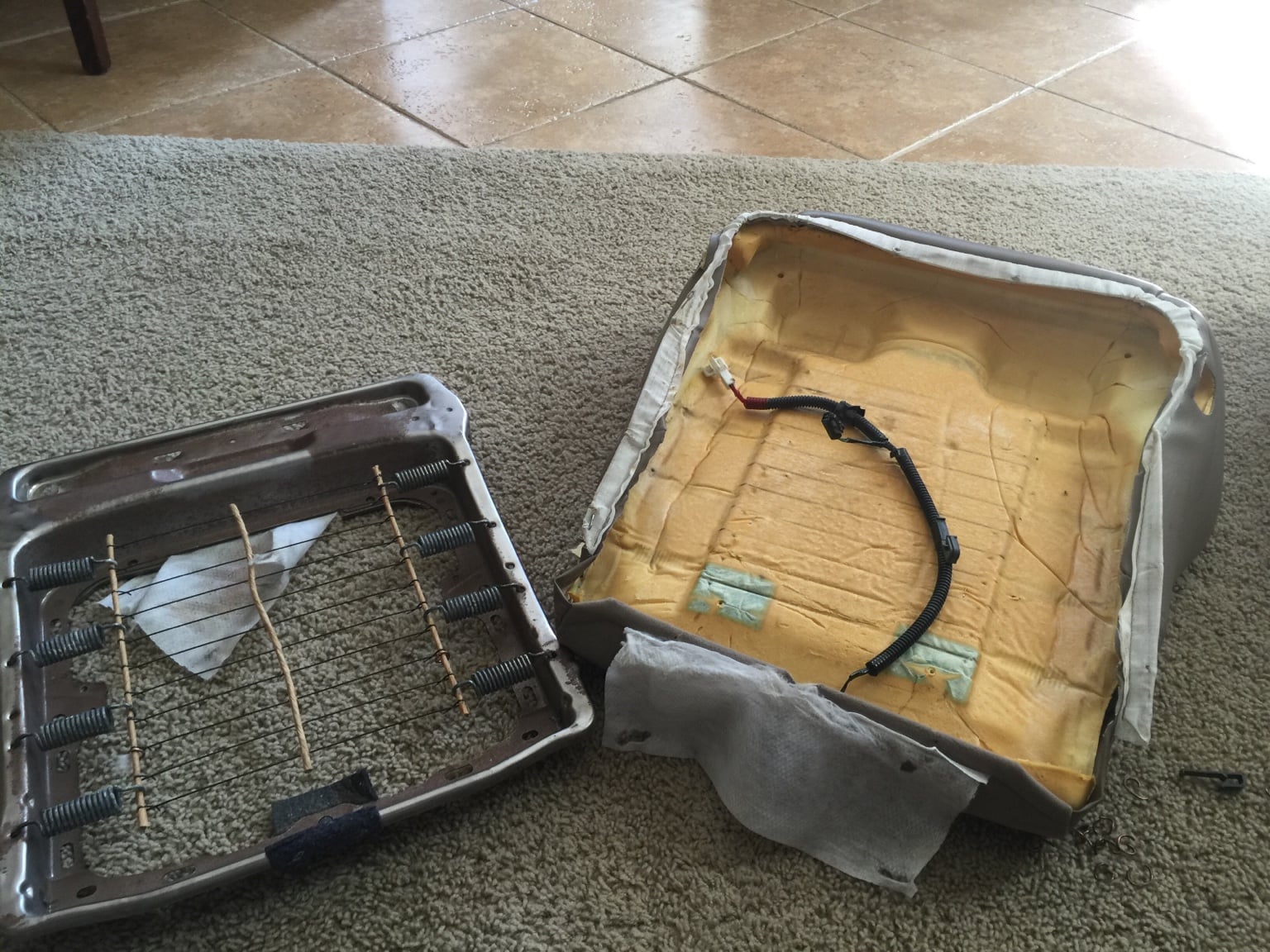

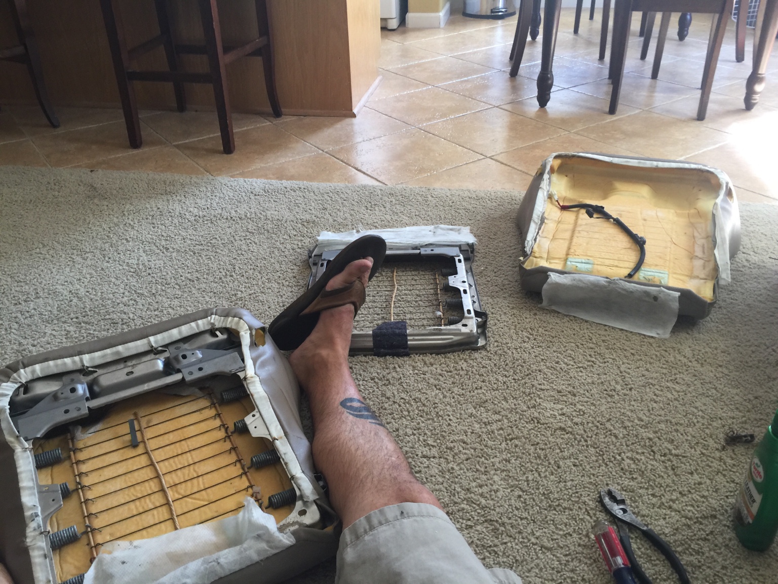

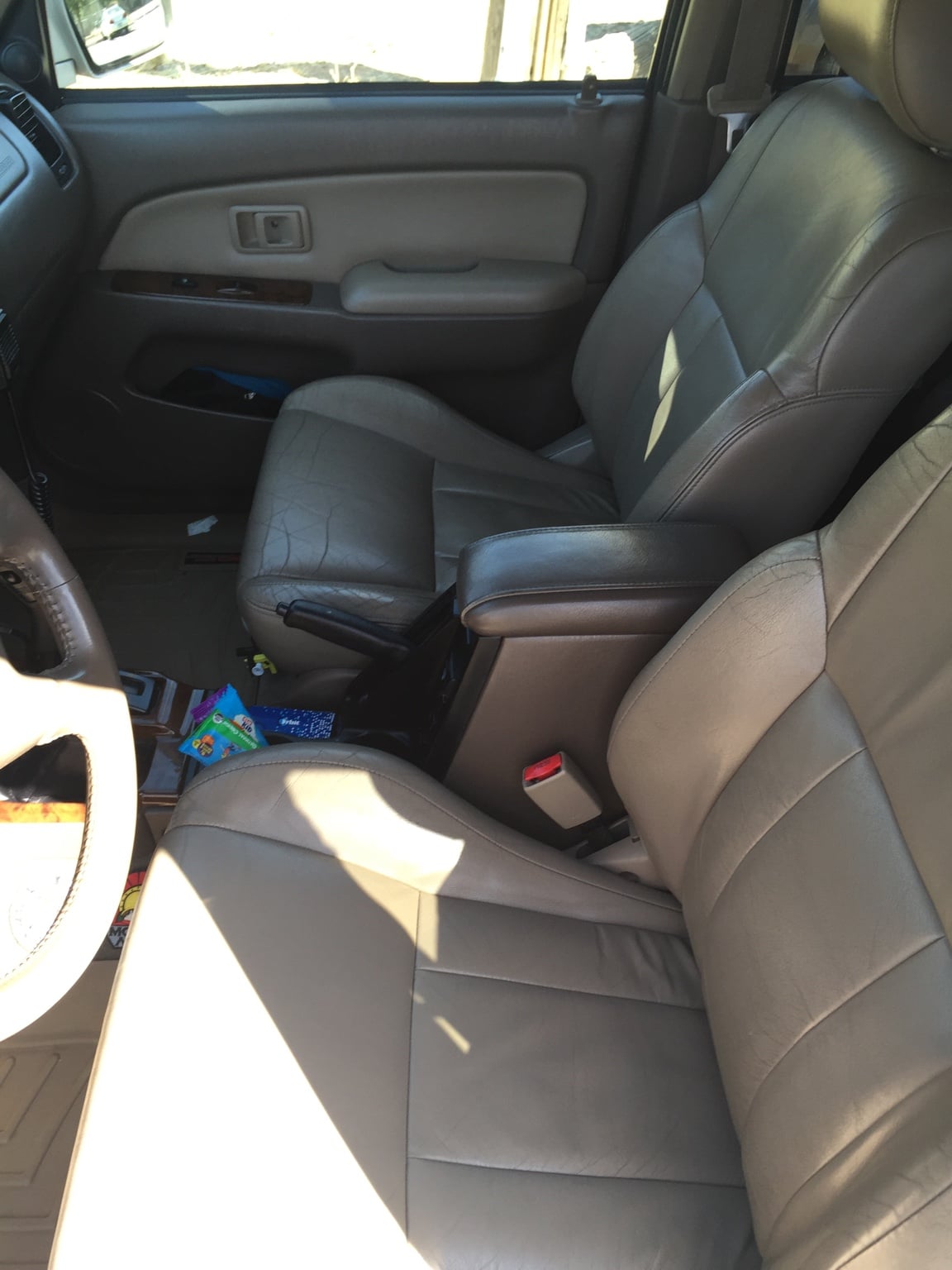

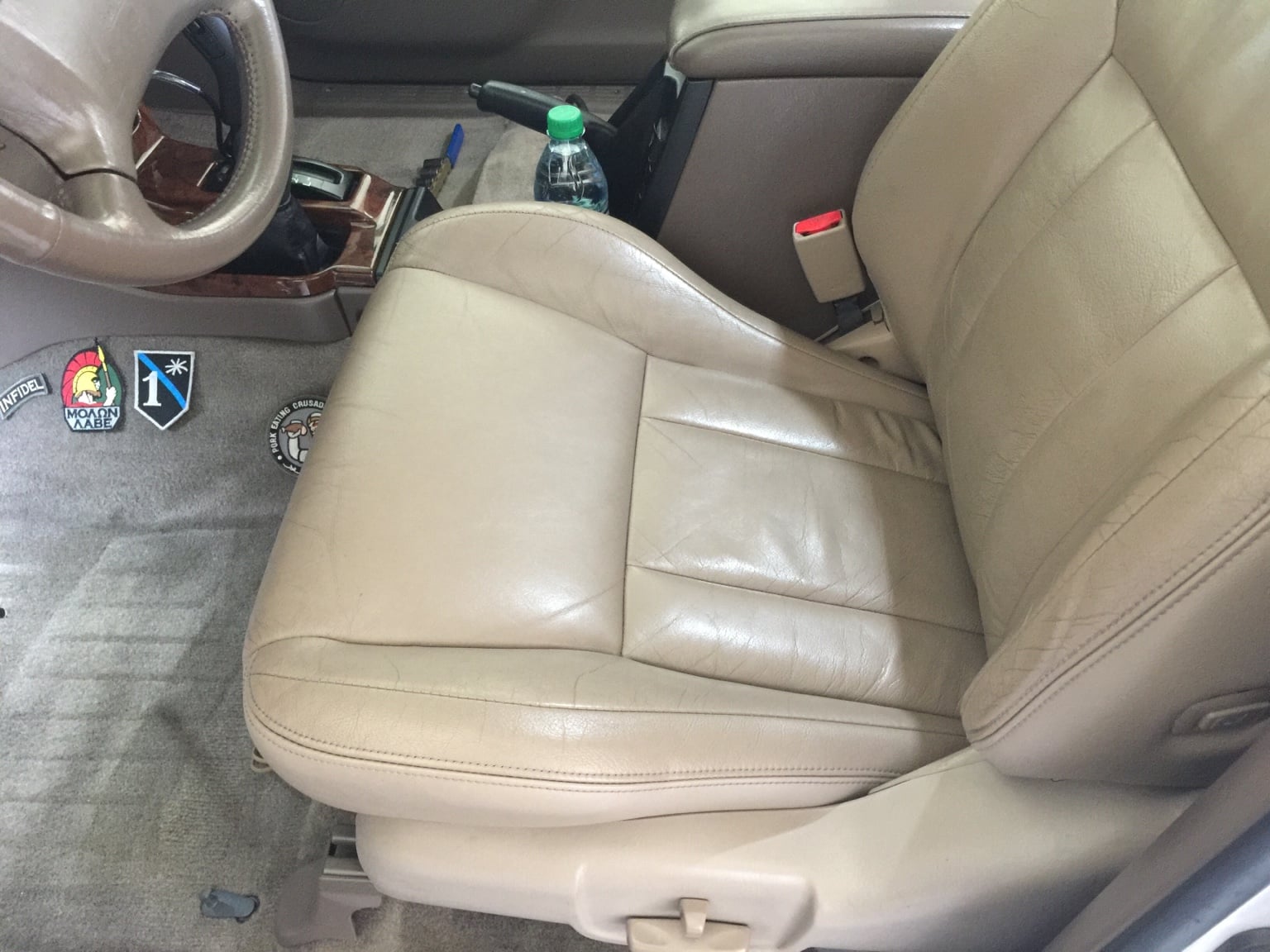

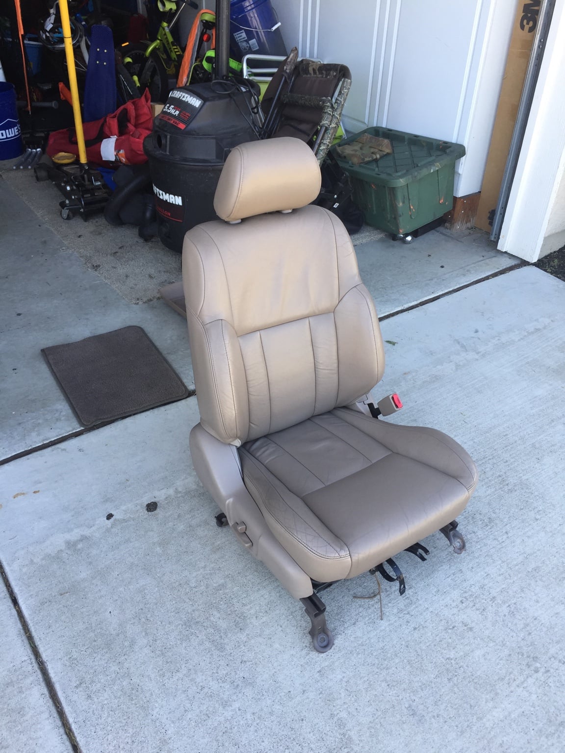

Swapped seat bottoms today. Very easy to do. Had to completely pull each cover though. The passenger side air bag weight sensor ruined my plans for a straight swap.
New Hog rings and hog ring pliers are a must for a clean and professional looking job.
4-14mm bolt to remove the seat
1- Phillips head screw on the port side plastic.
2- Phillips head screws on the starboard side plastic.
4-12mm bolt to remove the seat bottom
Wire cutters to remove old hog rings (only if you've got new ones)
There are 5 rods and 10 hog rings the hold the cover to the foam.
Reverse the process for the install.

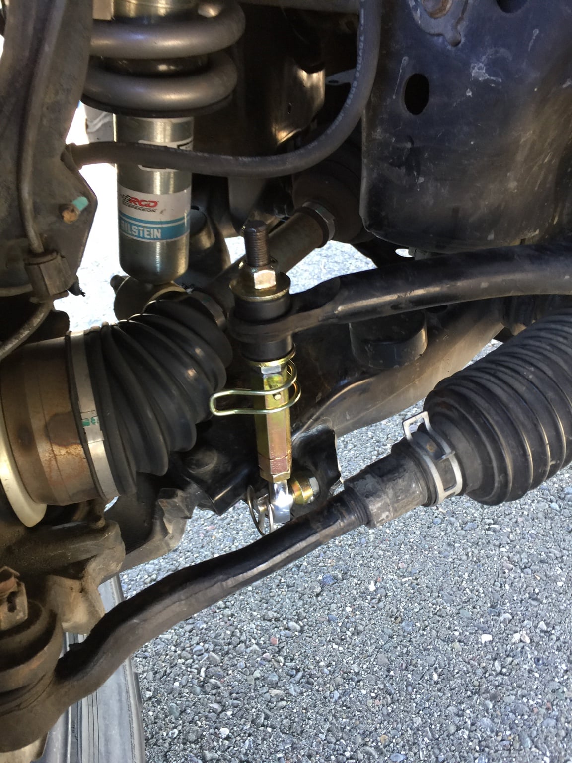

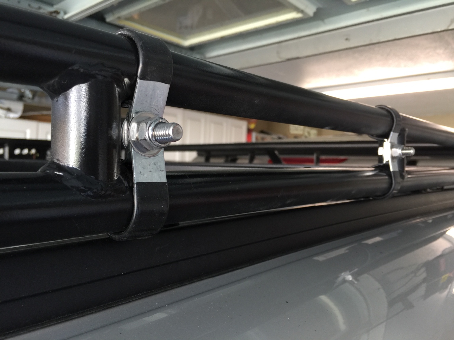

Just installed the double disco links by [MENTION=98153]MStudt[/MENTION].

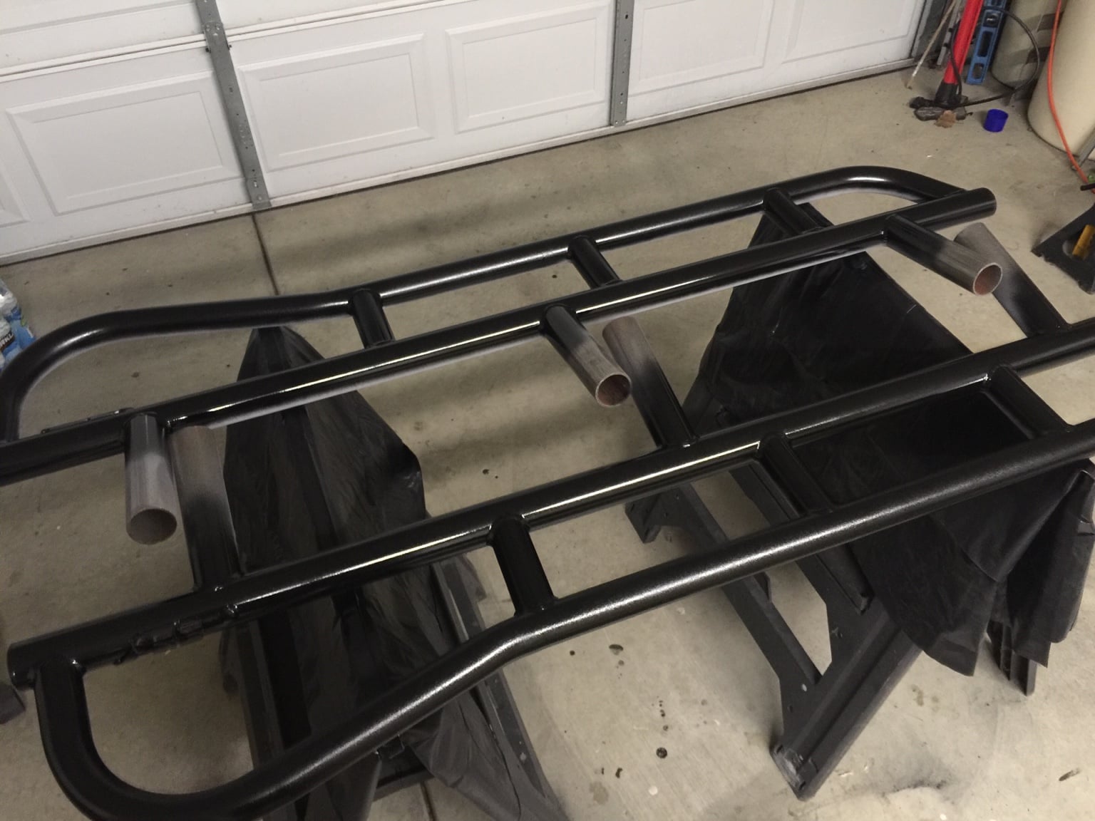

All Pro sliders will be mounted this week.
all primed and painted.
