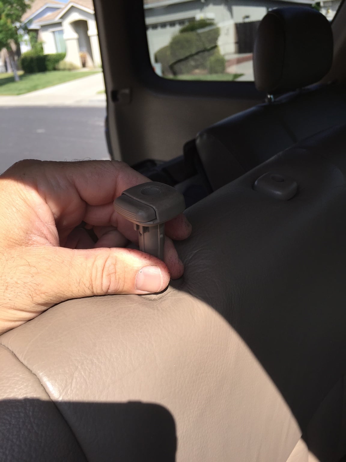

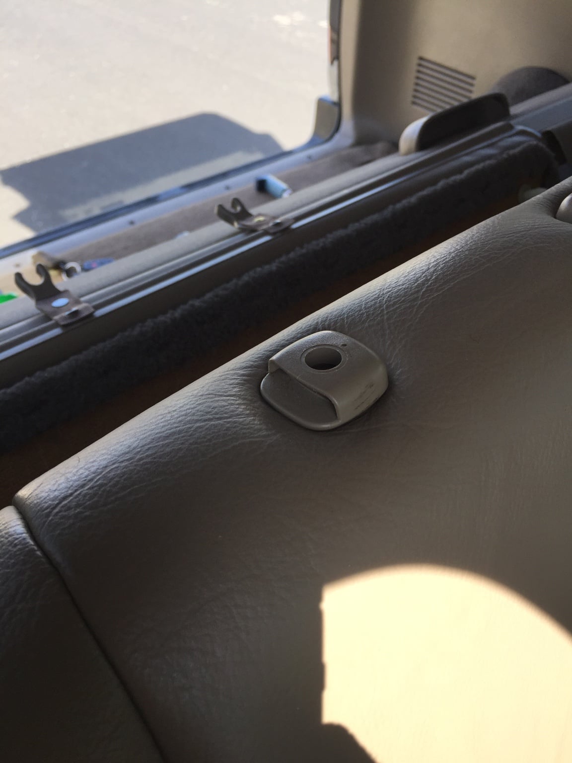

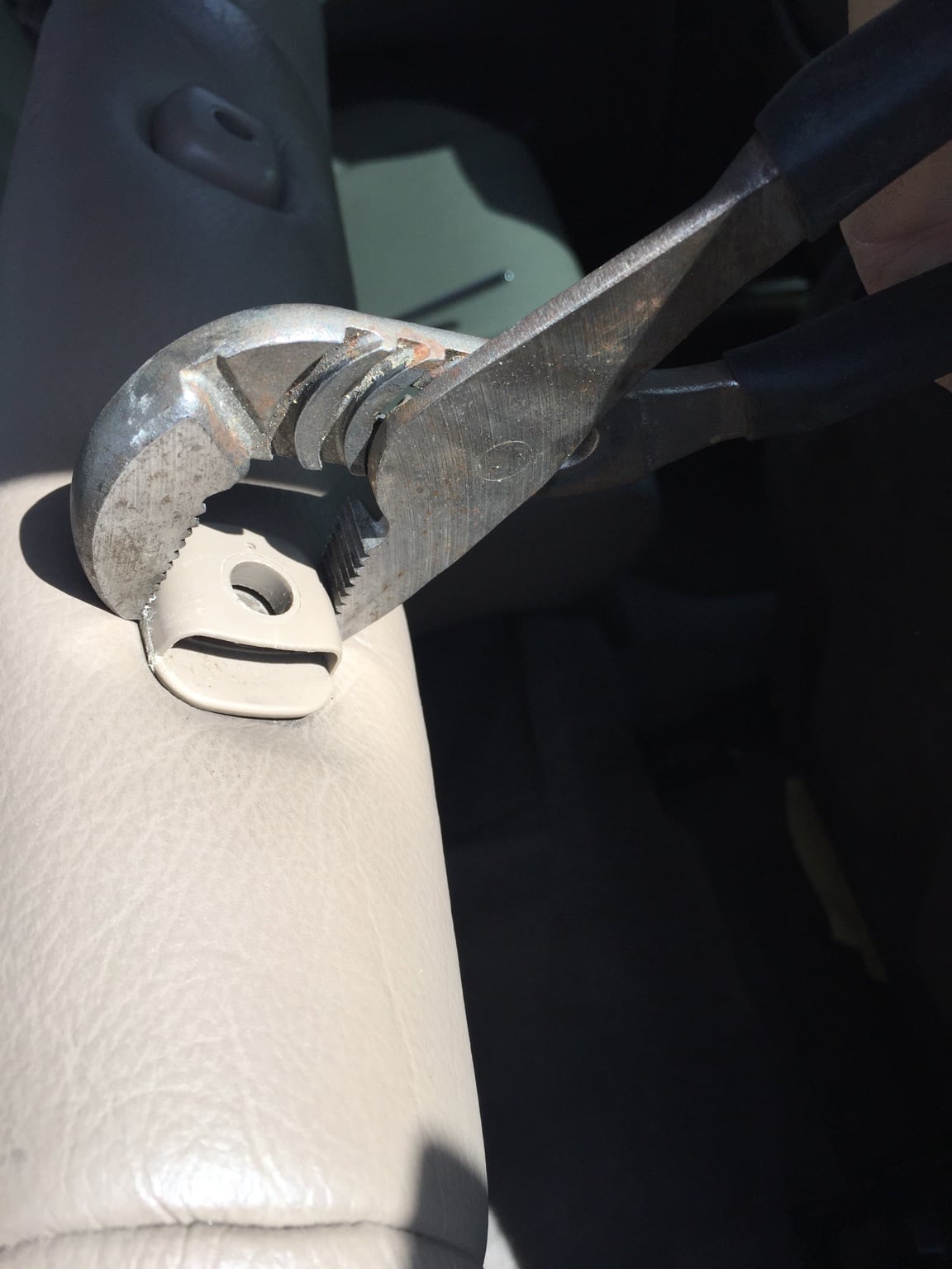

I had a bad rear passenger headrest retention chingadera go bad...
Channel locks and a quarter turn clockwise freed the old one.
The new one plugs right in... Just like brand new.

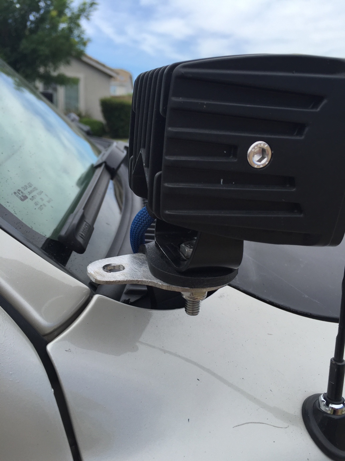

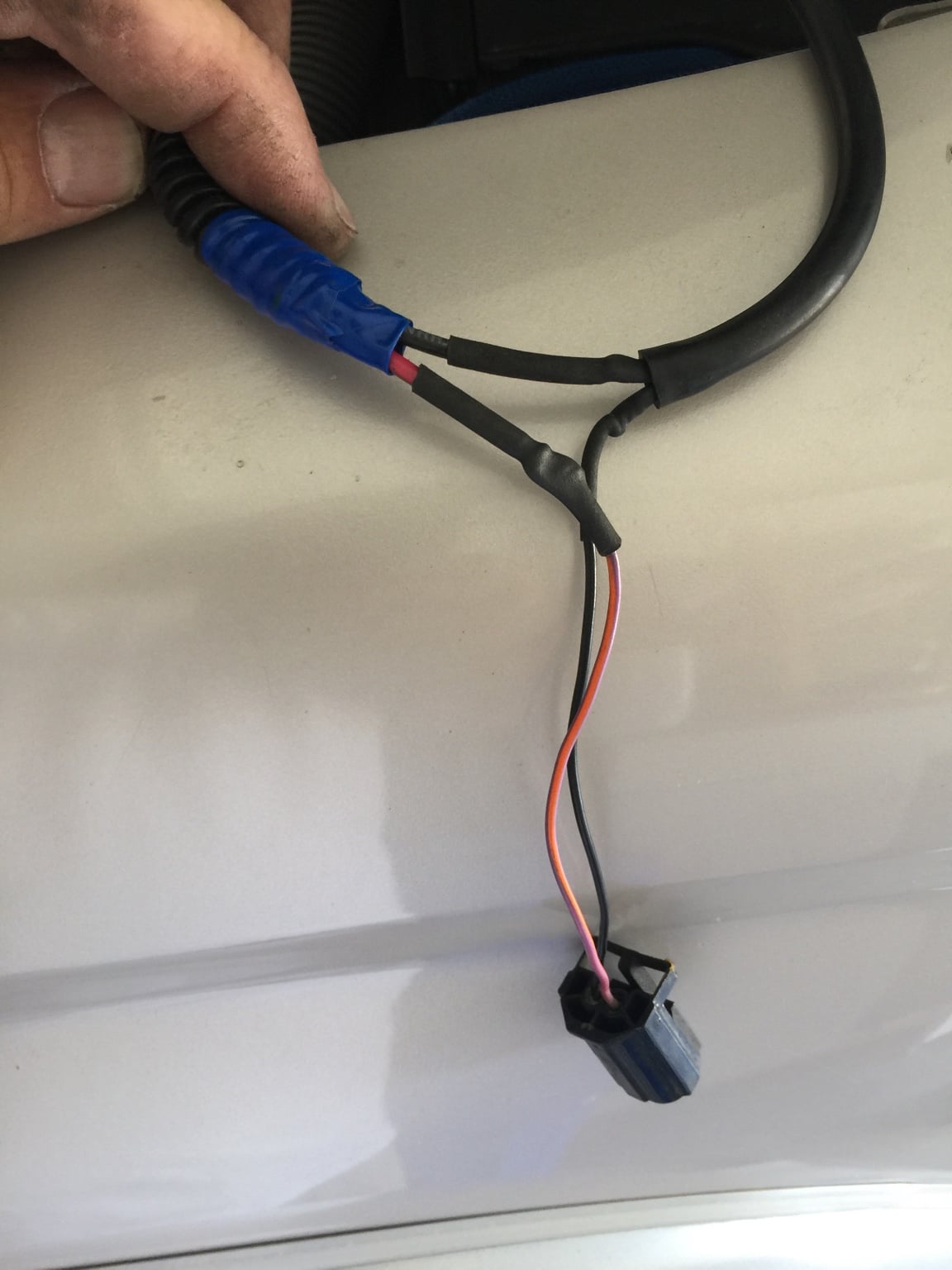

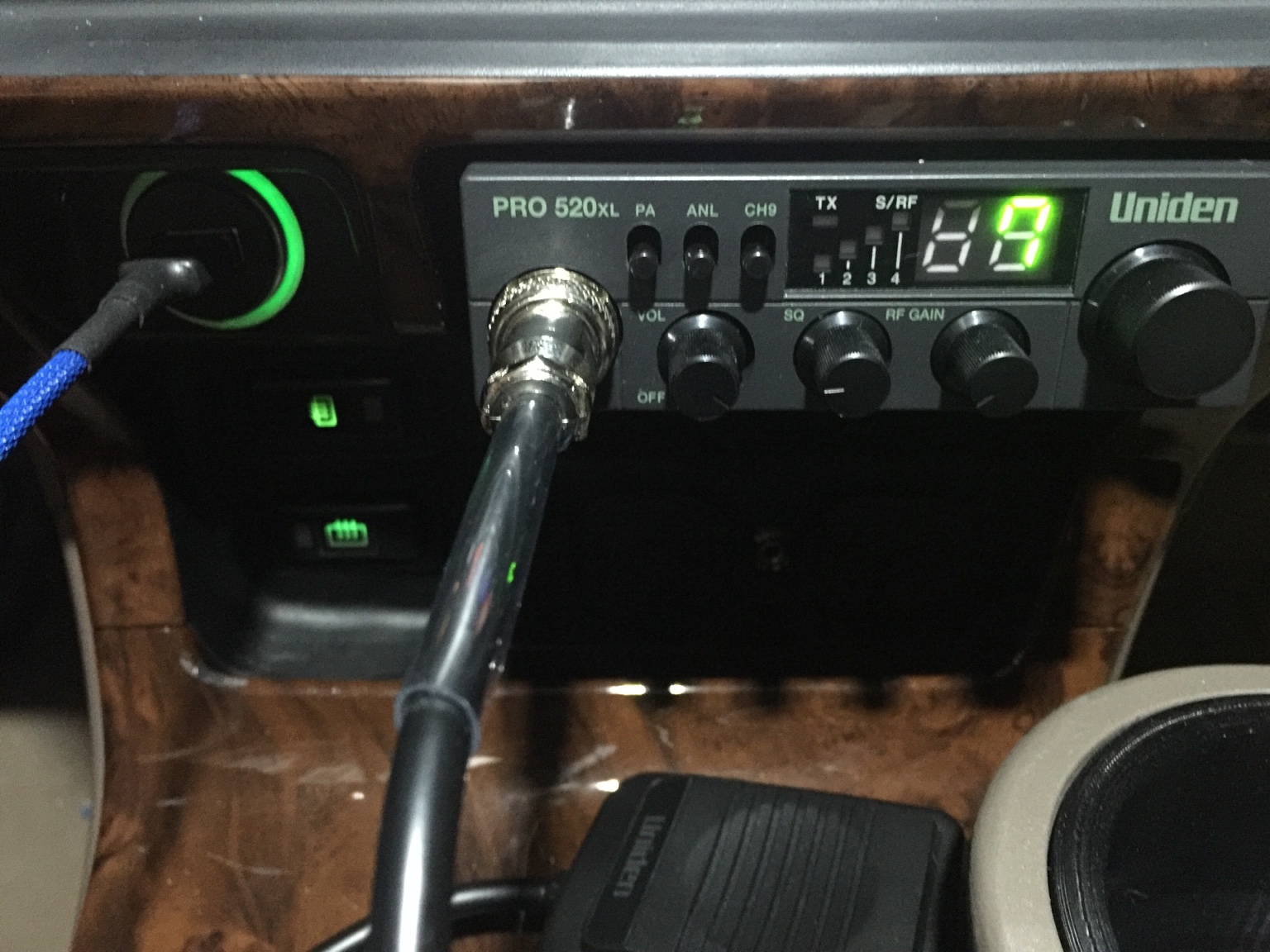

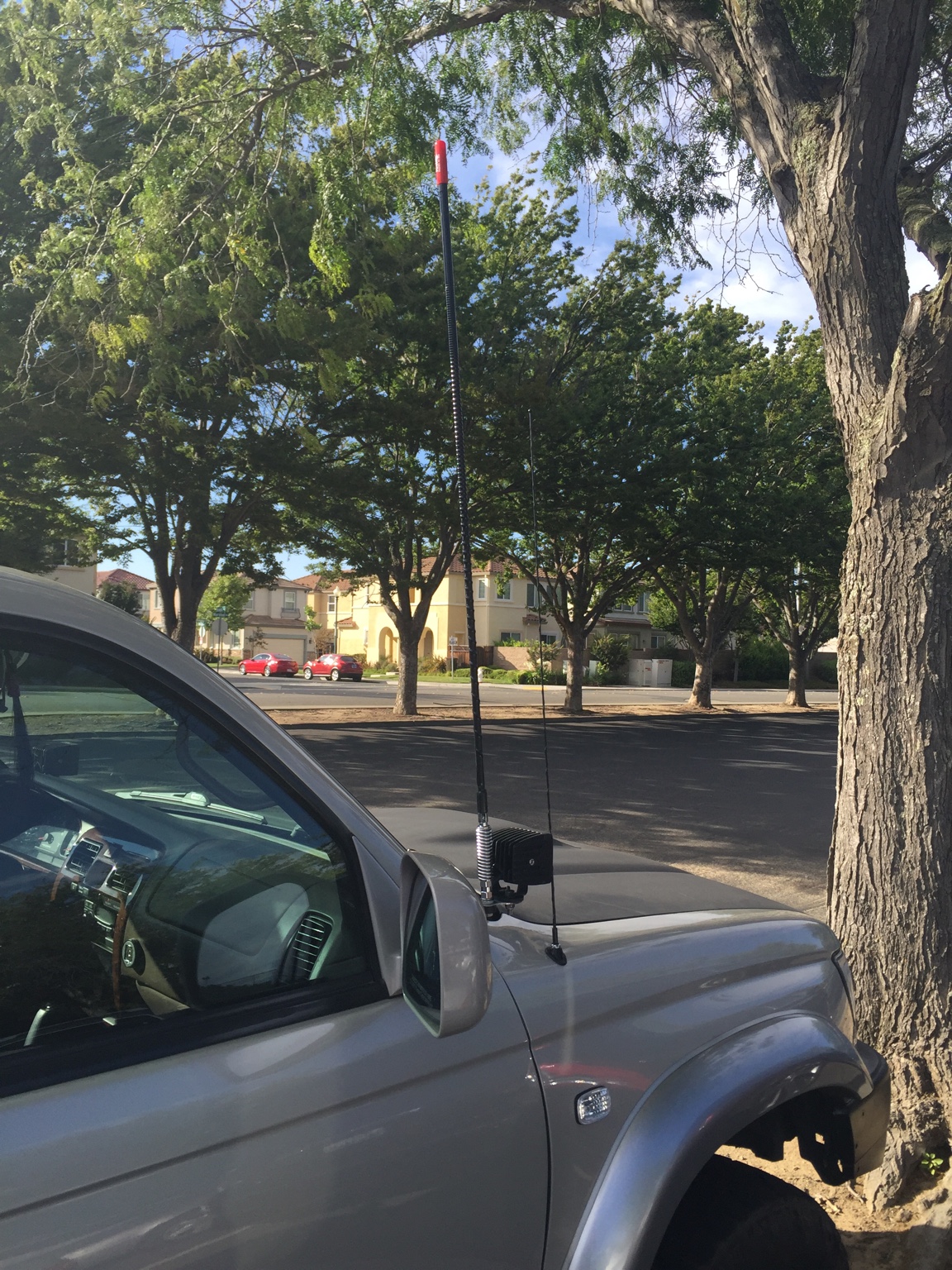

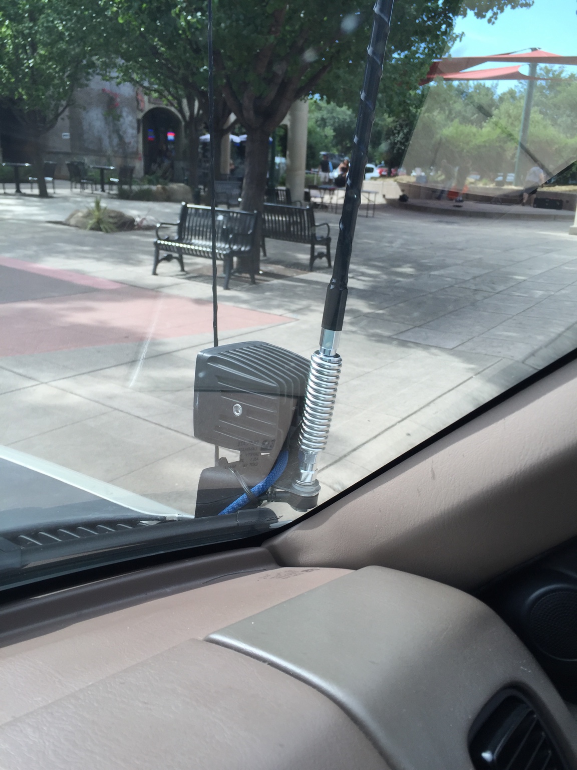

Just ordered a Uniden 520xl and 3' firestik. Going with the ashtray install for the CB and I'll DIY a bracket off my passenger side ditch light mount. Pics to follow.
Land Rover electronics, precision British engineering and craftsmanship, what could go wrong? :bounce:
Just joking that looks like a great mod! I will probably be copying this one!
CB installed. My buddy who's got his Hamm license and all the comm goodies will help me tune the Firestik II.
Fab up my own bracket with the provided SS bracket and an angle grinder.

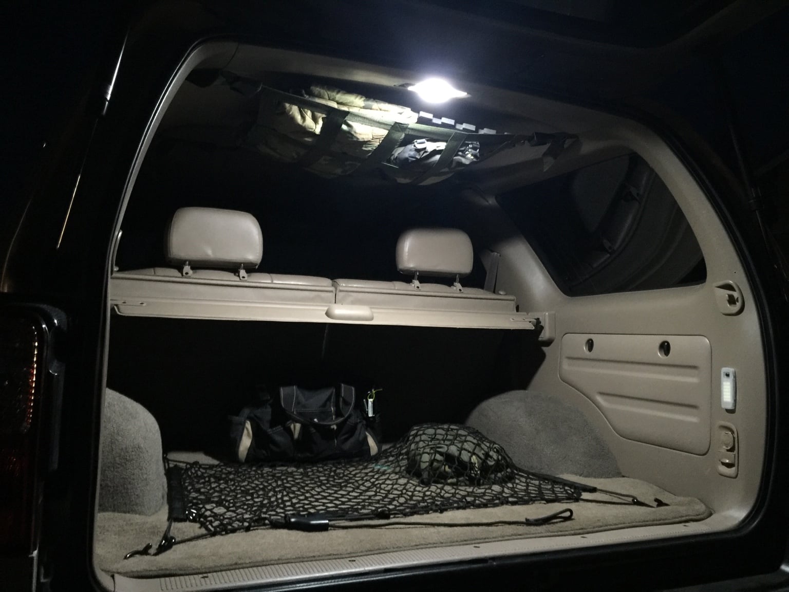

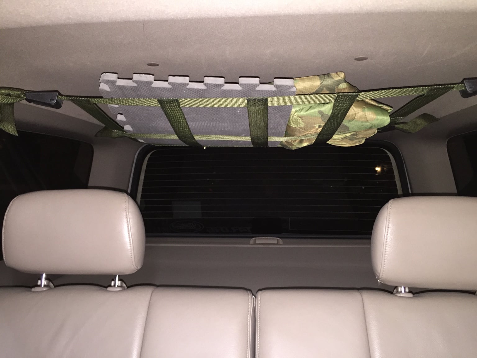

Always thought this was wasted space.

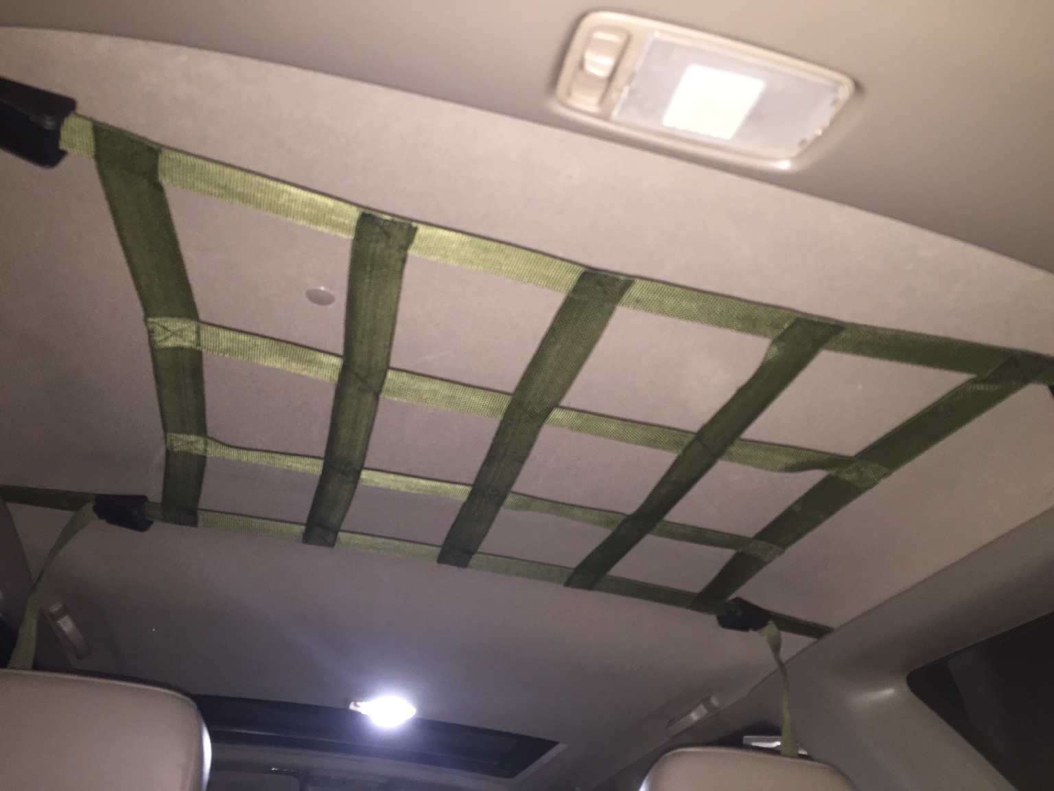

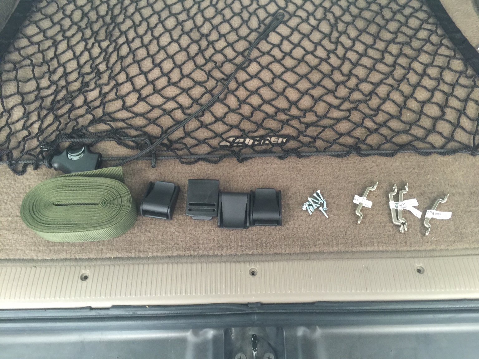

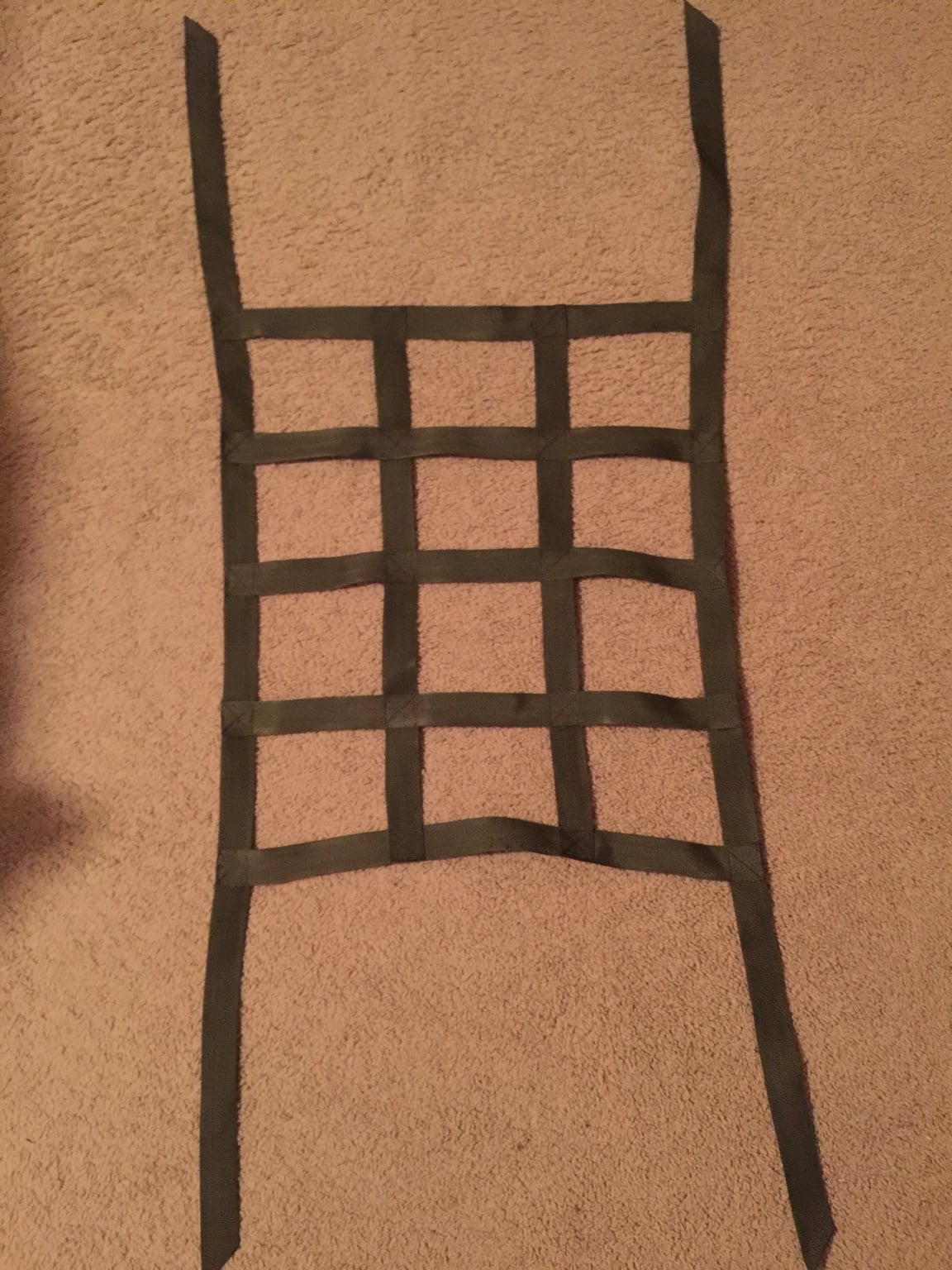

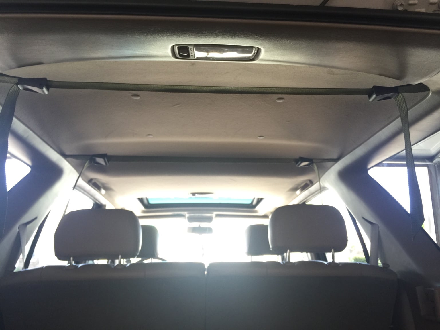

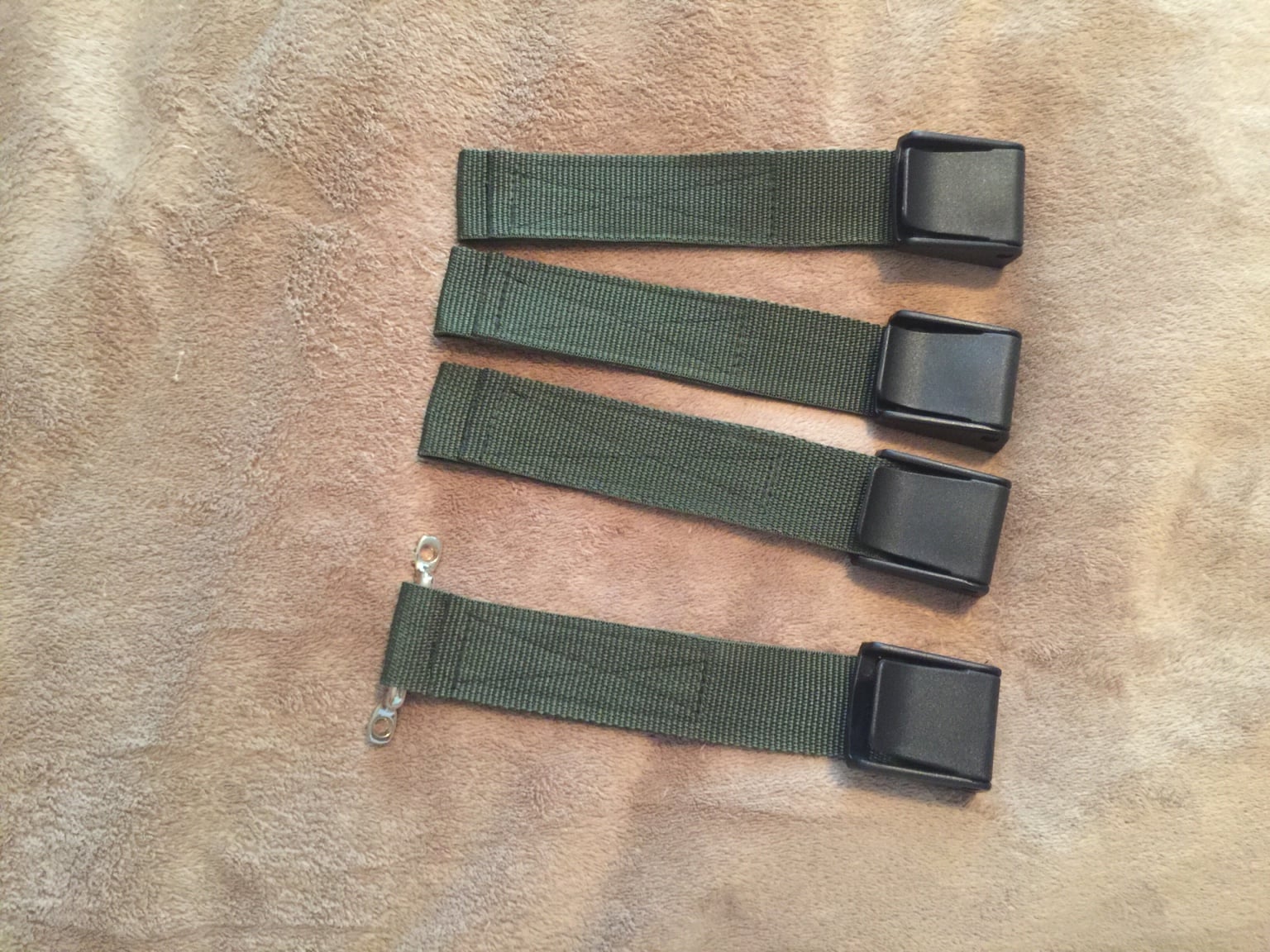

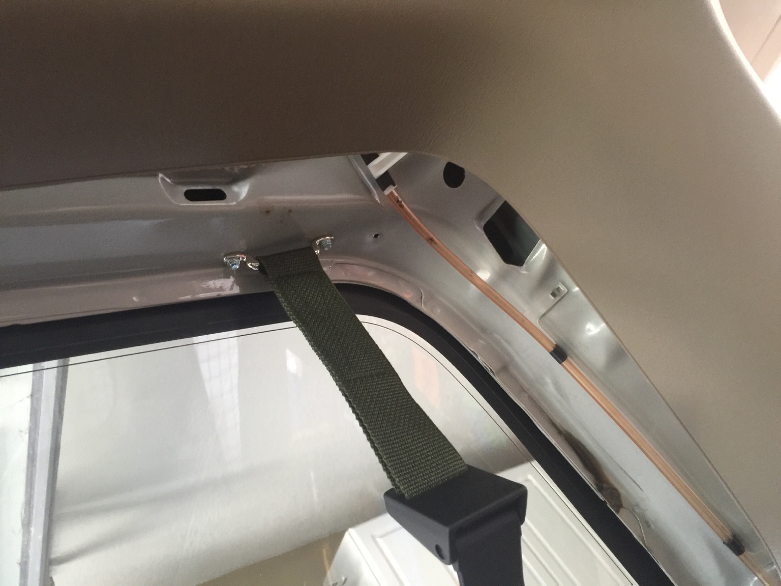

Saw a rear ceiling cargo net. Started search and saw they want $100+ and hated how they just screw it threw the plastic. So I thought shit, I got a sewing machine. Off to Ace to investigate and found exactly what I needed.
started with the straps, 9" total.
Pulled all the plastic and decided on where to mount them. 3/4" self drilling screws.

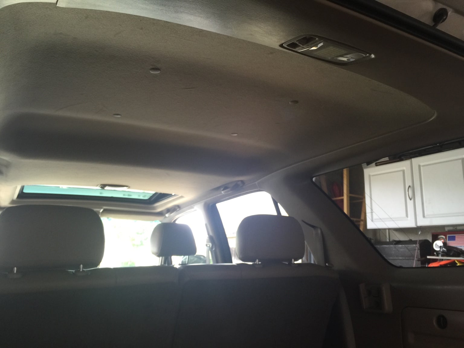

Put everything back together and started measuring.
View from the drivers seat looking back.
Still trying to figure it out. I don't think I'll get the clean look like yours with the lights I have. So I'll have to just go with the smaller or just run some led strips back there.

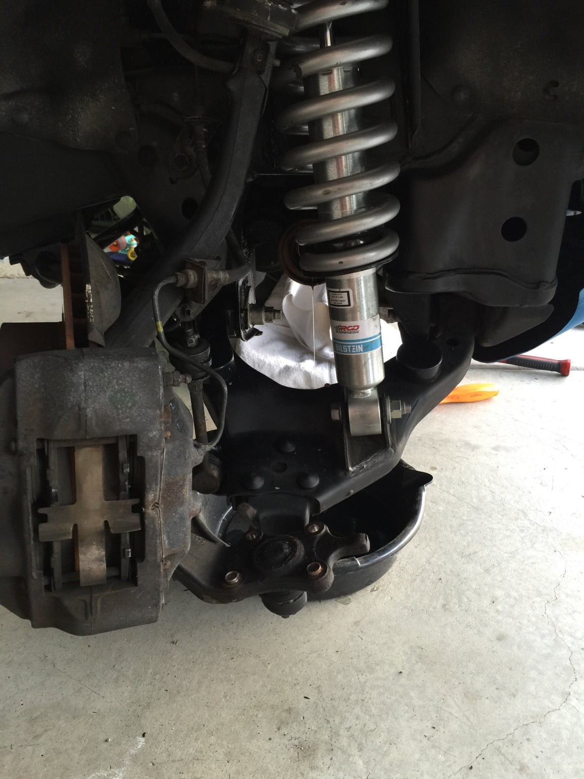

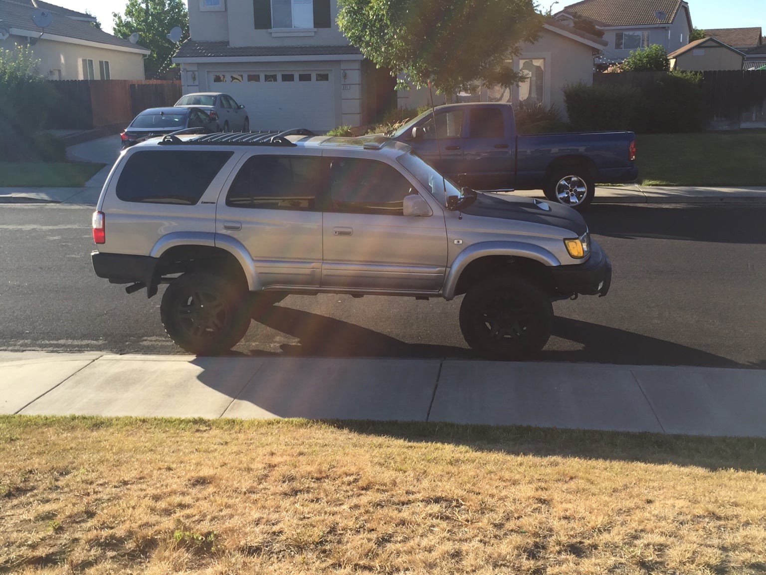

But, we had an issue with one of the front shocks...
Wheeler's was great and took care of it right away. Got the wheels and tires mounted... Had them installed so I felt like I got something done today.
Before
After

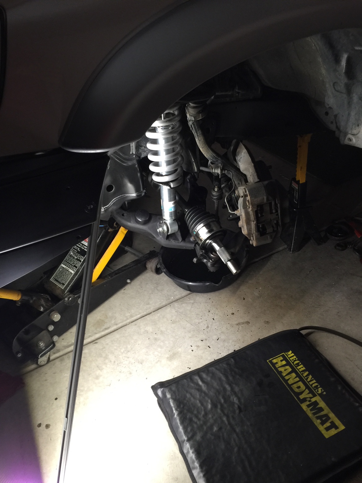

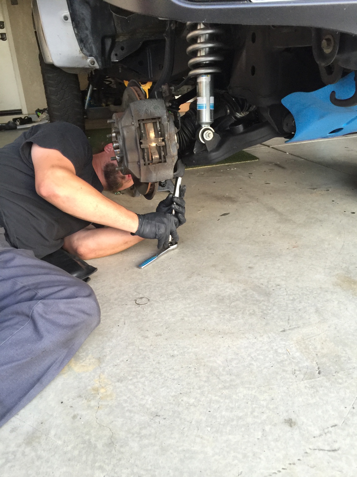

One strut assembled.
Diff drop too
Think I'll do all the sway bar rubber tomorrow.
One glamor shot...
Love the blue! You should make your Toyota emblem in the grill blue too! :)

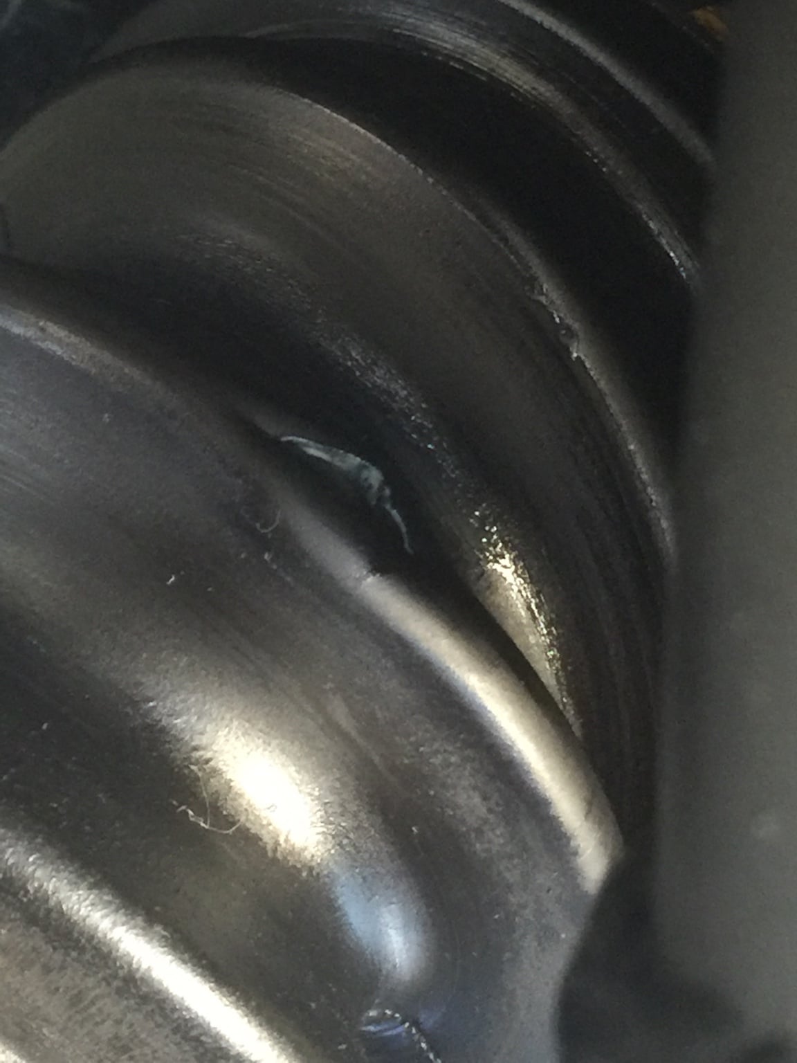

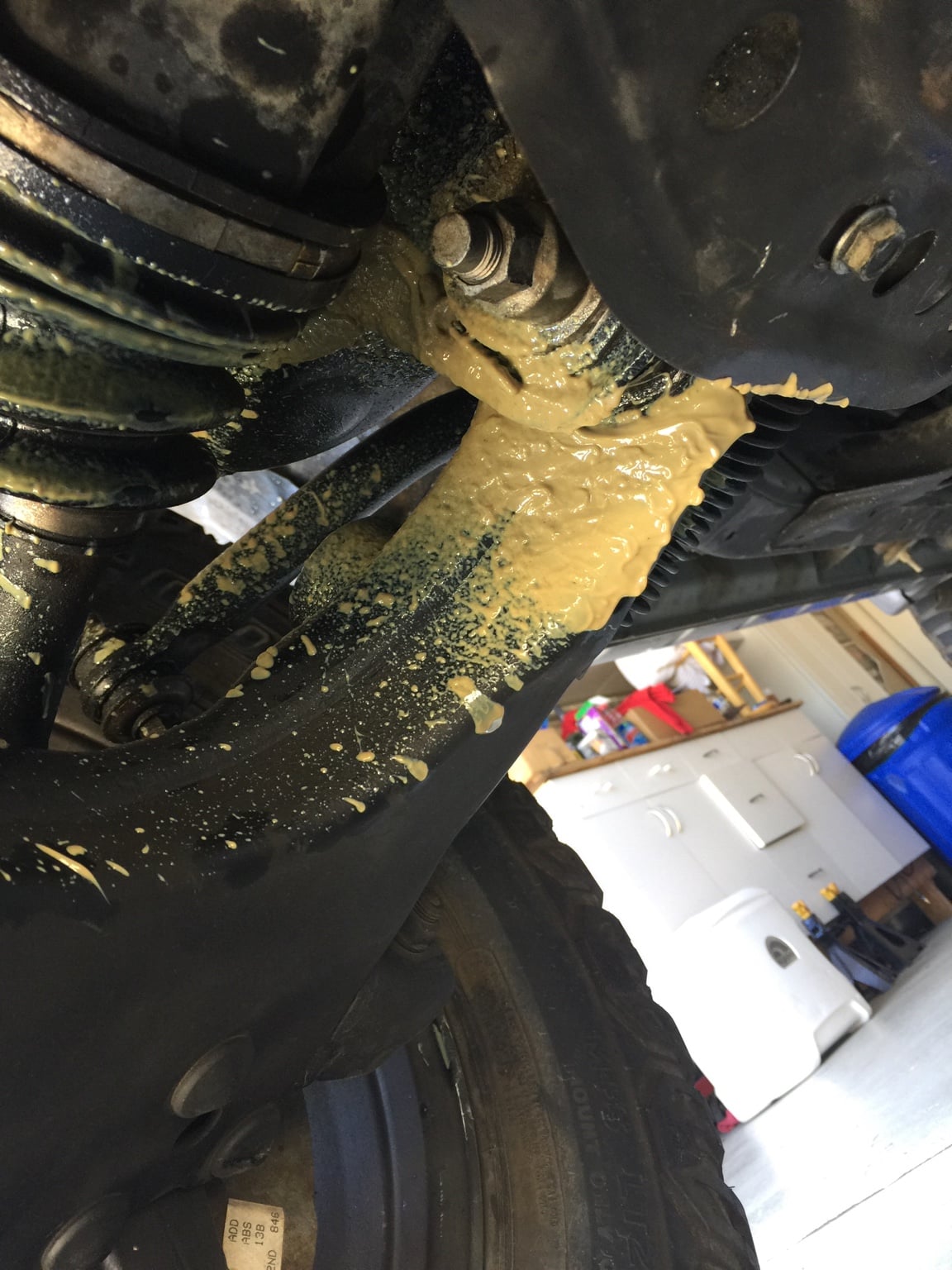

Well shit! Went to change the oil and found this...
[emoji1374] please baby Jesus, be the clamp, please please please baby Jesus.
NOPE!

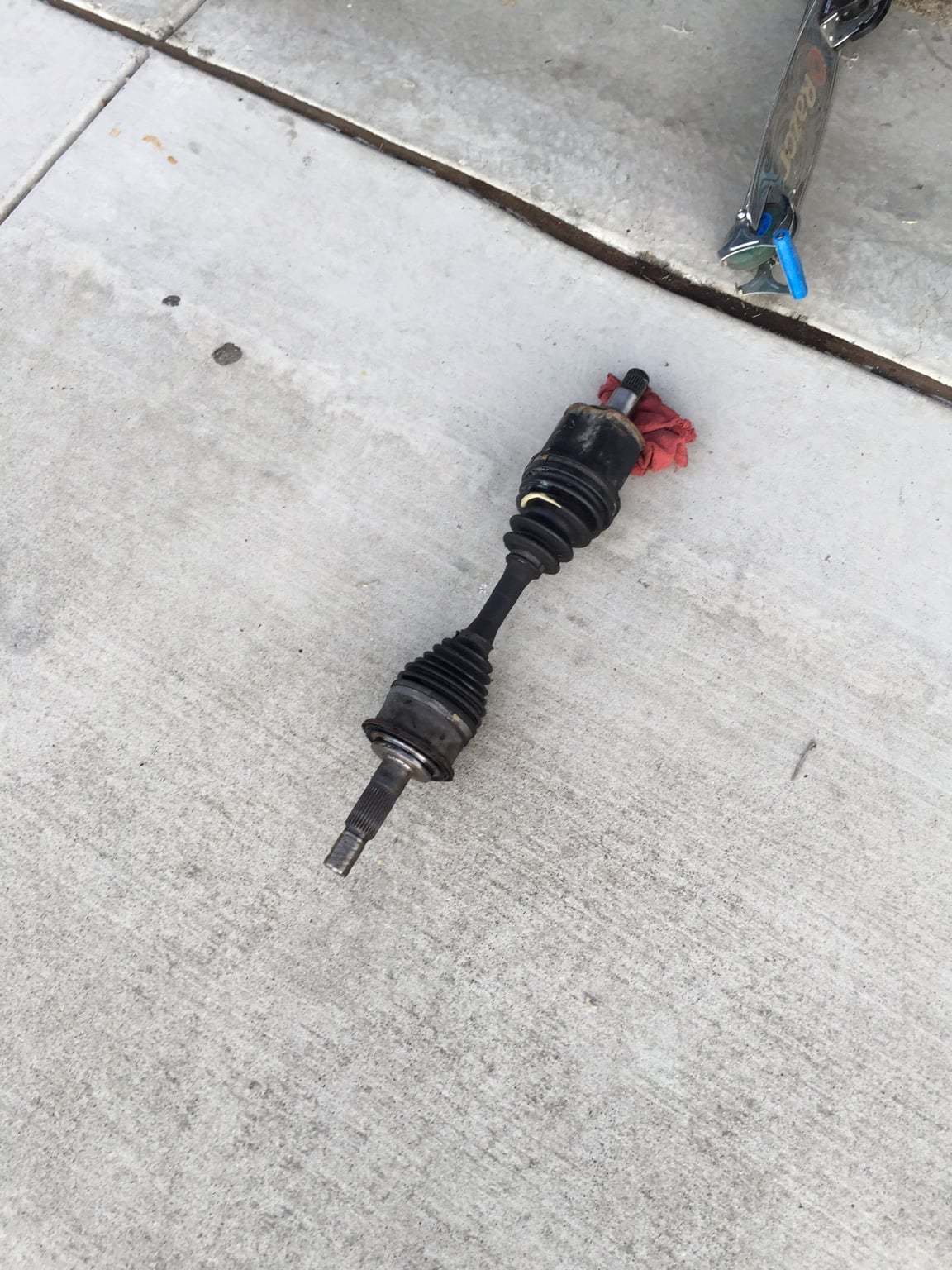

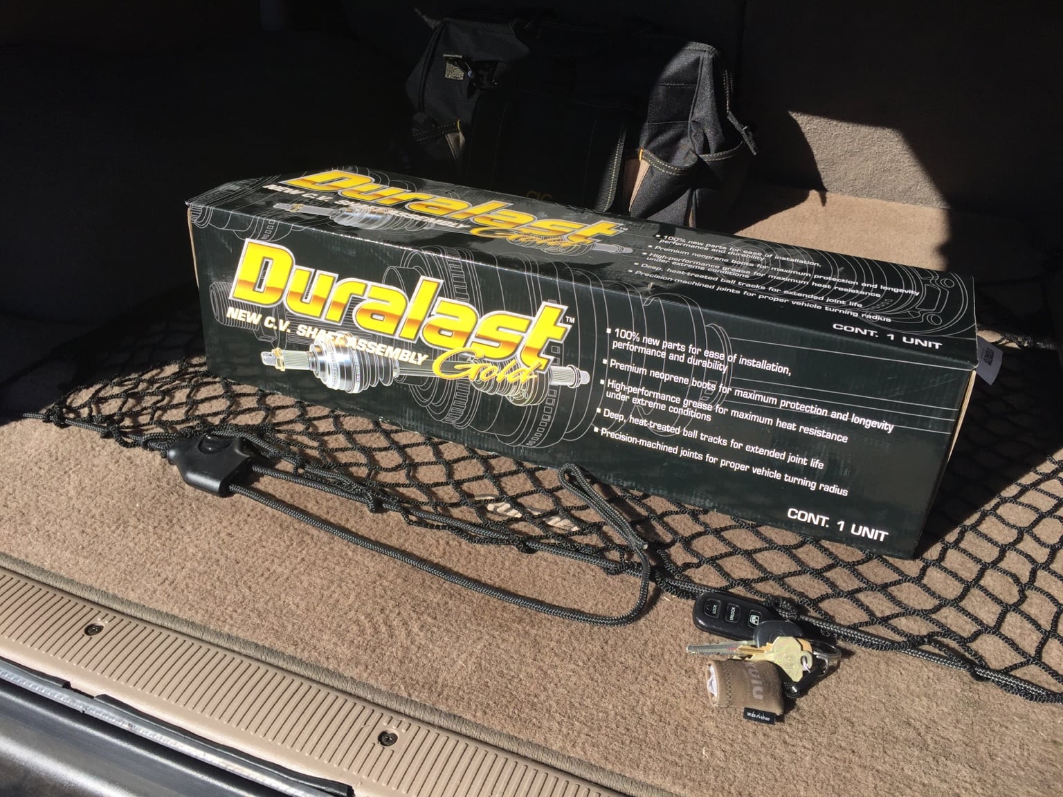

After forum searching and talking to my local guru... [MENTION=127339]4Reak Show[/MENTION]show I decided on the Autozone duralast gold. Going to do both side and keep the old ones as spares for wheeling trips.
$74.99 w/ 10% off military discount and no core charge.

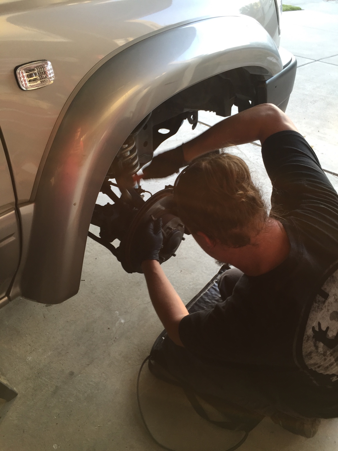

Just cleaned and oiled the k&n air filter. Waiting for 4Reak Show to arrive so we can do both my cv axles. More to follow.
This has got to be one of the easiest repairs... Right up there with tire rotation.
Pulls the wheel
Three bolts behind the caliper
Pry bar + hammer
Now reverse it
What's he doing Lōg.
side #2, same as the first.
Mad props to [MENTION=127339]4Reak Show[/MENTION]...

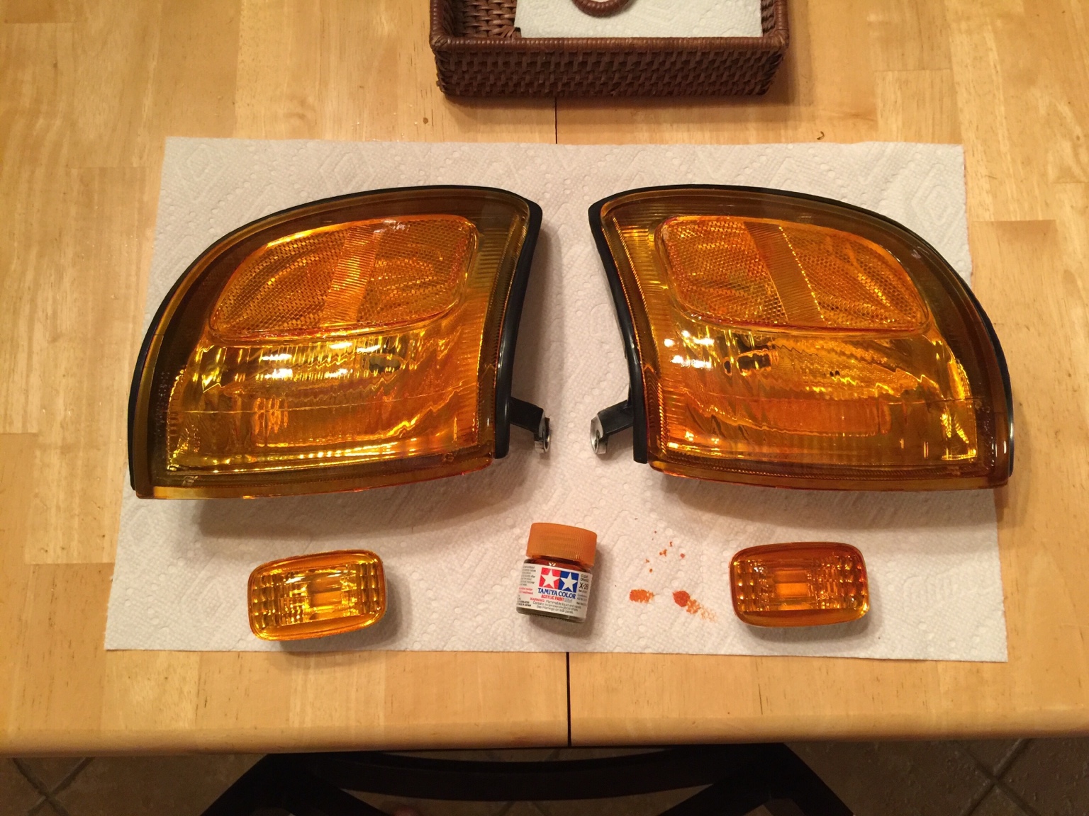

Bought some 3mil amber vinyl to do my corners... Took my time, used a heatgun and everything. Liked the look so much that I went all in...
Pulled he film and painted them.
