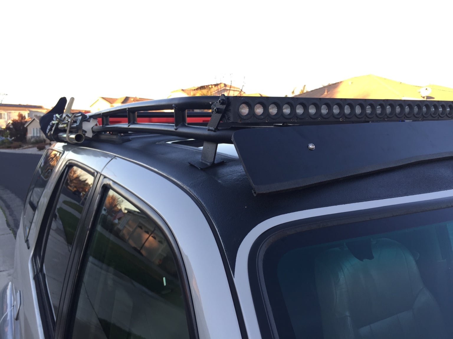

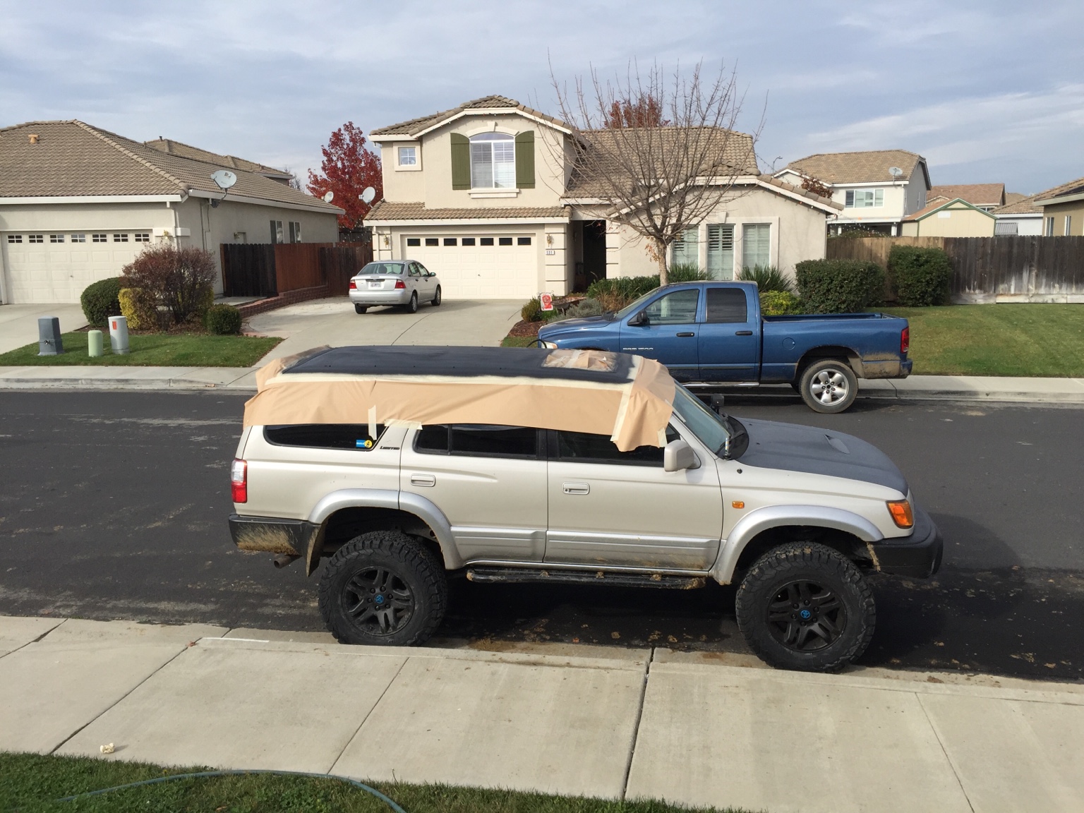

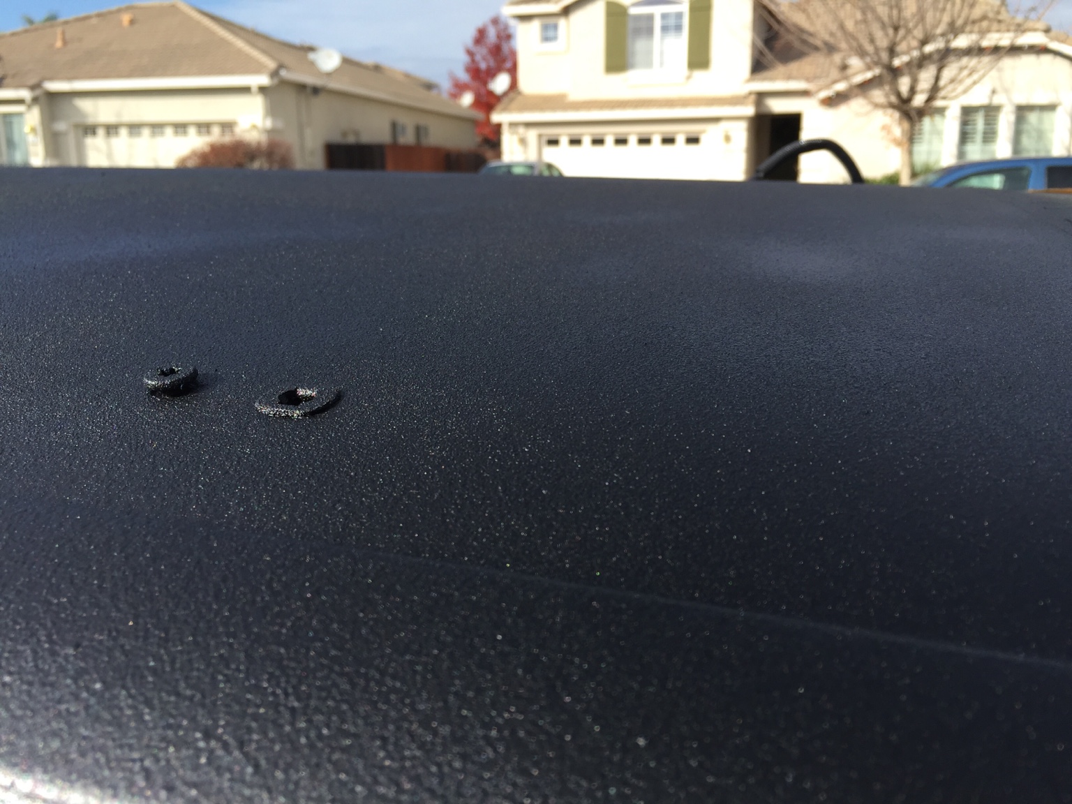

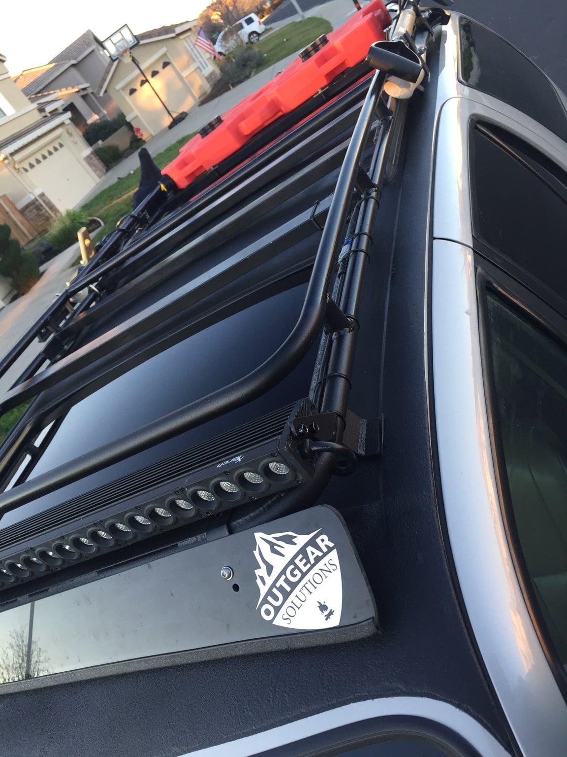

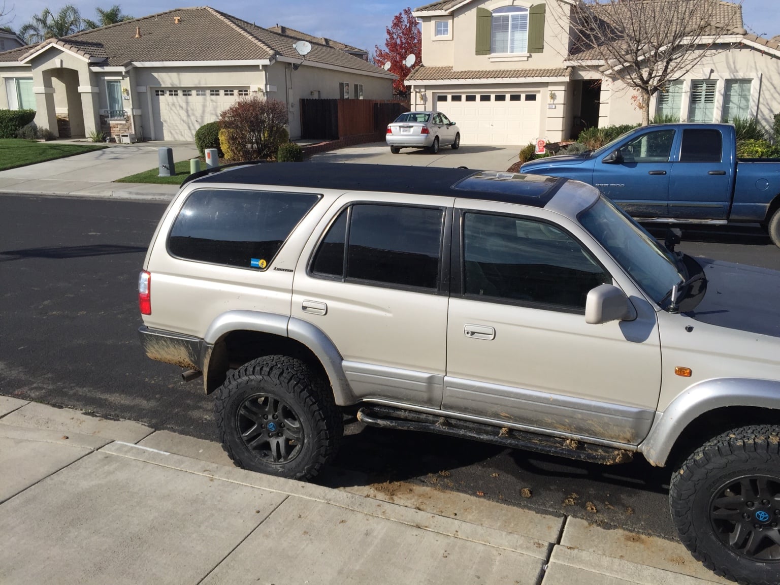

Bedlined my roof. Got tired of beating up the roof under the rack and having to mask off to the body to touch up the rack.
[MENTION=133963]GGFerrier[/MENTION] what product did you use for bedliner and how did you go about laying it on?
Thanks in advance?
That looks sweet! Did you do the sides of the sunroof or just everything behind it?
Sent from my SM-G930V using Tapatalk
Thank you. I did all they way around the sunroof. I think I'm going to go a little further towards the windshield. Not all the way to it, probably just in front of the rack wind deflector and follow the windshield top line.
Thanks in advance?
I used the dupli-color bedliner spray. I followed the directions (used a palm sander w/ 180 grit) and did three heavy coats (1 can per coat). Didn't need truck bed quality, thickness or price. Very happy with the result.
Looks great man. I have a bedlinered? (not sure if that's a word) hood and I think this would help tie it in. I'll probably follow the rack channels all the way to the windshield just behind the weather strip.

Yes, I was so pleased with the outcome I think I'll do my hood too.

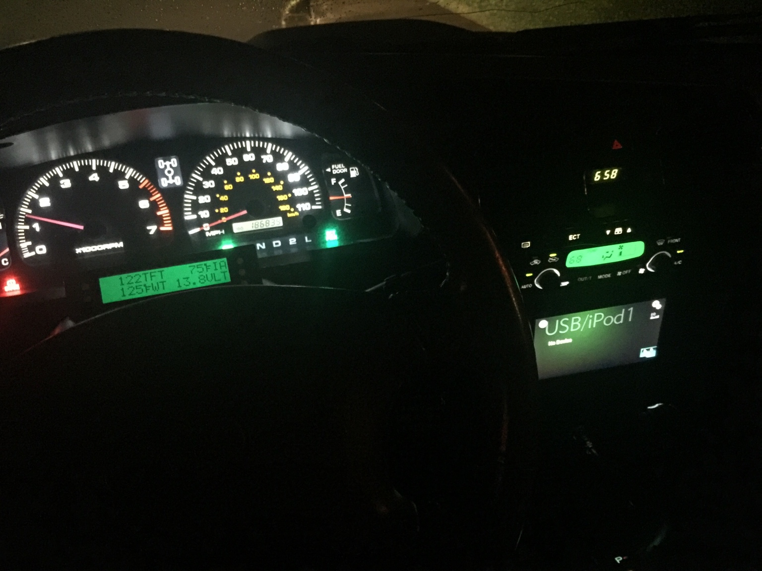

Got a package from [MENTION=107674]JRZEE2000TR4LTD[/MENTION]... I could wait, I just had to install my newly refurbished AC control as soon as it got here. Custom LED's to match my gauges. So nice to turn a knob up and it goes up. Lol
