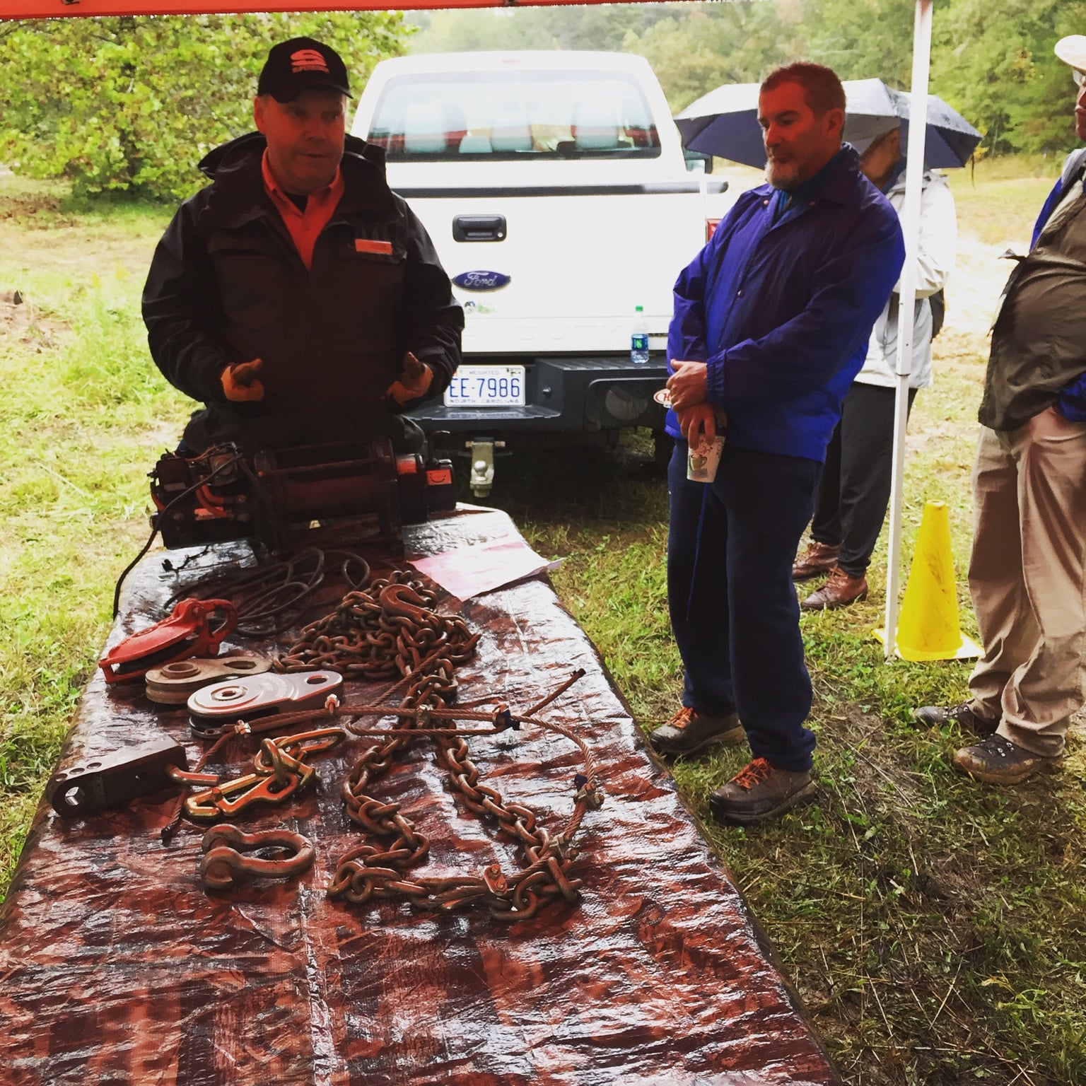

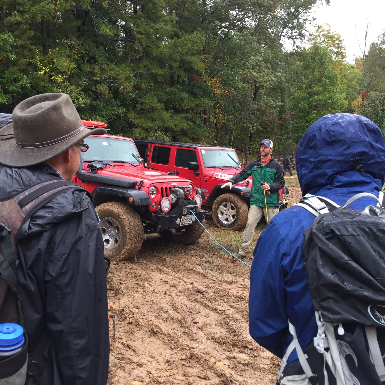

Scott Fields of Uwharrie Off-road Training Center in NC teaches his class using closed system soft shackle recovery. He will only use a metal shackle in the event a connection is on a rock. I saw Scott's presentation at Overland Expo East and they emphasize safety and situational awareness when winching. Any off angle pull is done with a block and bridle to keep the load as balanced and centered as possible.
