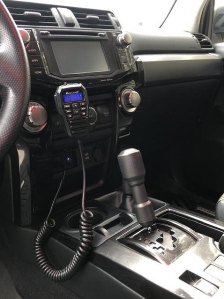

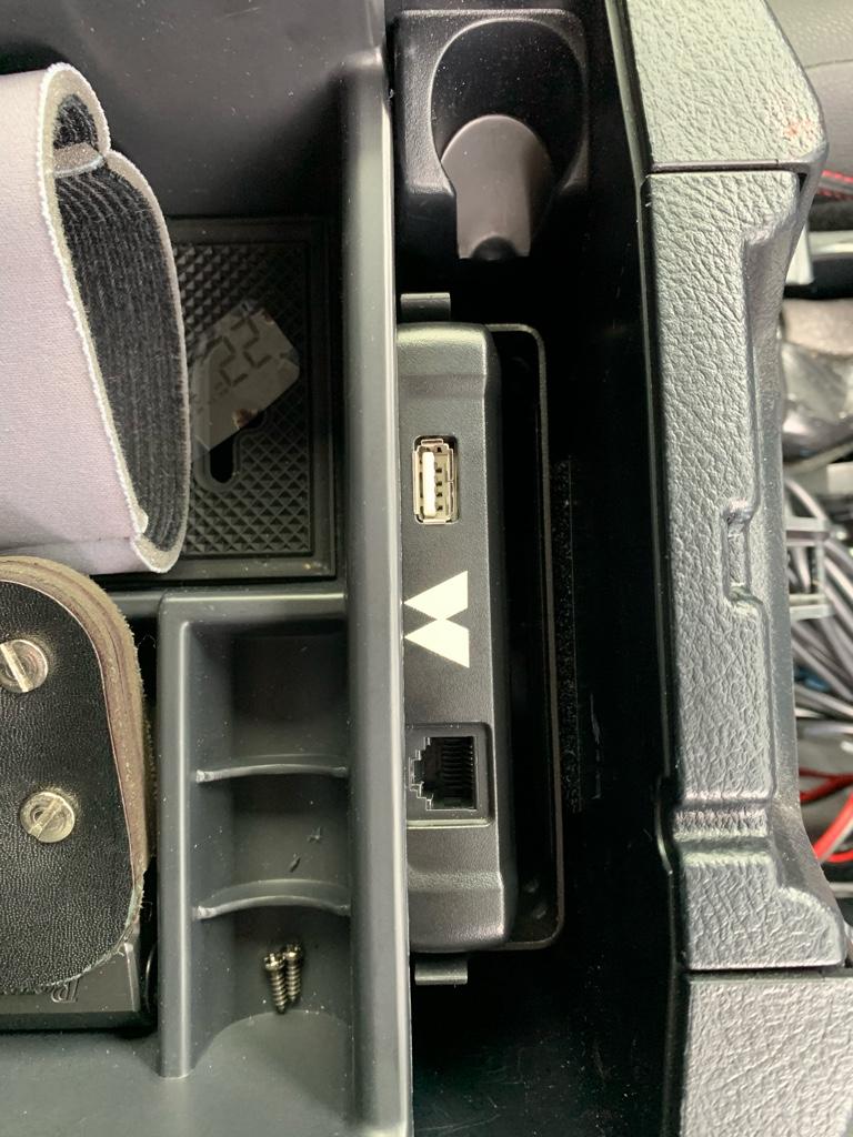

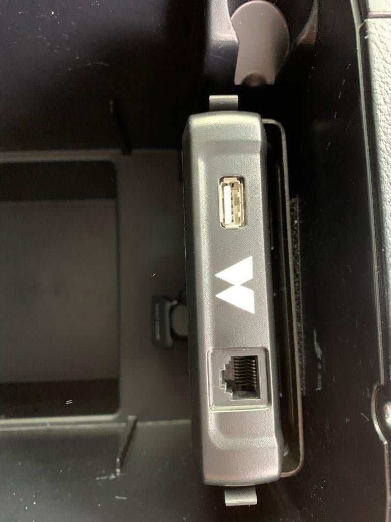

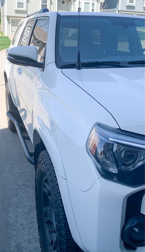

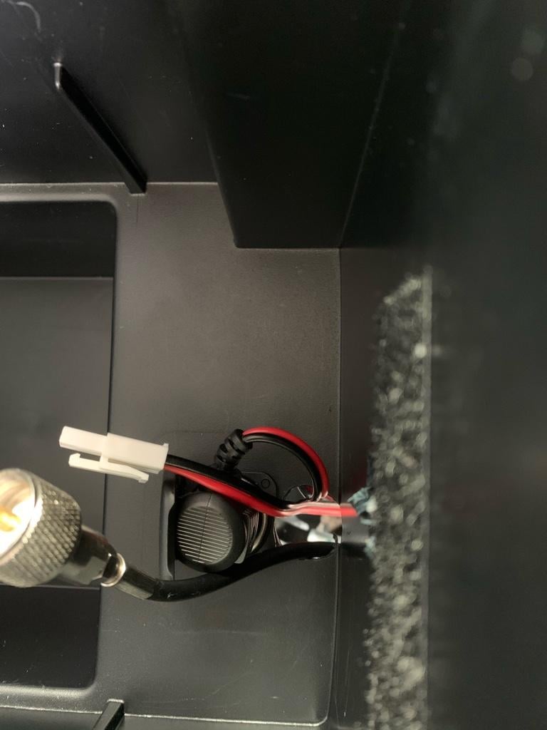

I picked up a Midland MXT275 gmrs radio and found it fits nicely in the console. I used the power outlet for power, and drilled a hole for the antenna. Works very well, made contacts at 17 and 25 miles away with the mxta26 +6db antenna
I like mine as well but never went that far for testing, good to know it works on repeaters at that range with the extended antenna.

Are you closing the center console door on the coil? does it close and stay shut?

I actually used a dremel with a cylindrical grinding bit on the lid where the mic wire comes through between lid and console. The straight part before the coil is what comes through. I just leave the mic in the front cup holder currently.

Nothing wrong with that! I agree , all controls on the mic was honestly why I chose that model [emoji106]
