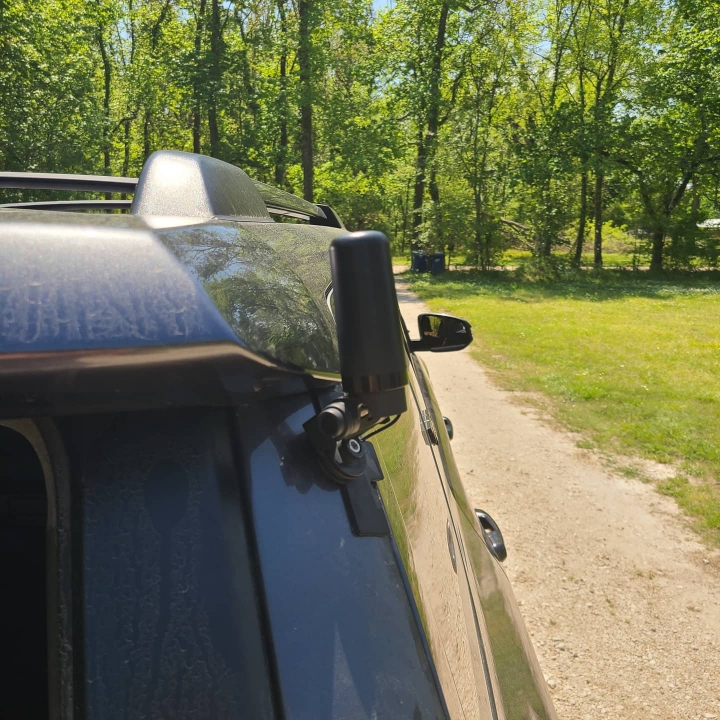

Use a low loss cable. I used a Diamond lip mount to put mine on the hatch and ran a 10ft low loss coax to get all the way up to behind the dash.
do you have the part number for that specific diamond lip mount? that actually may solve my problem...i havent been able to find the right mount for the 5th gen trail rails and i wanted my antenna up high and not on the hood.

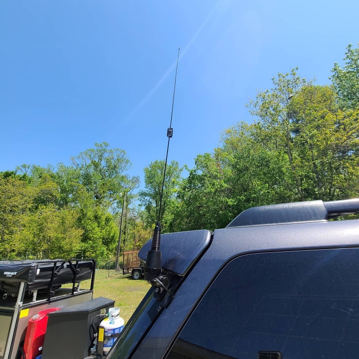

Any opinion on the ghost antenna? I might add one soon using a ditch light bracket
If you're just using it for comms within a group offroad or on an open highway, it's plenty good.
I'm seeing about 60% of the distance capability of the longer whip antenna out of it. I have yet to try either on a repeater system yet.
Using it over mixed terrain, my wife and I could still communicate from 2-3mi straight line distance, me driving & using the MXT275 and her using a handheld Midland walkie from our yard. There were alot of trees and a few houses between us, but no more than a 20ft change in elevation (no real hills in S Louisiana). I was coming in clear for her, she was broken but able to understand her meaning.

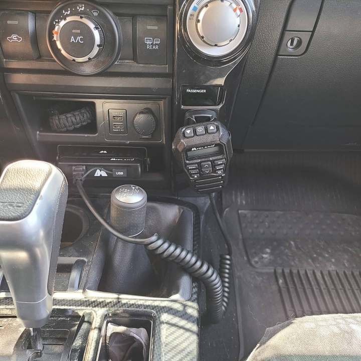

How did you get the bracket mounted in the cubby? Did you pull the center console and drill a hole in the back to runthe wires? Any links would be appreciated or pictures.
That's exactly what I did. While I had everything apart
-I ran the power to the cigarette lighter plug in the center console,
-routed the antenna wire down the passenger side then behind the kick panel to the back of the dash,
-drilled a hole in the back of the cubby and attached the quick release mount to the cubby top,
- hooked it up, slid the cubby back in place, then reassembled the rest of the console
Don't have pictures or a write up, I get busy doing and forget to document. [emoji1]
