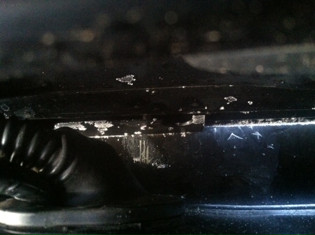

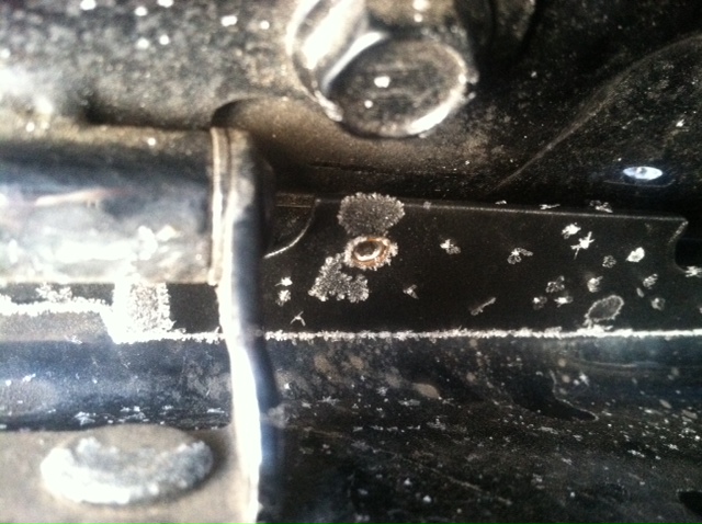

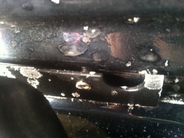

So here the re-vised Gobi Ladder plate...
See the attached images:

***update on ladder plate***
For those of you just joining us... there has been issues with "rubbing" and contact with the GOBI ladder installed. We found the solution then added a problem. Those who have the ladder installed where finding that the additional weight of the ladder was too much for the stock OME gas struts that opened the rear hatch. So Paul at Gobi Racks found some "Heavier Duty" struts and installed them. Problem was that these new struts opened the rear hatch higher than the stock OME gas struts did. Therefore the plate now made contact with the top of the truck. Long story short was Paul needed to re-design a plate that would accommodate the new struts and no longer cause any rubbing issues. Paul has done that and it should be done by next Friday. Follow this thread to stay updated :)
