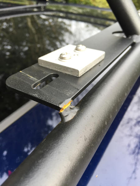

OK, here's a couple tips I've learned from installing two Gobi Racks...
Sealing the threads. I used marine silicone around the mounting bolts, under the mounts, between each layer of rubber and steel. Not so much as to squish out and look funky, but close enough to the bolts to seal the threads.

Overall the install is simple and I love the rack for carrying extra stuff. My first one suffered a cracked weld on the light/deflector mounting plate after two months. I noticed rust on the roof washing the runner and discovered the issue. I removed the deflector and emailed Gobi a photograph of the weld. Looks like the flat bar was tweaked thus causing extra strain on the weld. Gobi sent a new rack to replace it. No issues, no hassles. It took about the same time as the original order, but so what? I just rocked the no deflector look for a couple months. Nice people to deal with, but perhaps overworked. Communication isn't their strong suit, but when you do catch them they are helpful. They do make a nice product, just wish they made it out of aluminum...
