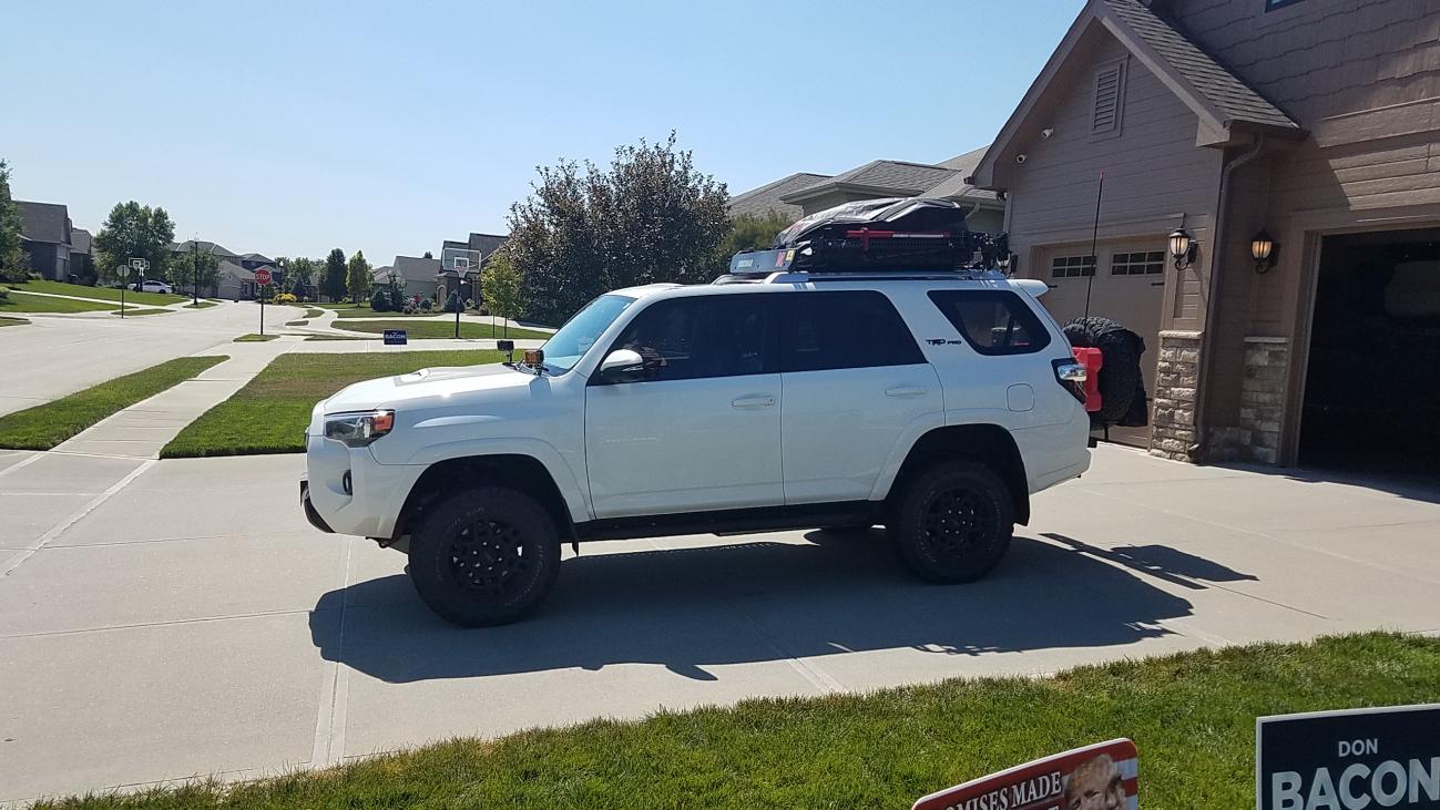

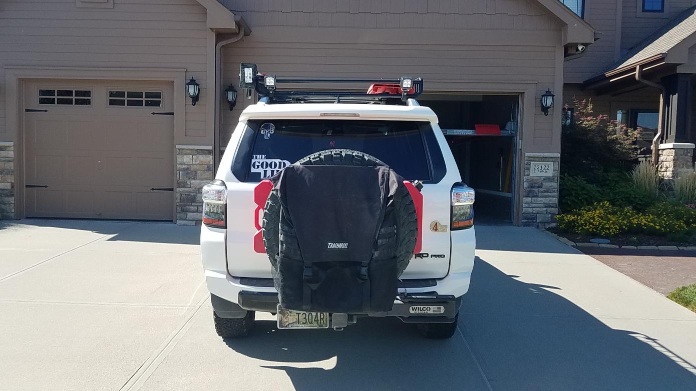

Once I get my Gobi rack...I'll post pics once done. Currently have a yakima basket on factory cross bars.
