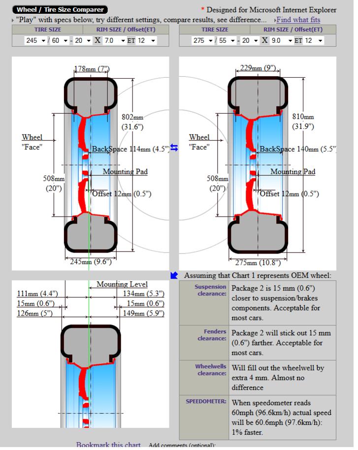

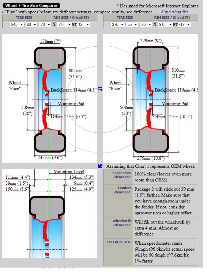

Go back to that rim calculator a couple pages back and set the ET on 0. Then try +12 and -12 and see where the center of the wheel moves to in the graphic.
Unless I'm reading it wrong, the +12 offset/5.5" backspace basically "centers" the new wheel like the OEM, while the -12 offset/4.5" backspace pushes it out, away from the center of the truck.
Yes since the +12 offset is matched to stock, the center is the same. Also, since the wheel is wider, with the +12 offset more of it will fill in the wheel well since now the backspace is roughly 1" greater than stock.
You're running a 7" rim on the left and a 9" rim on the right. It might become more clear if you use the same size wheel on both sides. My calculation still comes out with +12 = 5", -12 equals 4". Of course I am assuming a 4.5" starting center since Black Rhino doesn't state what that was. It might not hurt to contact Black Rhino directly to get that information.

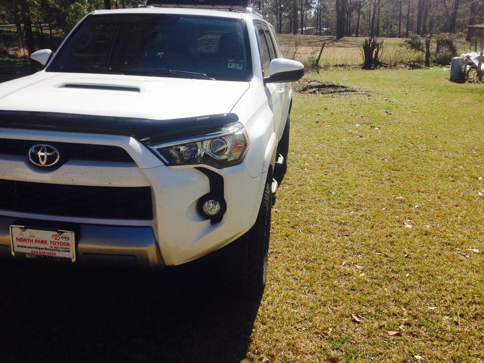

I did the method racing standards which are identical to the nv's in terms of specs plus the 285/70/17 duratracs. I had an alignment done (light racing uca's) and the tires rubbed the front bumper so that needed to be trimmed. I had already pushed the inner liner forward in advance so I would imagine that will be needed as well. The body mount would have rubbed in an off road situation but was ok for normal everyday driving. Naturally, the front mudflaps will need to be removed as well.
The above info was with a daystar 2.5/1.5 lift. Gonna be switching it out very soon.

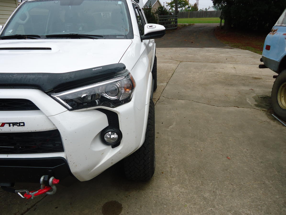

Where did it rub on the bumper? All good in the rear? Perhaps I'm better off with a 275. As of now, I'm only looking to raise my front end enough to level the truck and leave the rear stock.
I have no issues with rubbing in the rear but with the lift being "spacers" I can feel the coil binding and also the shock doesn't have enough travel. So, that is the main reason I am changing things out.
If you look in front of the wheel you will see where the colored section of the bumper curves down and sticks out a bit more. If you look at this piece it looks as though Toyota cut a notch out of the bumper on the far inside of the bumper. Right where they allowed it to bow back out and come back up is where the tires were rubbing.
I'm not near the 4runner or I would grab you a pic.

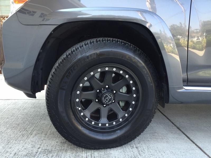

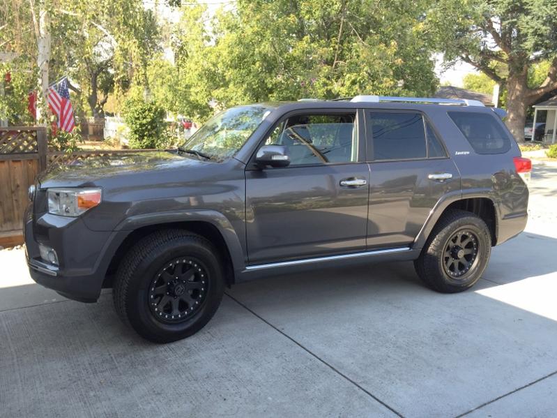

I've decided to go with new wheels and tires with my 2012 Limited and have settled on 20" Black Rhino Imperials with Michelin LTX A/T 2s in 275/55/20.
America's Tire lists two options: 20 X9 6-139.70 12 BKMTXX and 20 X9 6-139.70 -12 BKMTXX. The only apparent difference is the offset (+12 vs. -12). Using the tools on this thread, I figured that the +12 would have 5.5" backspace, while the -12 would have 4.5" of backspace, which is what the stock 20x7 wheels have. I'm leaning towards going with the -12 since it will keep the wheel clear of the suspension, but I'm not sure whether that will prevent rubbing since the tires will stick about 1.5" vs. .6" with the +12 offset. Also, Custom rims, wheel tire packages for your ride - RIMSnTIRES.com recommends only the +12 offset and 5.5" backspace, adding to my confusion. Any help would be appreciated.
UPDATE: Both Black Rhino and America's Tire said go with the +12mm offset with stock suspension. I ended up going with 18x9s instead of 20x9s, with Michelin LTX A/T 2s in 275/65/20. No rubbing, just enough clearance on the front of the well at full lock.
