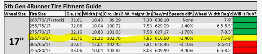

So help me out a little here... if I am reading the guide right... I can't fit 285x70x17"s BFG K02 Mud Terrains on my TRDPRO rims... I am also adding the TRDPRO Toytec lift...

You can fit those tires on those rims with that lift. But you may need to trim the edge of the bumper and remove the mudflap. See my post in #313

Pretty sure he is talking about rim width. Tire mfgs don't recommend that size on a 7" rim. He can of course mount them but will get no warranty and he assumes liability.
Sorry, I thought the TRD wheels were 7.5".
Well, I just looked and they are 7" and now in my mind, those wheels suck.
I am of the school that you need new wheels.
I figured the Trail got a 7.5" wheel then so should the TRDPro.

This is my concern... but I have seen guys with 285's on the TRDPro wheels but they weren't the BFG Mud Terrain K02's.. but I don't want to buy new wheels.

I was looking at the BFG charts just now. I would say go get the 275/70R17. It actually cheaper too.
I know guys that run widths beyond the mfg. recommendations and they are fine with it. I tried it on my 305s on 7.5" wheels instead of 8". It lasted about a week for me. I did not like it and bought new rims. Others don't mind it. To me the tire felt high in the center. Maybe I am just the Princess and the Pea. But it bothered me.
