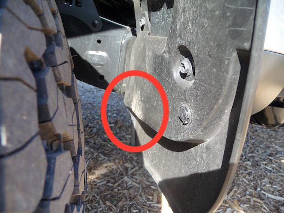

275's May Still Rub
Installed 275 70 17 on FN CounterSteer X with 4.1 back space. Some tire contact on the mud guards bump-out. Suspect this is caused by the difference in back space from stock wheels. (Caster is +4°)
Installed 275 70 17 on KN CounterSteer X with 4.1 back space. Some tire contact on the mud guards bump-out. Suspect this is caused by the difference in back space from stock wheels. (Caster is +4°)
What is the wheel width and backspacing on those wheels if you don't mind me asking?
The KM2s tend to rub more than similar size tires of other brands... Should be able to resolve the BM rub (without a chop) via an alignment if you have aftermarket UCAs.... (assuming a 285/70/17)
ya know - I've aligned that thing probably 3-4 times trying to get it to feel right. Pretty close, but no luck on keeping the rub out. I have the LCR UCAs at the 4 degree setting - should I put it back to neutral (2 degree)? From what i understood you wanted to push it forward as much as possible to keep it from rubbing the BMs - any thoughts?

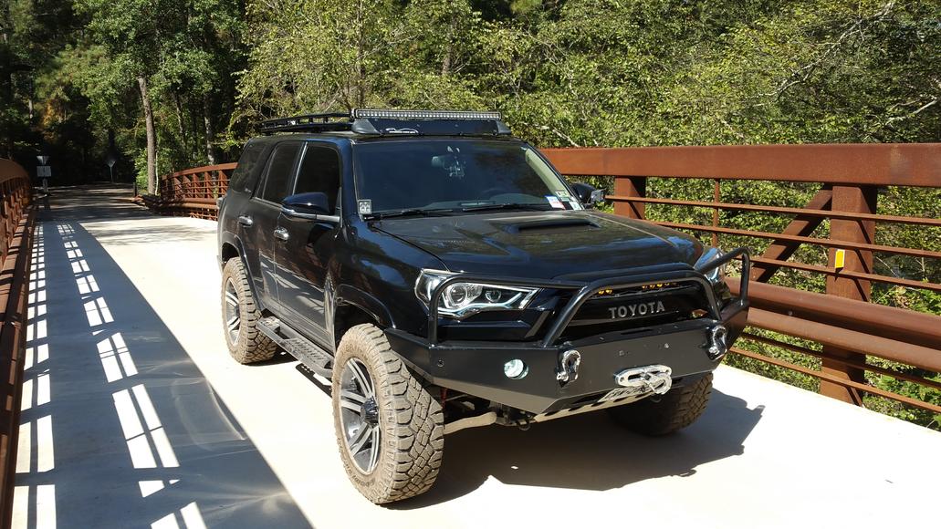

I run 275/65 - 20 DuraTacs. But I have done BMC, 3 inch lift and am running SpiderTraxx spacers.
