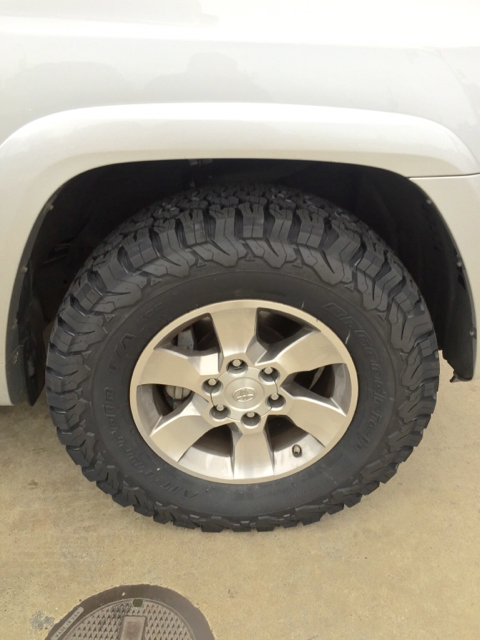

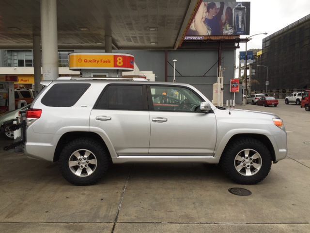

Hate to write up the typical freaking new guy post but after reading 20 pages of tire info I couldn't find an answer. I have a 2012 SR5 with the stock wheels and stock suspension which I don't plan on changing anytime soon. Will a 275/70-17 BFG KO2 setup rub? From all the data gathered on this thread it would seem that there is a possibility it would. Thanks for the help

It might but probably not. K02 usually run a tad small. If it does rub it would be minimal and easily fixed either with fender liner moved slightly or mud flap slightly trimmed. If you don't want to ever rub then buy stock size and run stock wheel. Otherwise, go bigger and make any mods necessary.

See if they will just put one on front and take a look at it?? probably the only way to know for sure.

I am currently running the older style BFG in a 275/65 18, I have had them since I bought my runner. With stock suspension I had no rub except on the drivers side front in revers on rafe occasion against the front plastic. As stated a lot of factors play into that but I would say any rubbing would be pretty minimal from my experience.

Ok thanks all. Decided to pull the trigger on Friday. Will report back.
Confirming that BFG AT KO2 275/70-17s do not run at all on sr5 wheels on stock suspension
