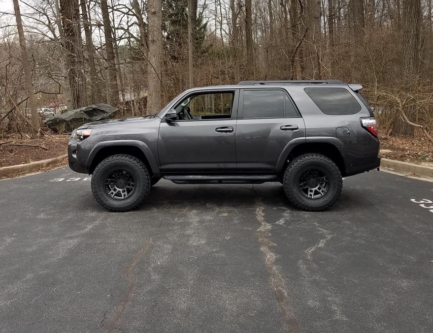

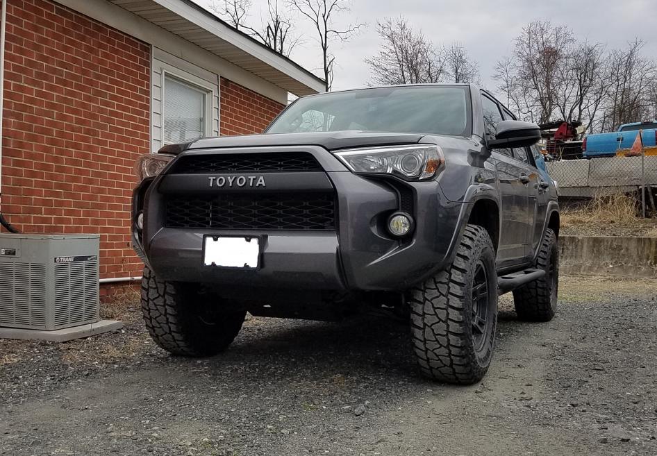

Installed 1.25 Spidertrax spacers on my 17x8.5 -10 VTX Rogues. So basically running 17x8.5 -42 now. Still running 285/70/17 KO2s.
Without the spacers, all I needed to do was trim the front bumper a little and relocate the fender liner. After installing, it looks like I'll need to cut some more off the bumper, move the fender liner forward a little more, remove the mud flaps and get a BMC.
When turning normally, the tires barelyyyy clear the body mounts, but the rub marks indicate that it must be hitting under certain load.
