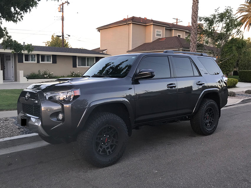

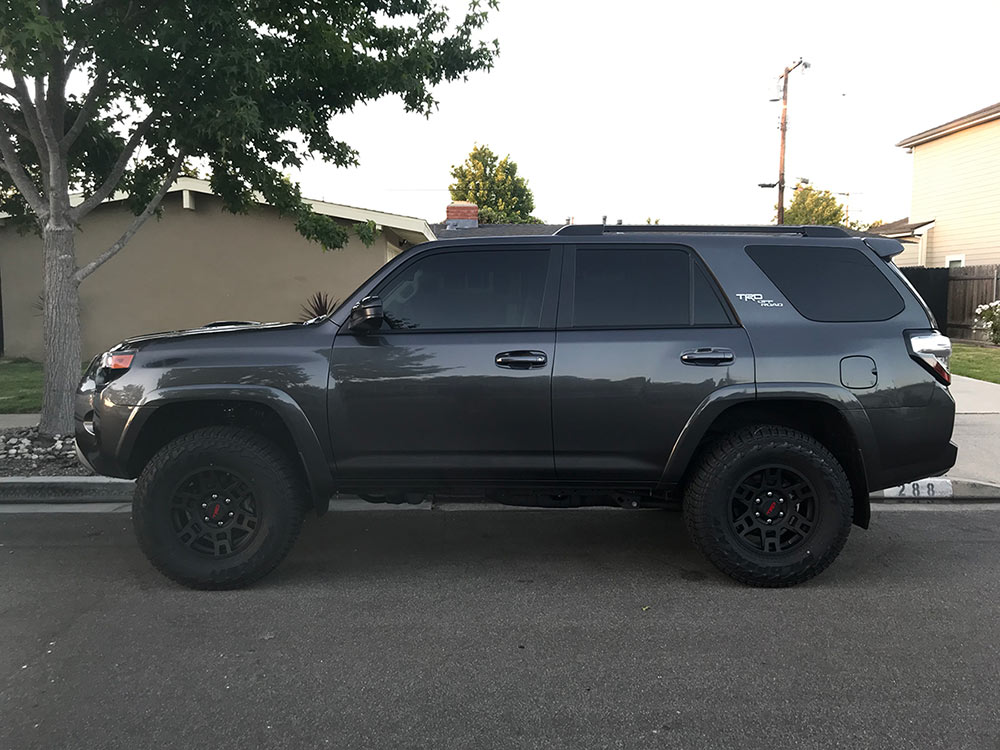

Hey everyone, I'm new to all the suspension stuff but wanted to offer my recent experience as well as ask a couple questions and see if anyone can help.
I went to upgrade my wheels and tires on my 2019 TRD Off Road and stupidly got talked into doing a spacer leveling kit and 285/70/17 Falken AT3's. I shouldn't say stupidly because the truck looks awesome. Not only that but there is ZERO rubbing at all, not at full lockout forward or reverse or otherwise. The guys said that 50% of the time its like that and 50% of the time they have to do some cutting. I'm wondering if it has something to do with it being a 2019 and that its a TRD Off Road.
My problem comes in 2 places, which are my questions. First, the truck is much more sluggish than I expected (again a newbie) and secondly I am worried about off-road performance from putting a cut rate lift solution on. So at this point I am considering picking up new upper control arms and a proper lift so there's no issues off road. It's either that or drop back down to smaller tires and pull the spacer off.
Would be awesome to hear anyones thoughts or experiences with this type of setup. Attaching some pics so you can see how it looks with this setup.

Couple things. You need more lift in the back to fix the negative rake. Otherwise I think it looks great. For mild off road use, which is what 95% of us do, spacers are fine. If you plan to run Moab, spacers are not fine. As for sluggish, that's what happens. Heavy tires take more power to turn, have much more rolling resistance, and there for you feel like the truck is slower because it is. Your gas mileage will also suffer, likely quite a bit. Only way to fix that is to regear which comes at a hefty price tag, likely in the $3000 range.

Thanks tons for the info, super helpful. Might have to size the tires back down a bit at some point then but mostly concerned with the off-road part. So good to hear the spacers are okay for mild off-road as thats all I'll be doing for now. Also, will the negative rake help performance or is that purely aesthetic and is there any reason to upgrade the upper control arm or should I just wait until I get a proper suspension lift all the way around?

Negative rake may actually hurt performance. Part of the factory positive rake is aerodynamics. Gas mileage is going to suffer no matter what, but IMO I like to try and keep close to factory rake. Even with smaller tires, your fuel economy and performance will suffer. Only way to help that is gears or pure all out street tires. For uppers, stock is fine up until about 2.5" of lift. Once you hit the 3" mark they are really not optional otherwise your alignment will be way out of spec.
