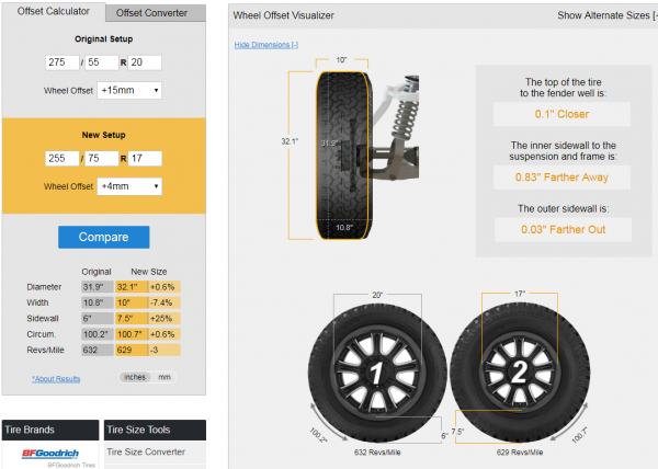

I have been looking and cannot find an answer to my question. Will 255/75R17 on TRD Pro Rims (+4mm offset) rub on my 18 Limited with mud flaps? I see that other people are running 275/55R20 on stock rims +15mm offset and have no rubbing issues. As you can see they are very close according to this offset calculator.

So I am currently running 255/75R17 on the 7" wide TRD pro rims and no rubbing. I specifically have Firestone Winterforce in that size. but before you think I have solved all your problems I have an (otherwise stock) TRD Off Road, not sure if it would play out the same for a limited.
