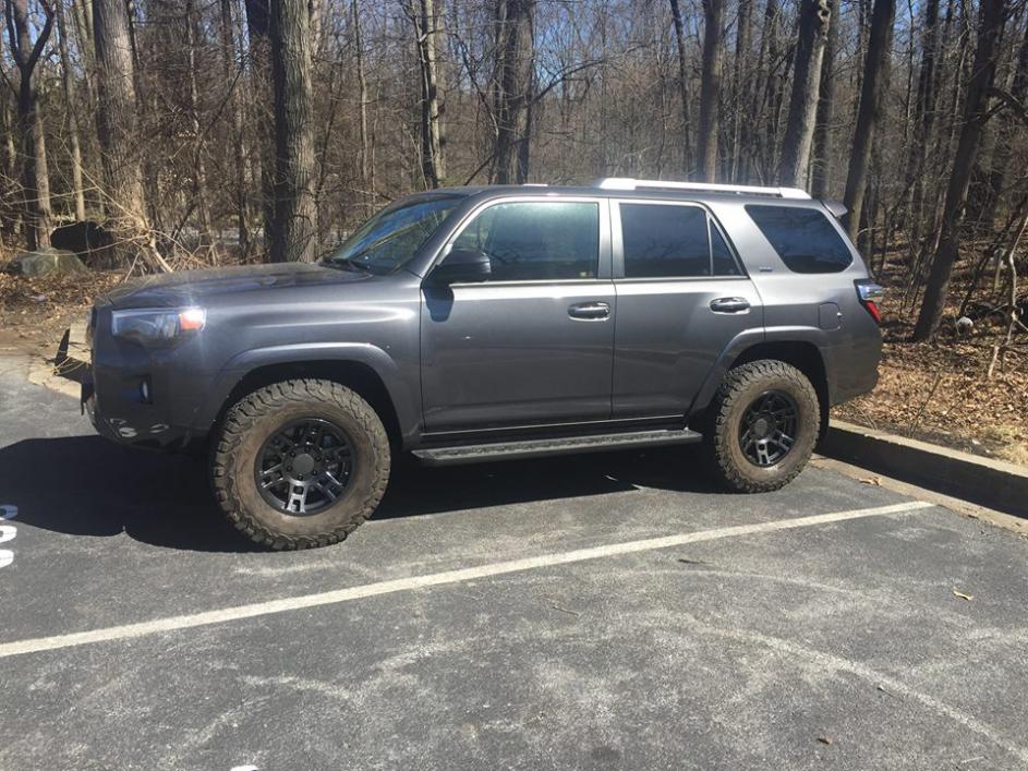

Here's a shot of my '19 TRD ORP with Falken Wildpeak AT/3Ws in 275/70R16 275/70R17. I did have some slight rubbing on the mud flaps and still do on the front fender liner. Replaced the mudflaps with a set that don't have the big hump in them and will be doing the fender liner mode to move it forward a bit.

Did you mean 275/70/17?

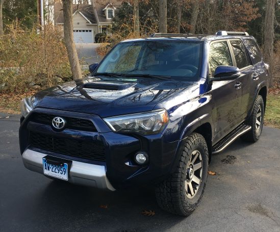

What wheels are you running? There is no reason to ever have to do a BMC if you select the right wheels. I was running 285/70/17 completely stock, no lift, no BMC needed. All I did is the fender liner mod which you will have to do either way.

Looks great! Do your fronts not eat the fenders at full compression though? It looks tight.
