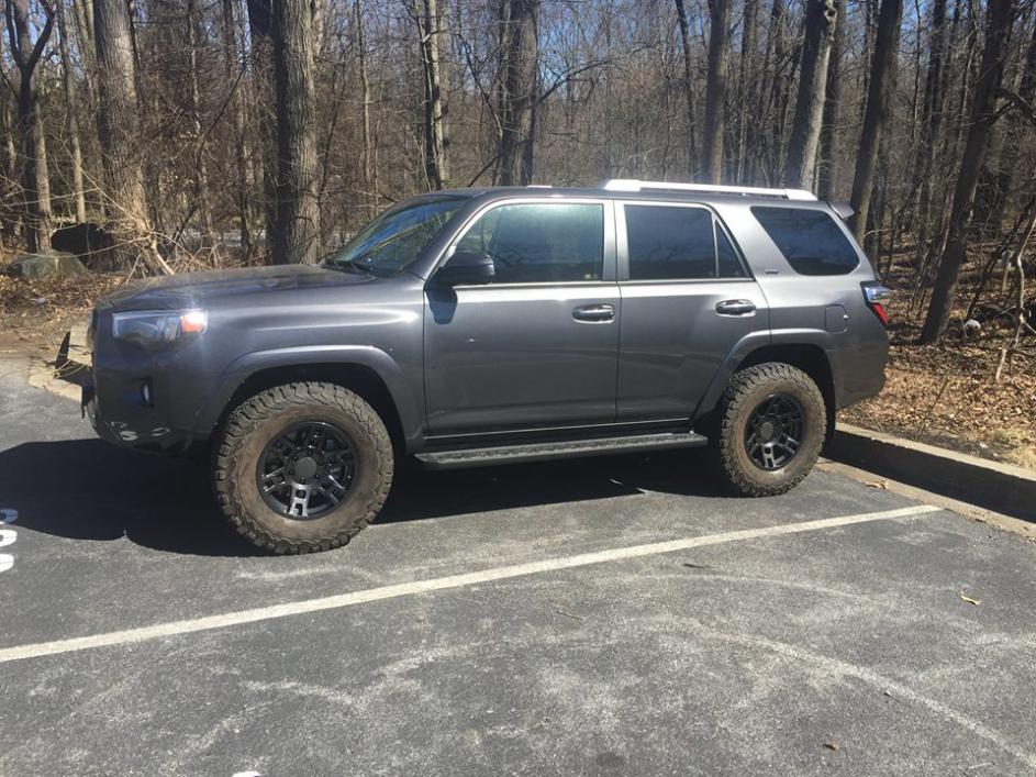

It rubs on the street. Zero chance of you being able to take it off road. You'll literally rub everything. You'll likely end up with damaged fenders and sliced tires.

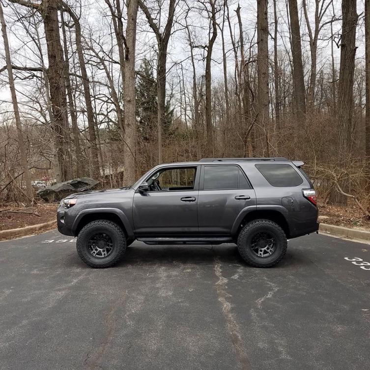

I run a 295/70/17 on 2.5 front 2” rear and no BMC with no rubbing. It’s all about choosing the proper wheels.
